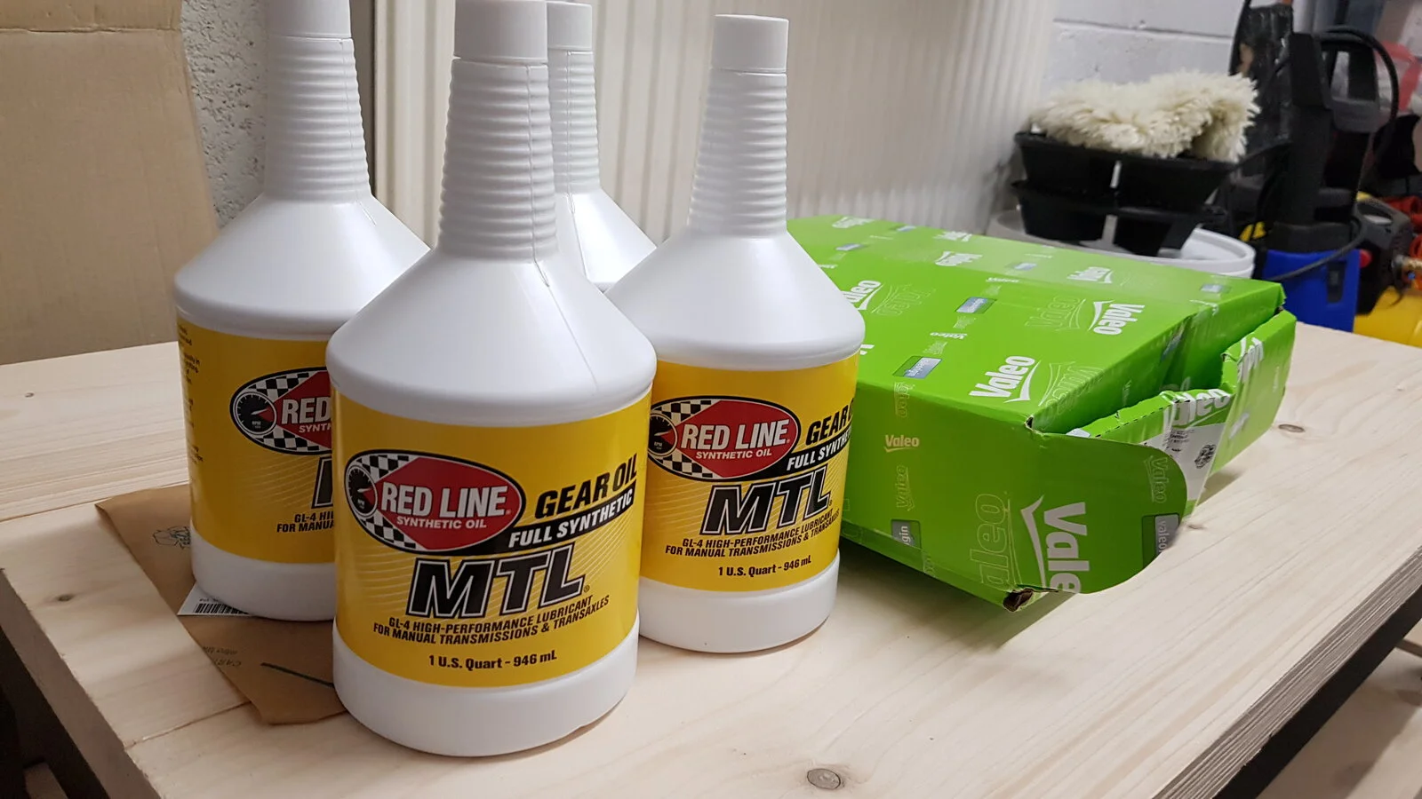

Use the code MID60 on GSF, comes in at £73 for the premium option. Pretty sure that’ll be Valeo, could always call your local branch to check first.

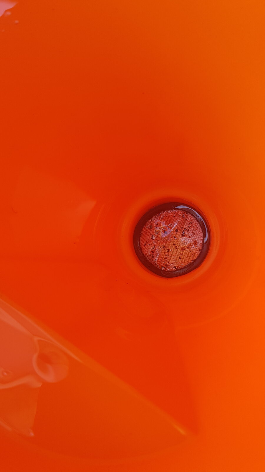

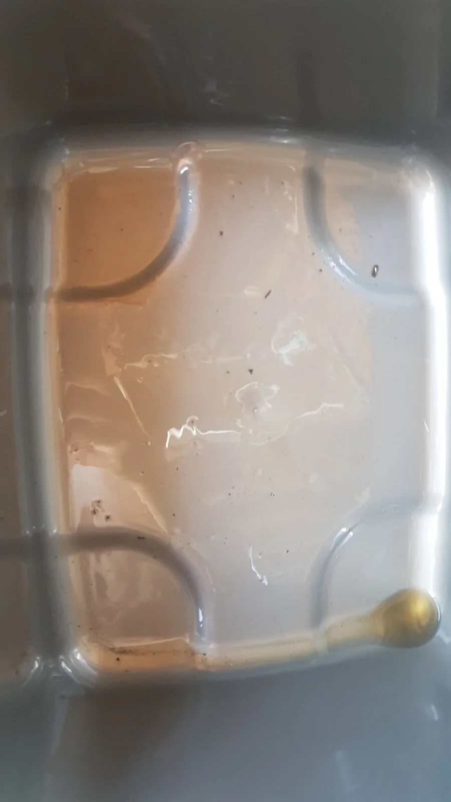

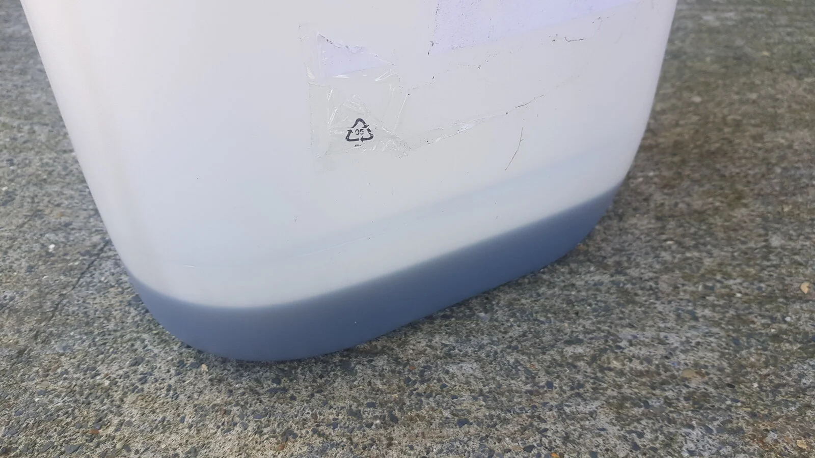

Just filtered the oil into a container and it's just full of black specs. Nothing metallic from what I can see though.
