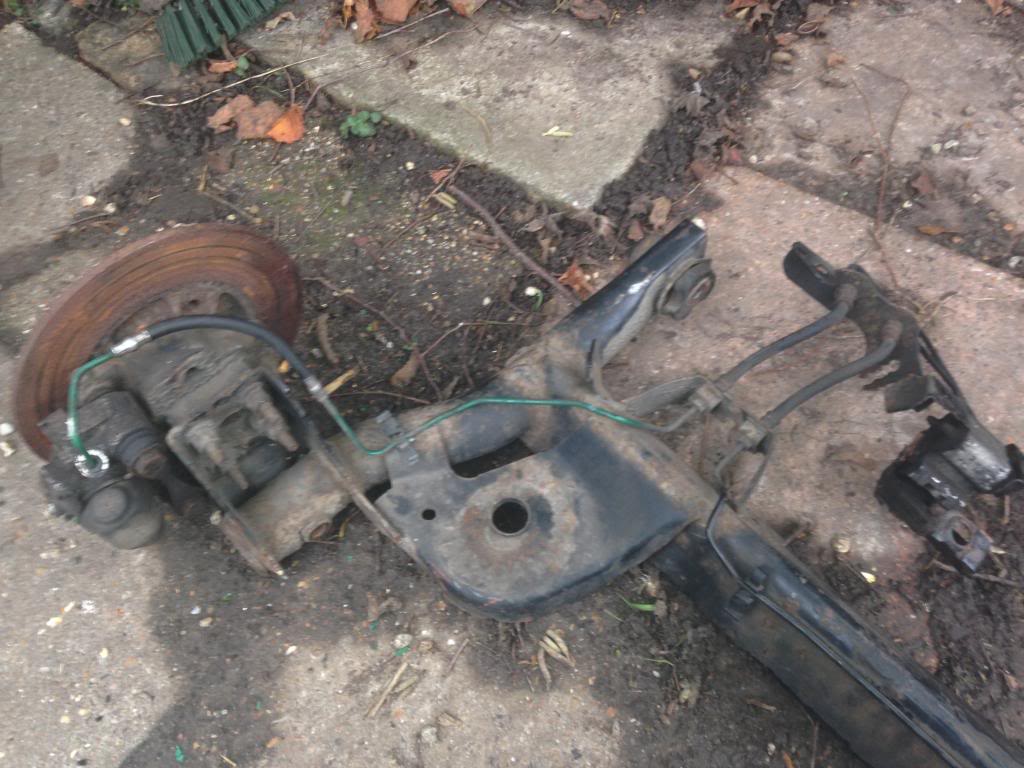

ive got a clio 172 cup rear axle complete with disks and calipers

do you have the brake lines (the hard pipes) for the rear axle?
that would be a yes then!!
yeah 172/182 kit will do it, shop around though as they can be had new for under £50
