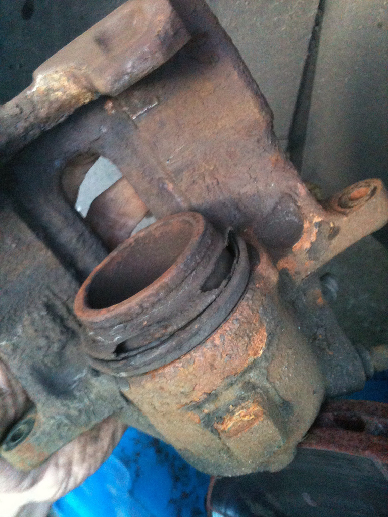

Think I found the problem!
What do you guys reckon, new caliper? Refurb?
  DON'T SEND ME PM'S!!
have you had that on fire on a track day? Easy option is a new/refurbed caliper. That one is pretty shot by the looks of it
It's lived on a track for 90% of it's entire life! Can it be refurbed then or is that a silly question and new caliper time?
for the time and cost, I would replace. Anything can be repaired usually, but that doesn't look worth it
Haha thought so. Cheers all :approve:

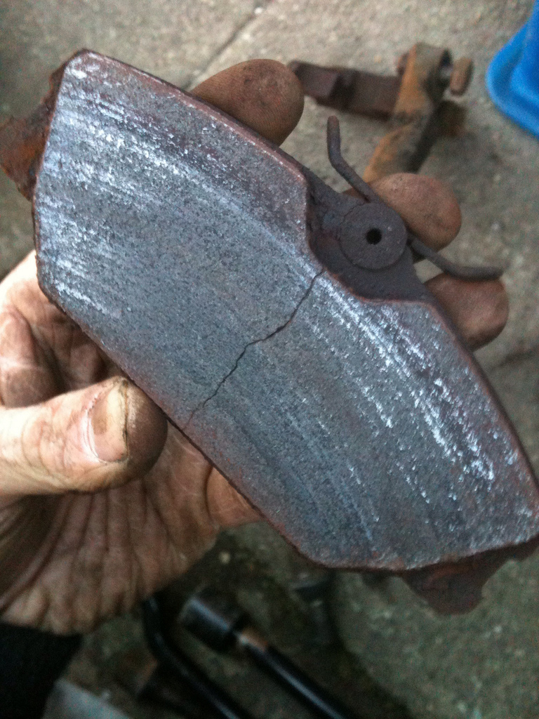

It's caused this to happen to the pads too:
How urgently do they need replacing?
Poopensharten
  Golf R
I'd do it straight away if it's a daily mate, you really don't want that to fail on you at a crucial moment!
  Black Sheep
I would get those pads done asap. For the caliper get one of renparts. When my rear one went instead of messing around I replaced it for £30. Don't know what a front would be,
  Black Sheep
I had total brake failure when my pads fell out and the fluid pissed out the piston. I was very lucky I never had a big crash. Don't take the chance mate.
