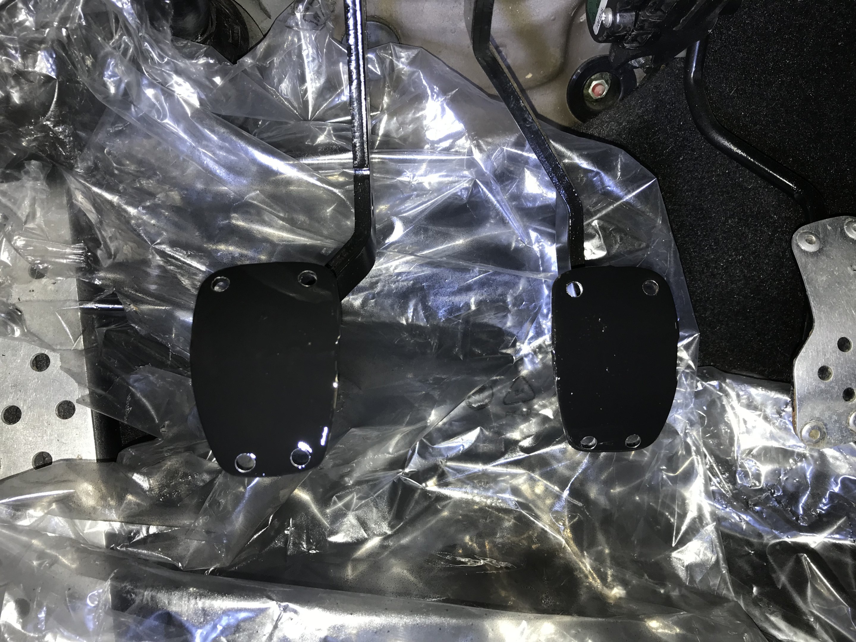

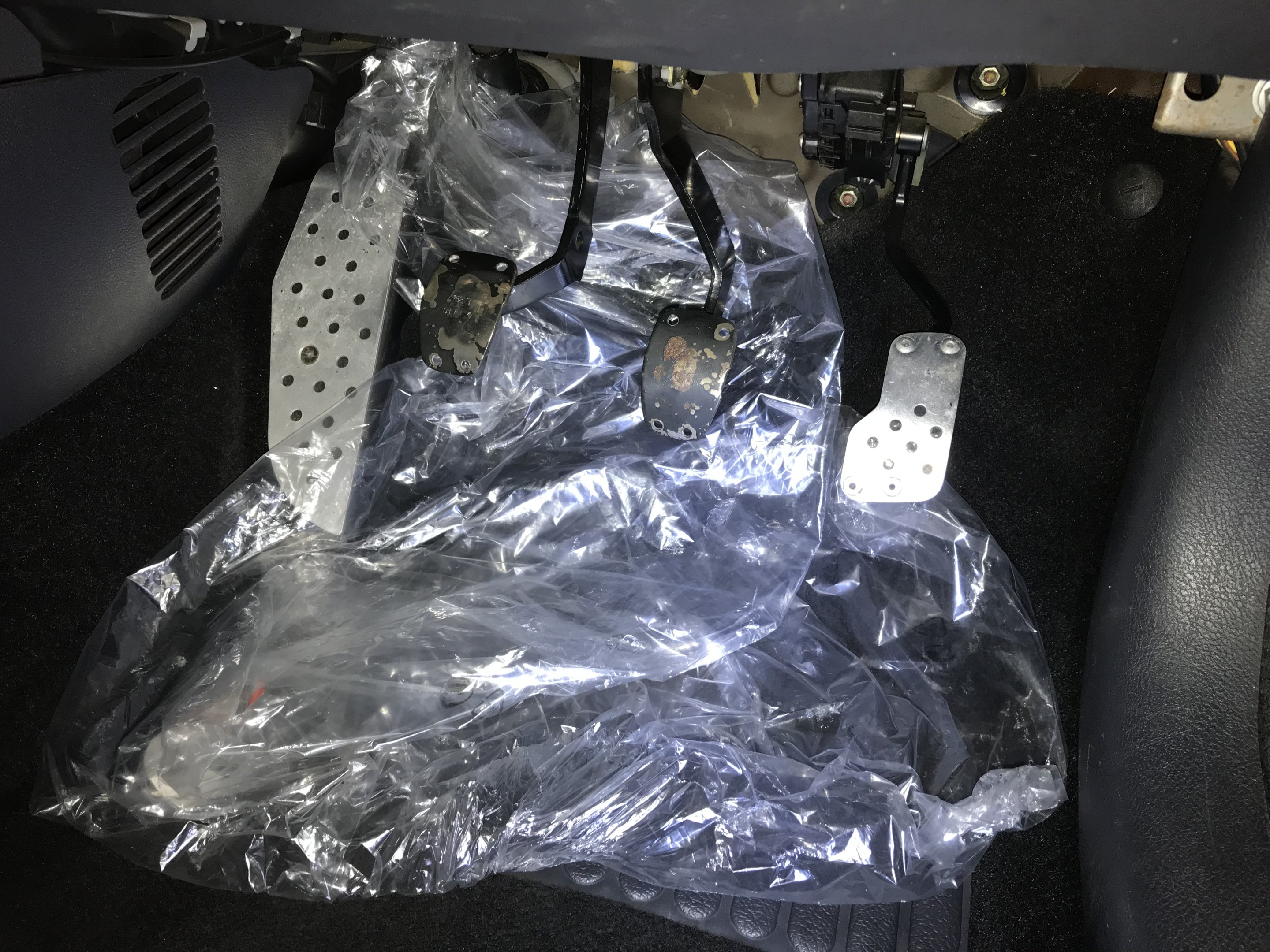

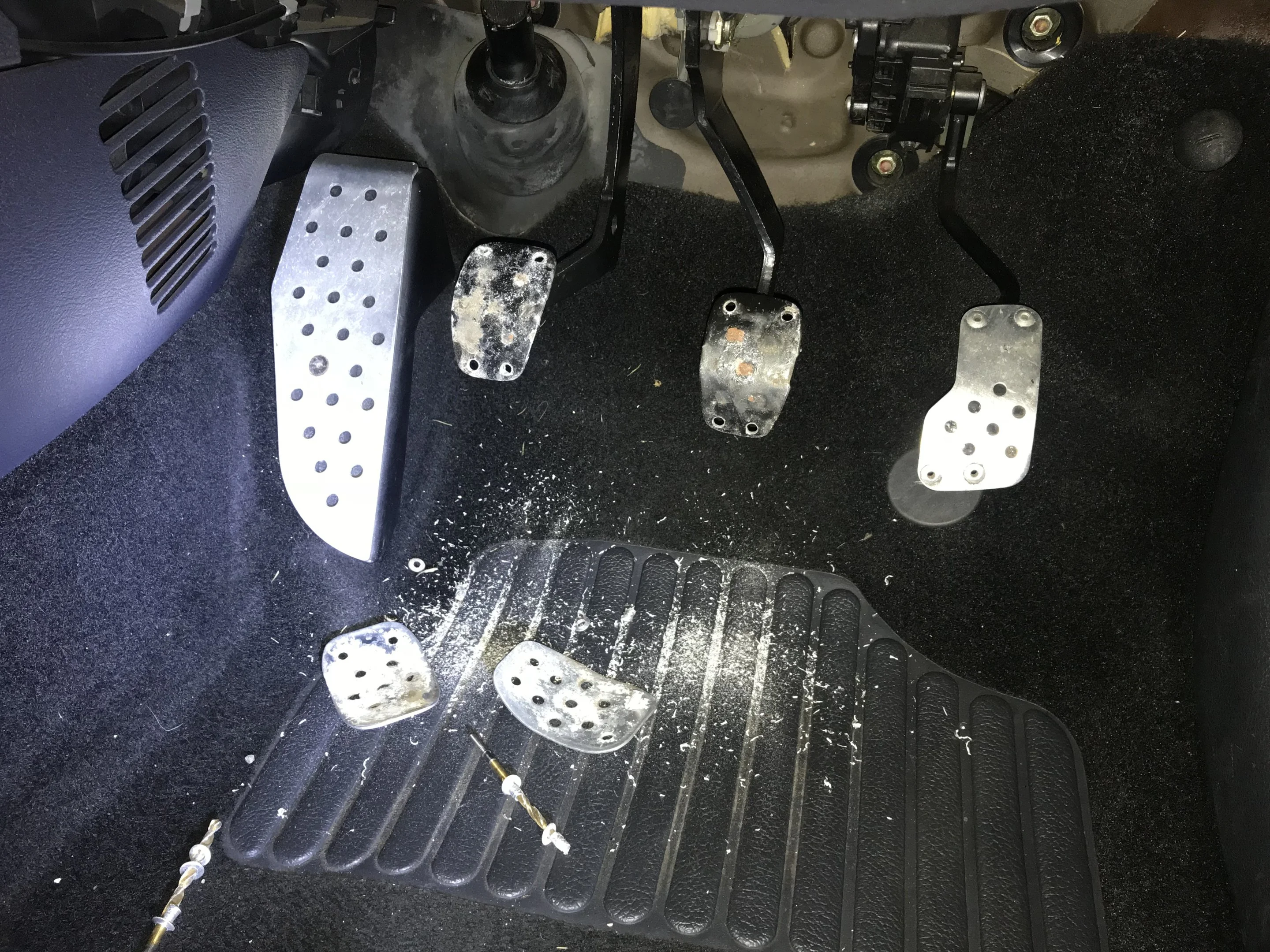

So I started by drilling out the 2 top rivets and the 2 bottom rivets to take the covers off.
Once I done that I then took the wire brush on the drill and cleaned up the pedal from all the dirt and rust along with all the corrosion from the alloy.
I next then got some black hammerite and sprayed the pedals and left them to dry for a couple of days.

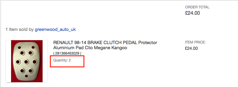

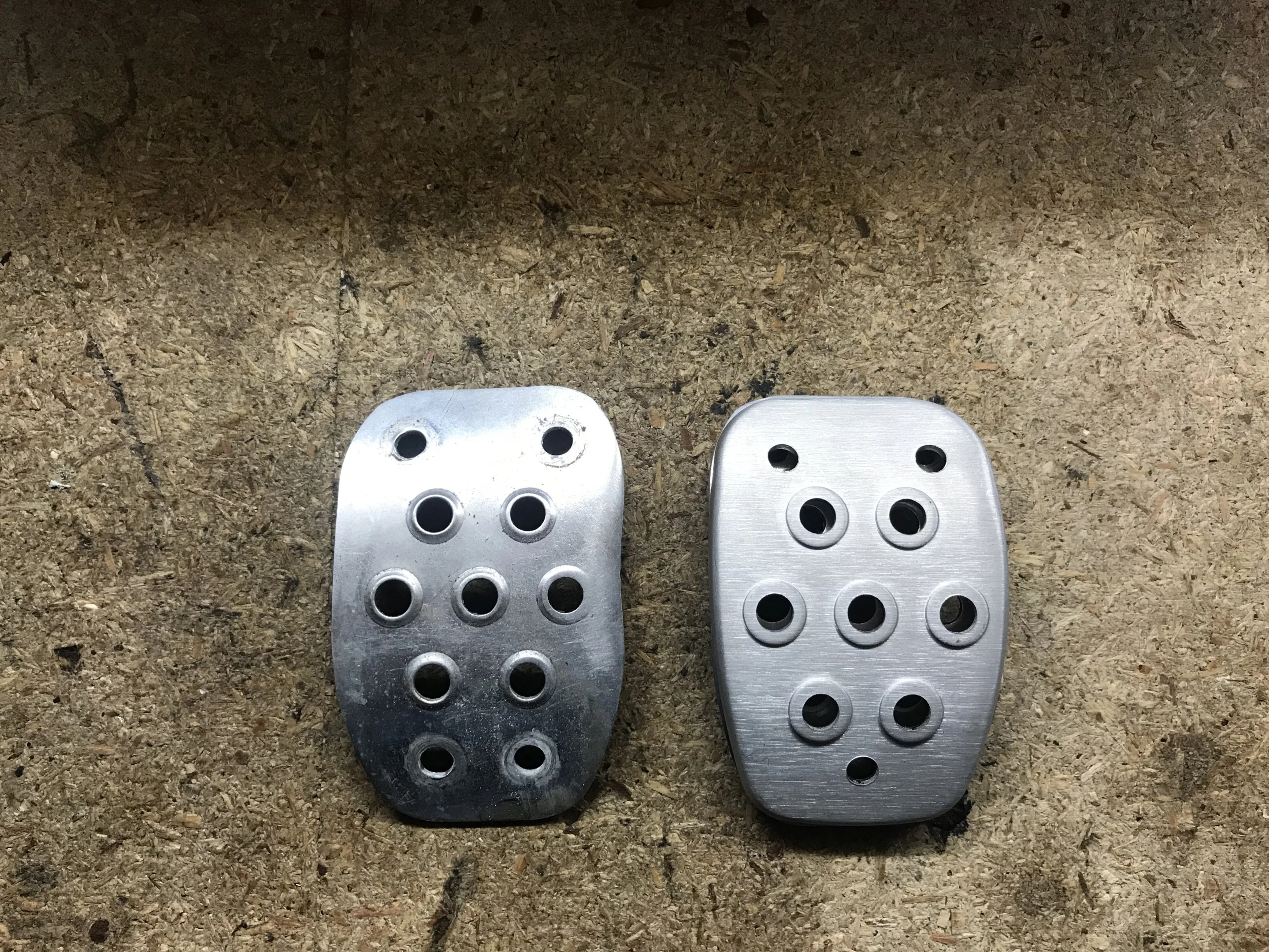

Now as you can see there is 2 rivet holes at the top and bottom and as Renault now no longer sell the original covers you need to go for the newer pedal cover from the Clio 197 / 200 which has only 2 holes at the top and "ONE" at the bottom.

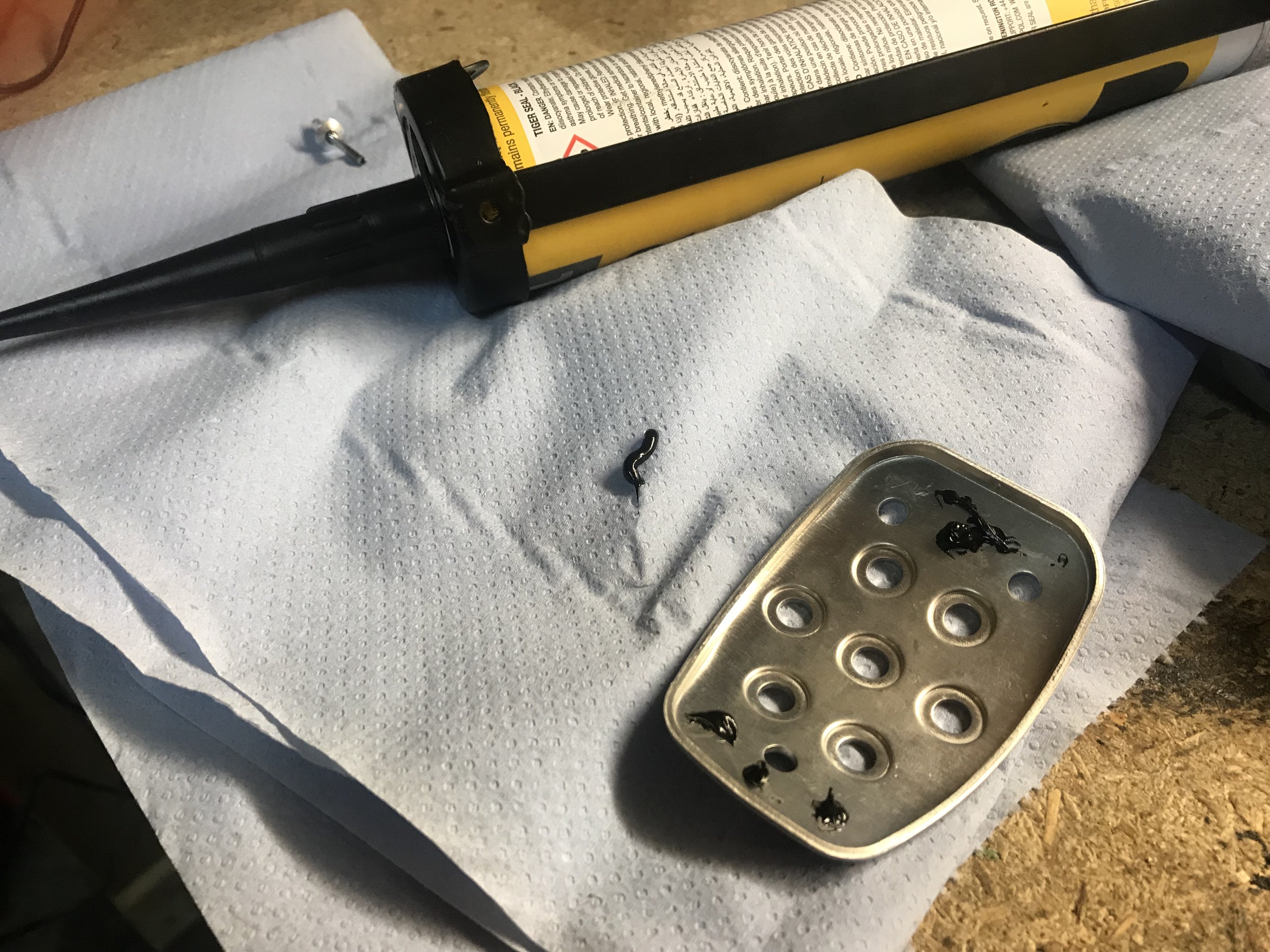

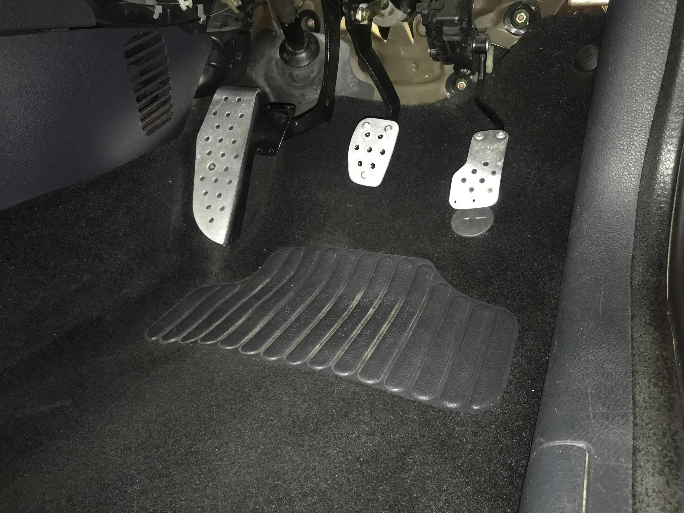

What is needed now is once the pedals are dry and clean is to get a small blob of tiger seal on the underside of the pedals and then rivet the top two holes in so it is sitting perfectly.

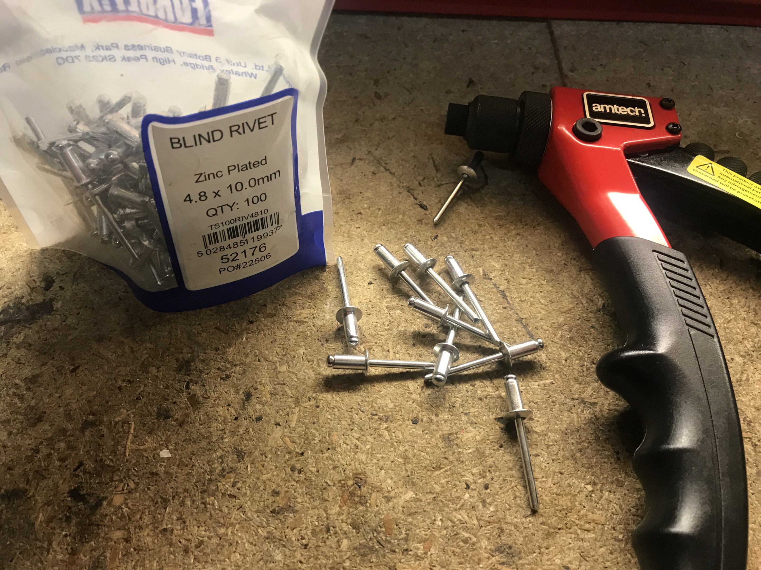

You also want to make sure you have the correct size rivets which are in the picture below.
Once you have put the pedal cover on and done the two top rivets you then need to get a 5mm metal drill bit and drill a hole through the centre of the pedal at the bottom to put a single rivet into it as it only has one rivet hole in the centre for the MK3 covers.

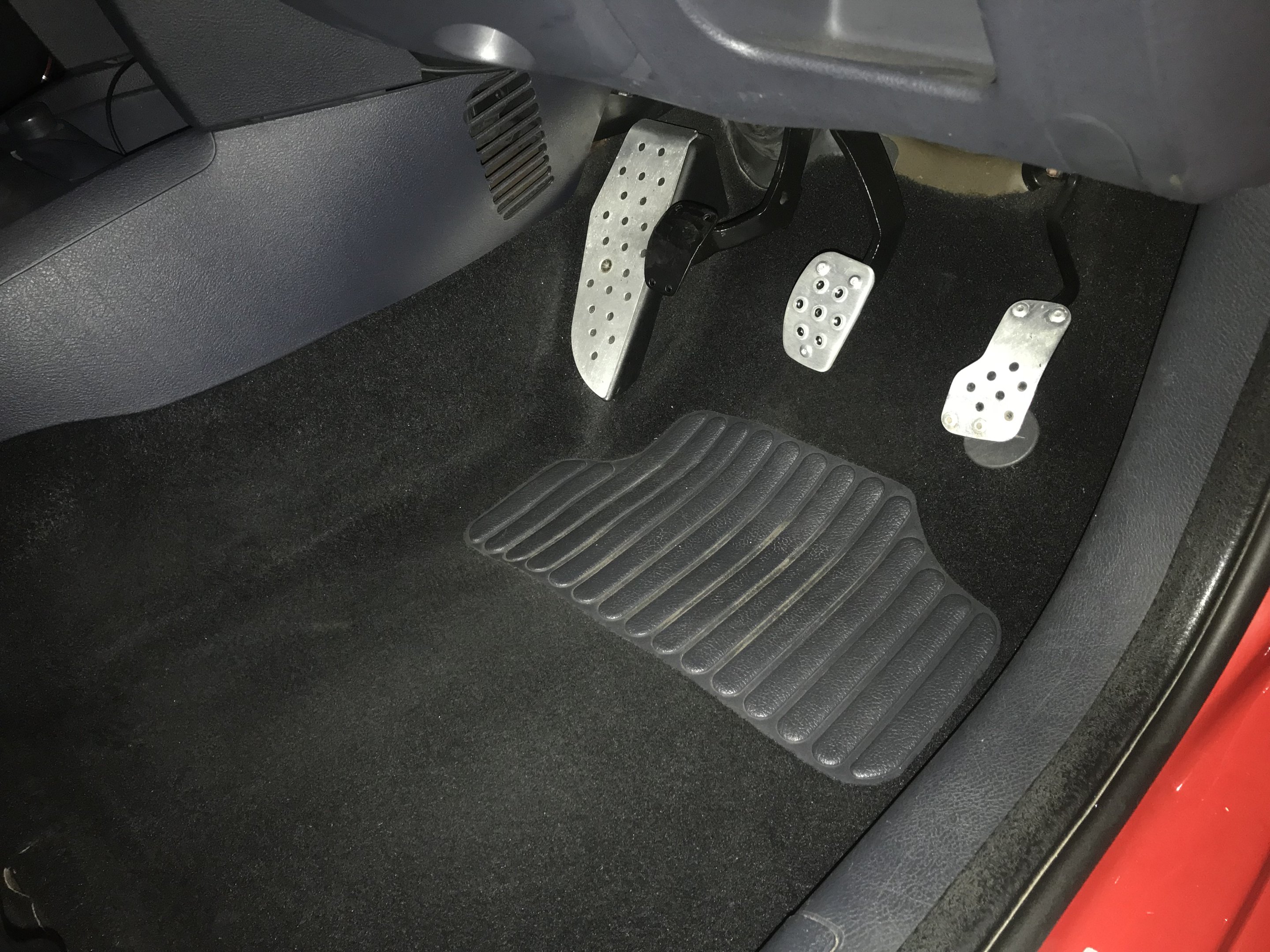

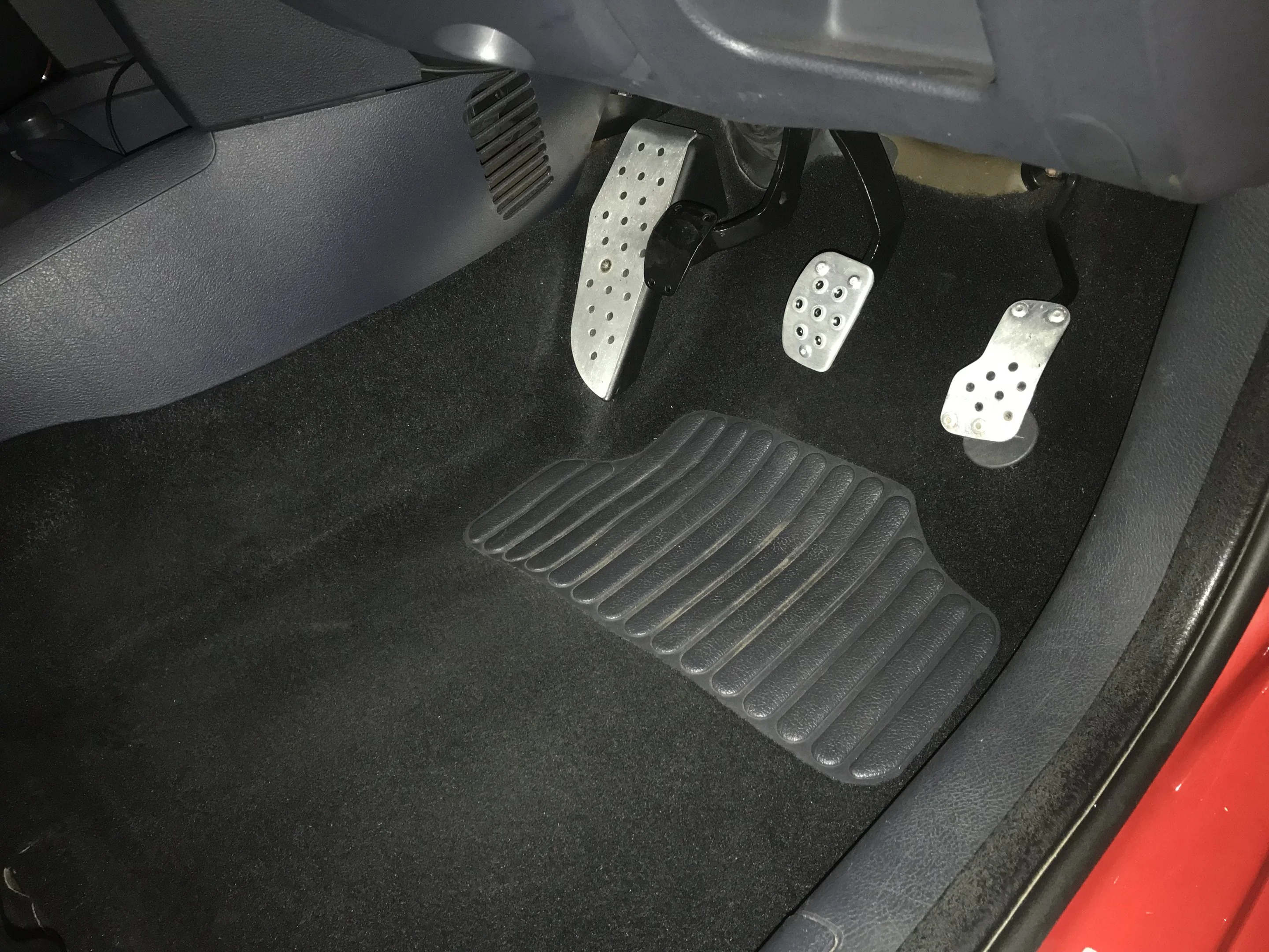

Nice work mate, makes quite a big difference actually, more than I'd have thought.

My point that im making is the the alloy wears away and they do get slippy and also look sh1te so its best to change them plus the genuine OE ones have some grip with the raised holes and others done.

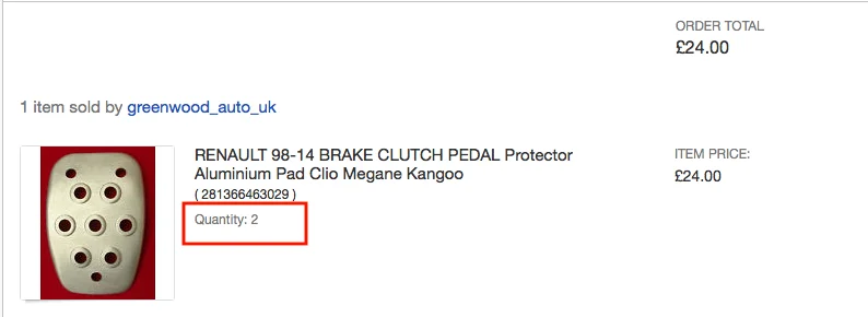

You can buy genuine OE covers for pennies so it was worth doing and the are the exact correct fitment and cover the pedal perfectly with no over hang.

I second what Marc has said. In fact it was Marc that gave me the info and I bought the same as him. Fits exactly the same and looks and feels a lot better than the old worn ones.
A worthy replacement for not a lot money.
