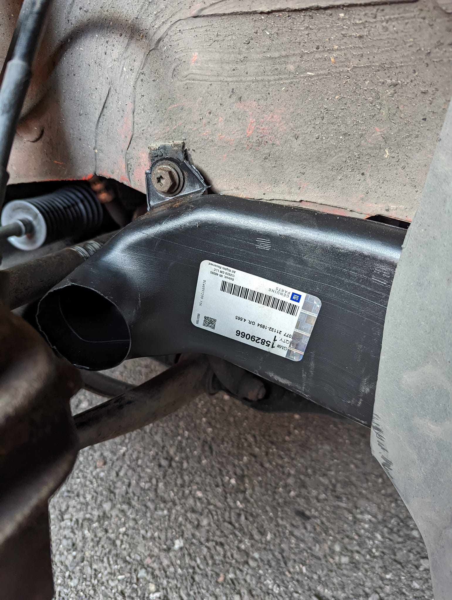

I managed to keep my liners inplace with the C6 Ducts, you need to heat and bend the ducts a little to make them fit.

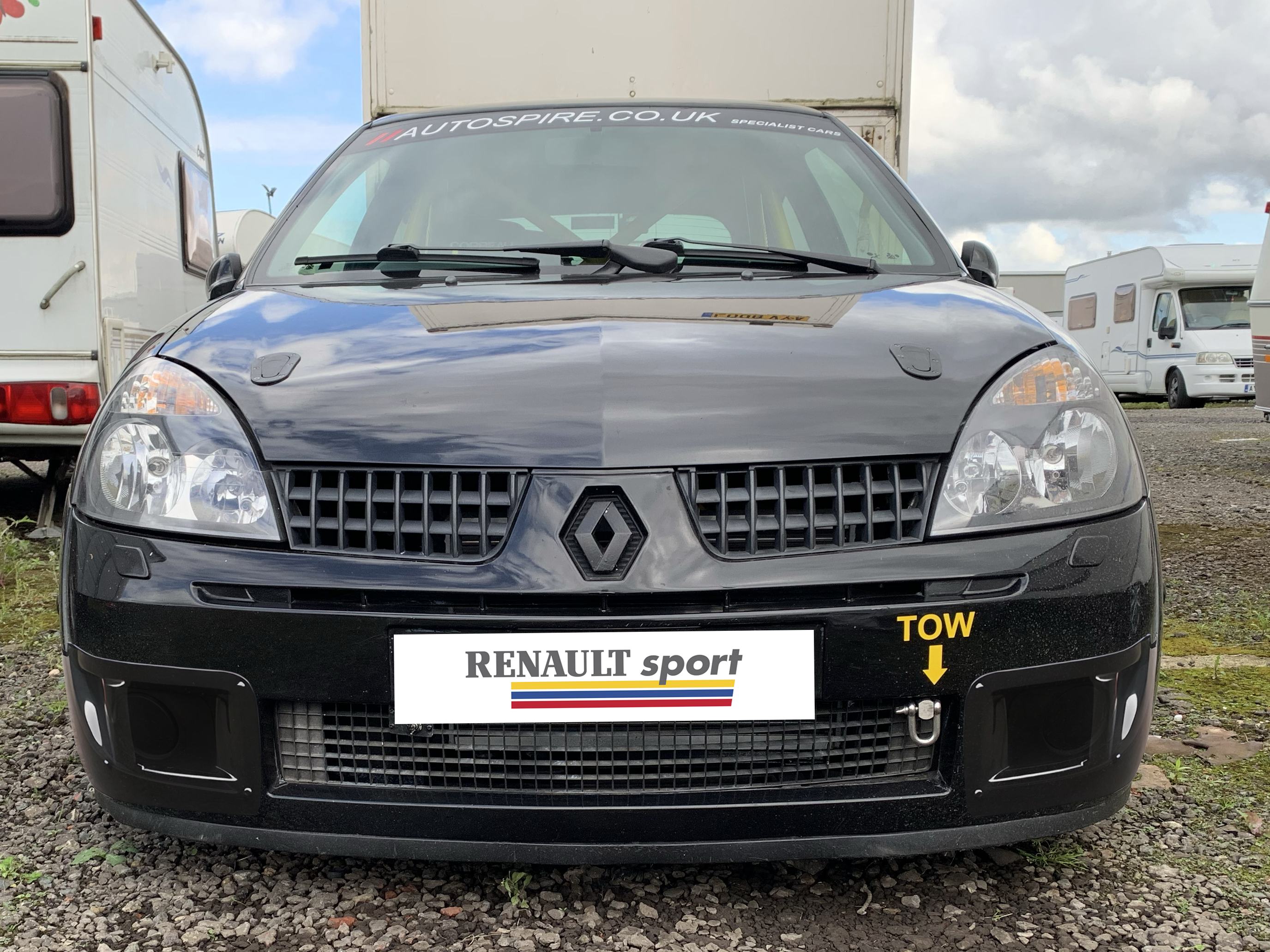

I always fancied the K-Tec racing ducts so mocked some up on the track car. They’re definitely ugly but will do the job. The current theme of the car is Black with Yellow cage, yellow brake calipers, yellow hoses, so just wondering if I should continue with that and paint them yellow 🤔
I kinda like how ugly they are! Makes them look purposeful. What about if you re-fitted them from behind, so the "flange" was hidden, and the cutout only showed the guts of the vent?
Yeah, you tend to see them more on proper circuit cars, because as you say, they serve a purpose.
When they arrive I'm whipping them into the body shop at work and they're going to see if they can integrate them into the bumper.
Then I'll get the whole bumper repainted, including vents, so it looks cleaner.

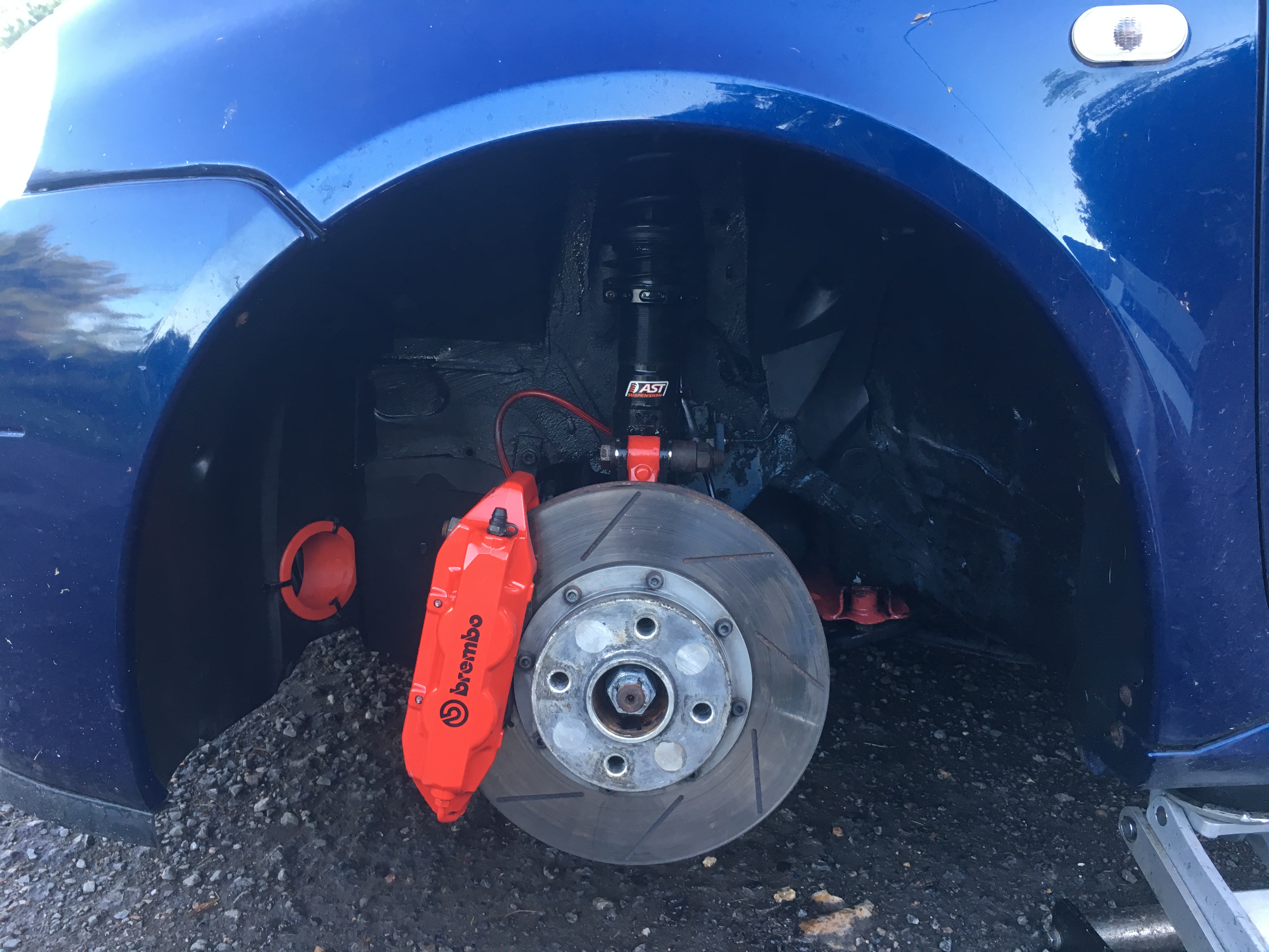

I found after a long stint on track my brakes started to fade so bought a kit off eBay and just with fresh air venting into the wheel arch solved the problem.
I was using Carbon Lorraine RC6 pads with a Tarox F2000 discs and standard calipers.
Should’ve stuck with that setup as it scrubbed off speed so quick. The next problem it crated was the tyre rubber going off :rolleyes:
I’m now using Brembo’s with the DS1.11 pad as people raved about them but don’t seem to have the same bite.

I’m now using Brembo’s with the DS1.11 pad as people raved about them but don’t seem to have the same bite.View attachment 1665556
That’s good to know, that venting location looks good actually a few I’ve seen come in at the top and I just couldn’t see how they would work. This looks good. 👍

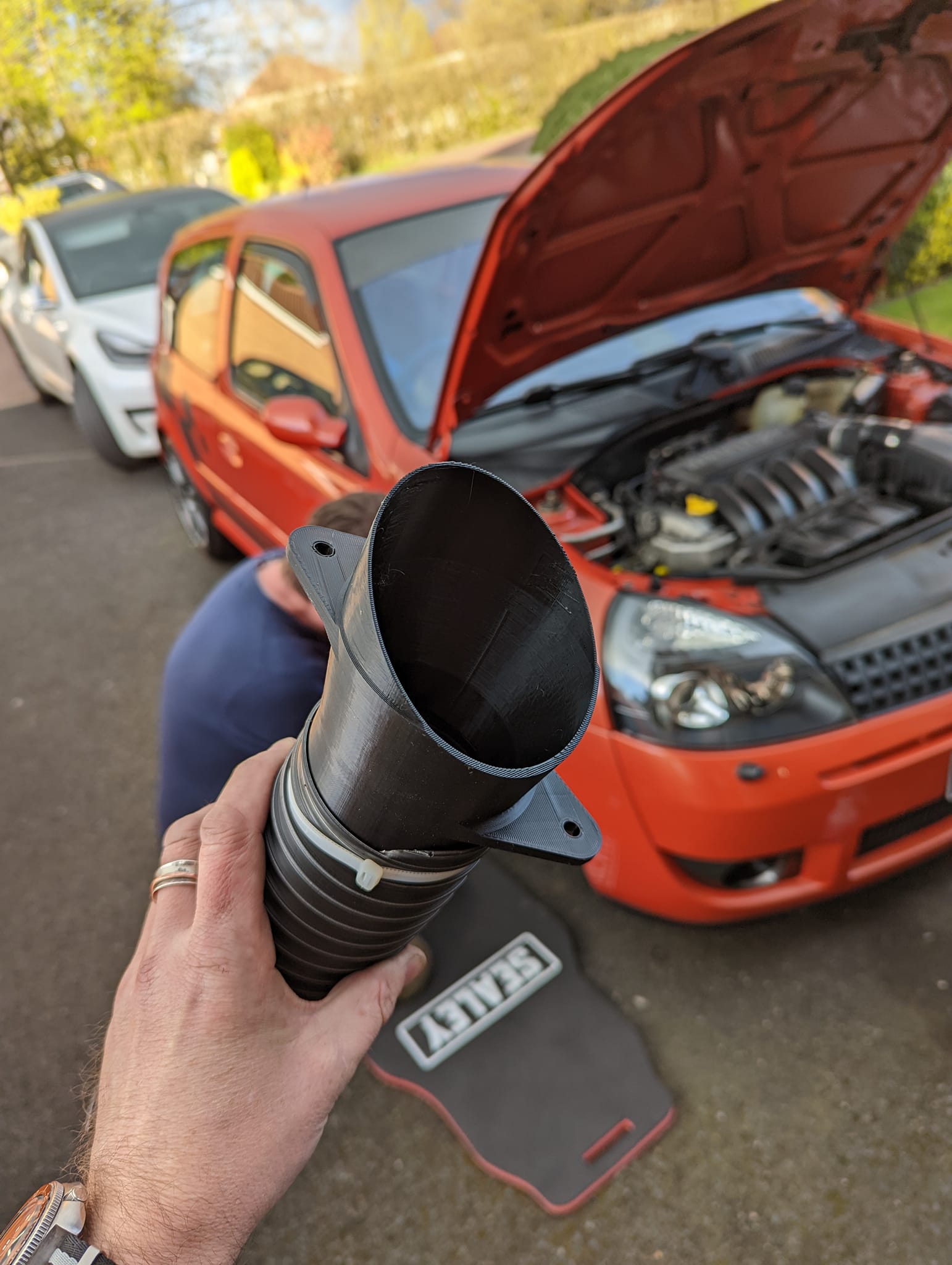

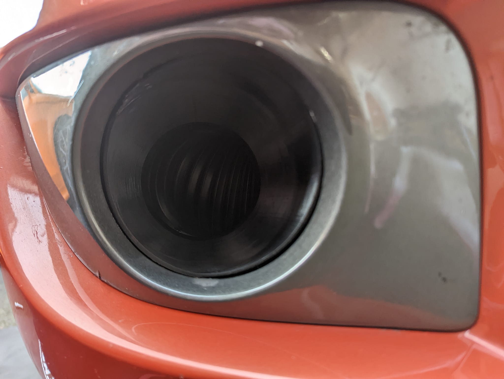

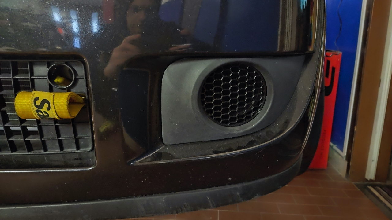

From my experience they do a nice difference.

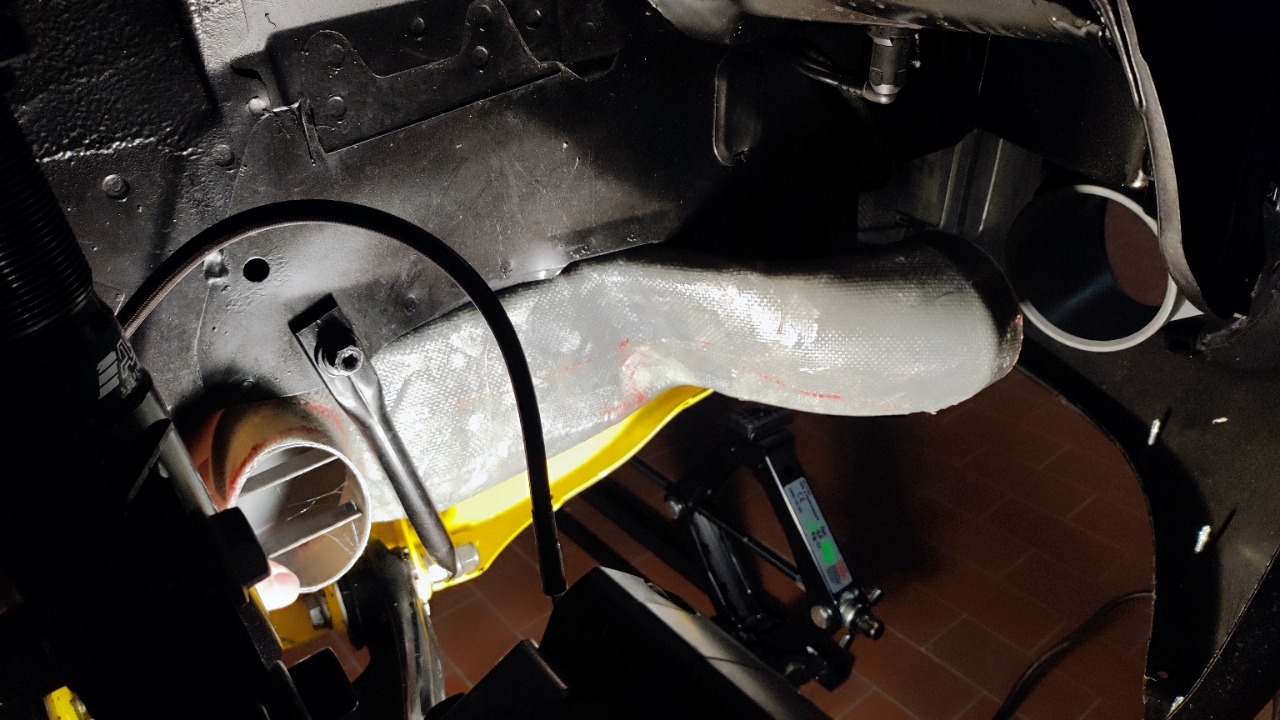

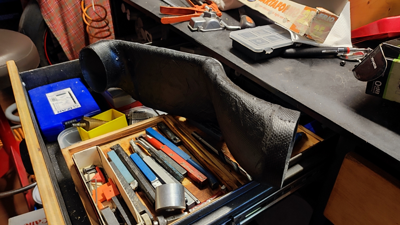

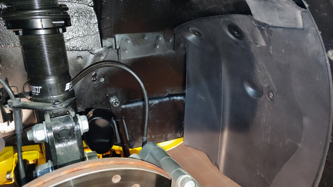

Fabricated some ducts made out of fiberglass from foglights with a shape similar to corvette ducts but made to perfectly fit clio chassis. I attach a couple of pictures took during the prototyping.
Unfortunately I ended up removing the mudguards because the car is very low and at monza the tire grabbed one of those and ripped it away.
I even did some grilles to avoid big things to get inside.
Anyway..
To my experience they do a big difference. Tested at Monza track without having brake issues of any sort (running 280+ wilwoods midilite).
I compared the use of car on a local short test track and behaved very well. On July with like 36C ambient temperature without them I had to cool down after some laps, with them I've been able to push hard the whole time without issues.
In the last pic there is the almost finished duct, it only misses the last bend that connects to the 3d printed 100mm housing bolted to the foglight bracket. I managed to lost the picture.
Anyway..
Now my car is away mapping for new cams, when it comes back i can take a picture if someone wants to see
Those ducts look awsome!
Anyway..
Been away, so a delayed reply... These look spot on. I wish I had the capability to make something like this. Great job.
