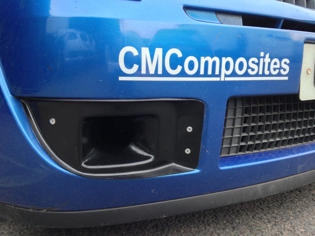

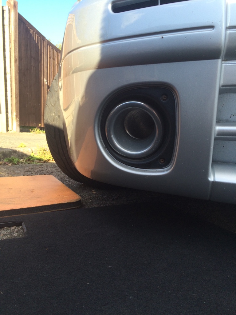

Don't know why I bothered getting mine as im waay to lazy to relocate or remove the acoustic valve and carbon cannister so my air comes in through where the fogs used to be with the inserts and exit via the holes I made in the wheel arches also with the inserts. I could be wrong but I swear the car feels more unstable at speeds over 100mph now

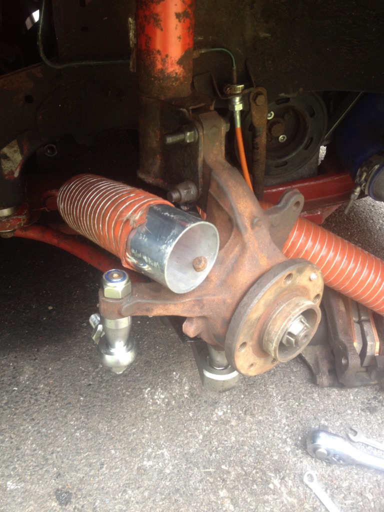

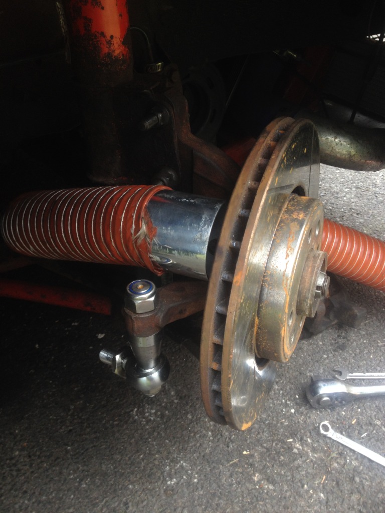

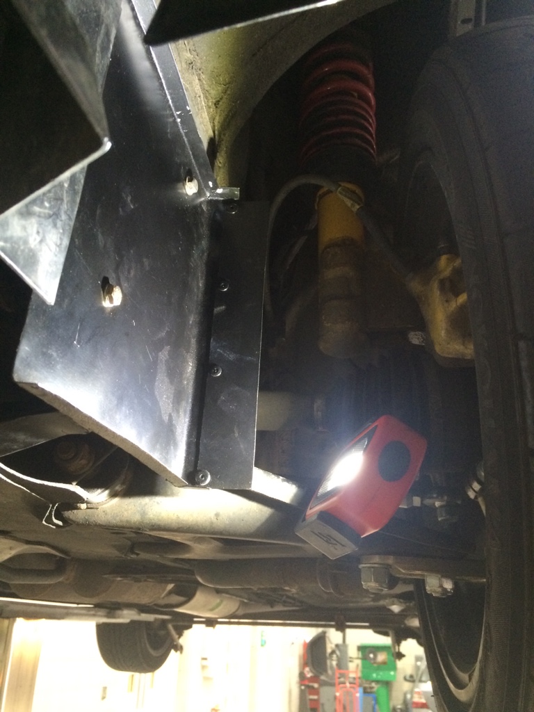

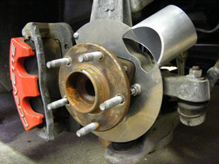

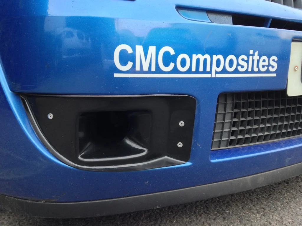

Few pics of My brake cooling setup when I was fitting it (on a mk1 )

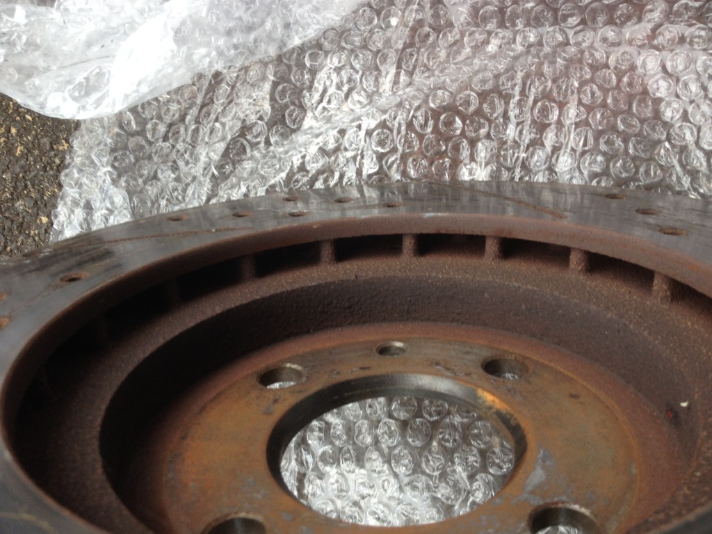

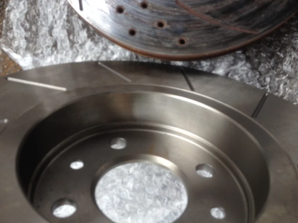

Ideally you want to force air up through the centre of the disc to cool it evenly the only problem with this is as I've found is a lot of clio discs are vented from the front instead of the rear and it really doesn't work as well
Like this
Instead of like this
When I get chance in going to make some better ducts that fit to the hub something like this
Good set up, however you can cool the brakes down too much and move them out of their operating temperature, so by the time you reach the next turn your brakes would have cooled down too much.

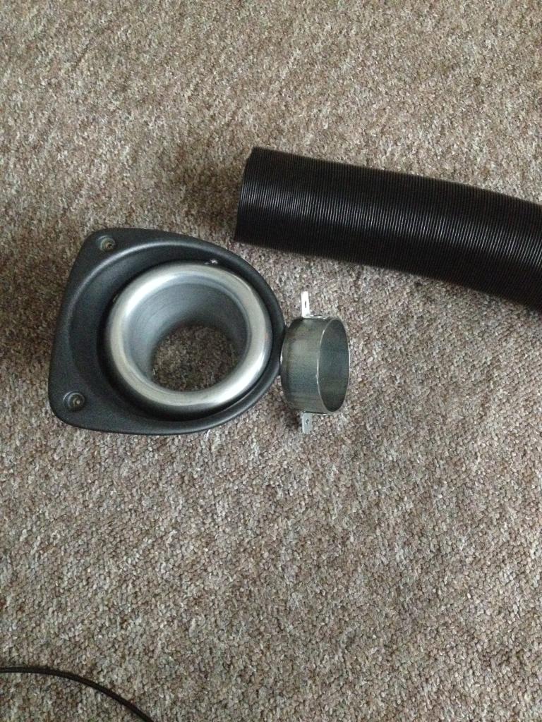

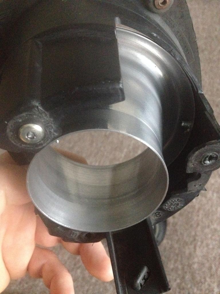

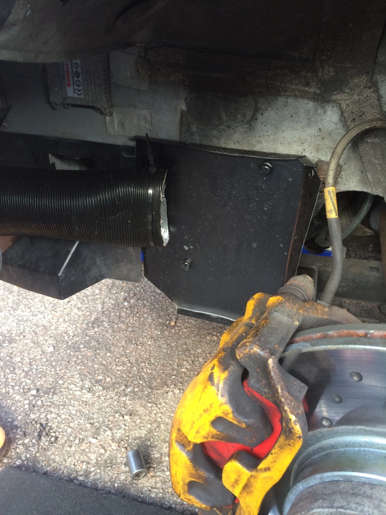

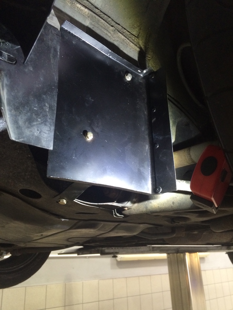

Managed to get these fitted today , seems to fit quite tidy , when car on the floor , no fowling on full lock and it clears the braided brake line . [emoji2] sweet.
O/S one doubles as a guard for the crank pulley as such

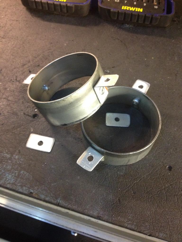

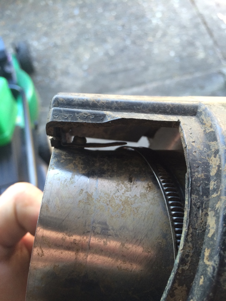

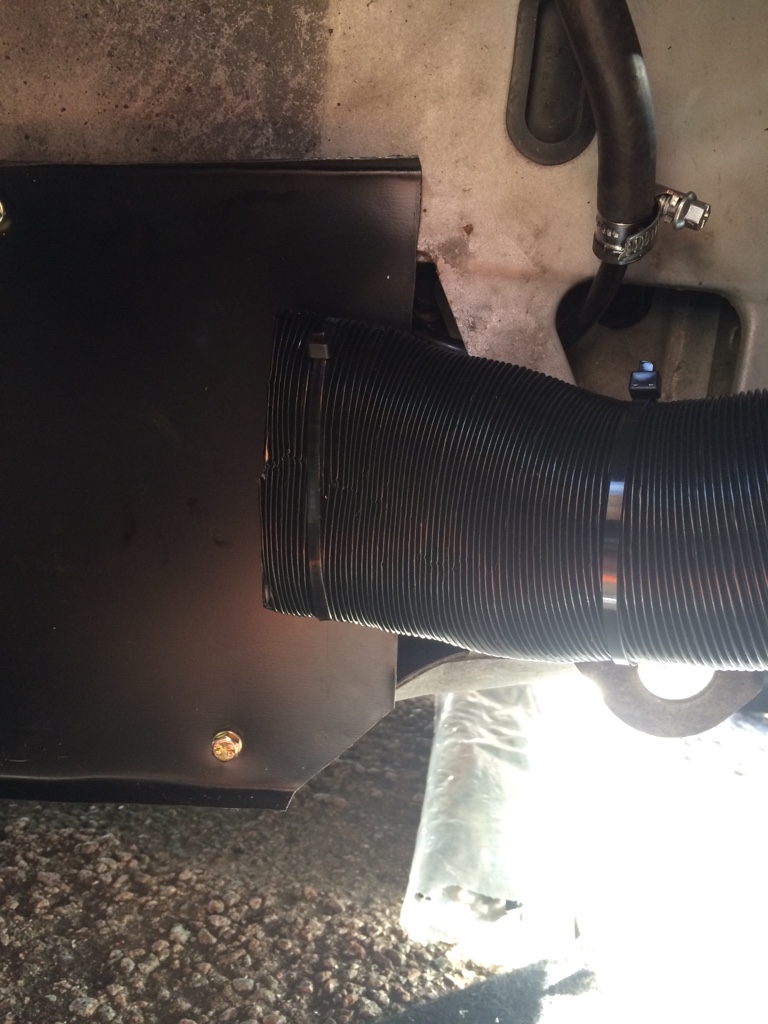

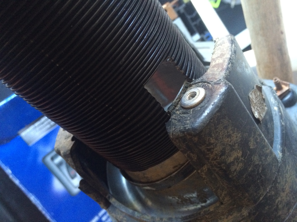

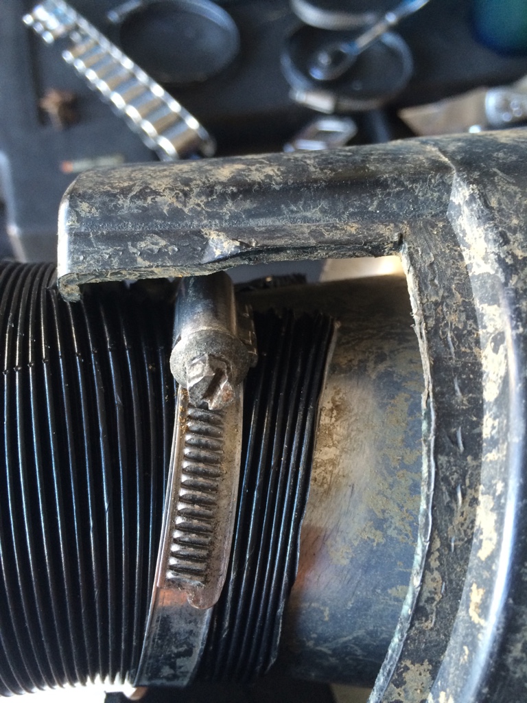

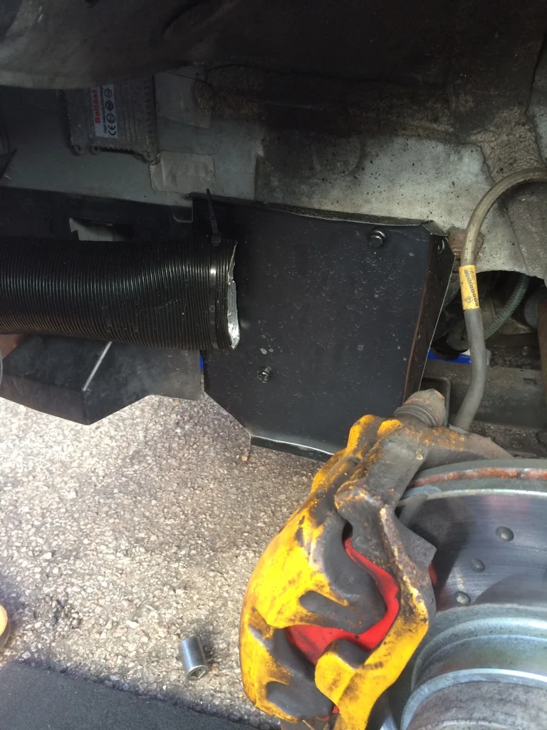

So I'm doing the last stages of the scoops today , as you can see in the pic one on my brackets which is pop riveted to the fog housing and this only poses a minor issue.
I had to cut the pipe to pass along side of the riveted part .
Once in place I secured with a hose clip and it's nice and tight .

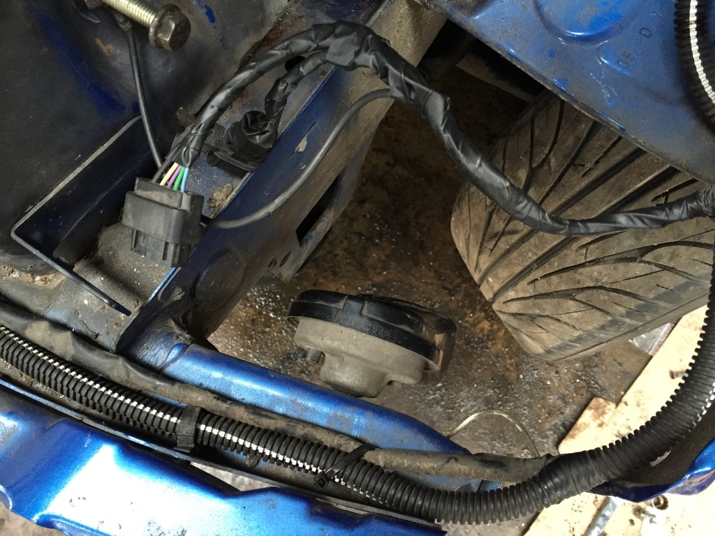

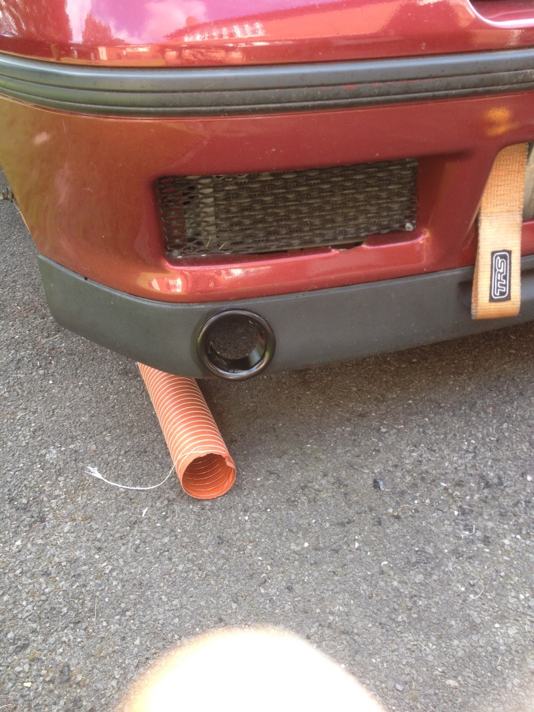

Im such a t**t. It never occured ti me that if I had ordered regular ducting I could just force it into place between the carbon cannister and the horns. LoL
  172 Ph1
I did re position the horns but just a fraction , as for my carbon canister it's no longer there.
  172
I have two horns and have no idea how to remove CC or the acoustic valve. Not sure I want to either as im sure they are there for a reason.
  172 Ph1
Purpose of the carbon canister is to store tank fumes and then bleeds them into the engine at certain times when requested.
With it gone makes this process redundant so fumes won't be drawn in to upset the mixture . A cleaner running engine so to speak.
I had two horns too but I removed the bracket, removed one horn from the bracket and then mounted that horn directly to the chassis where the original bracket mounted. Doesn't sound as good with only one tone but i'm not that bothered.
