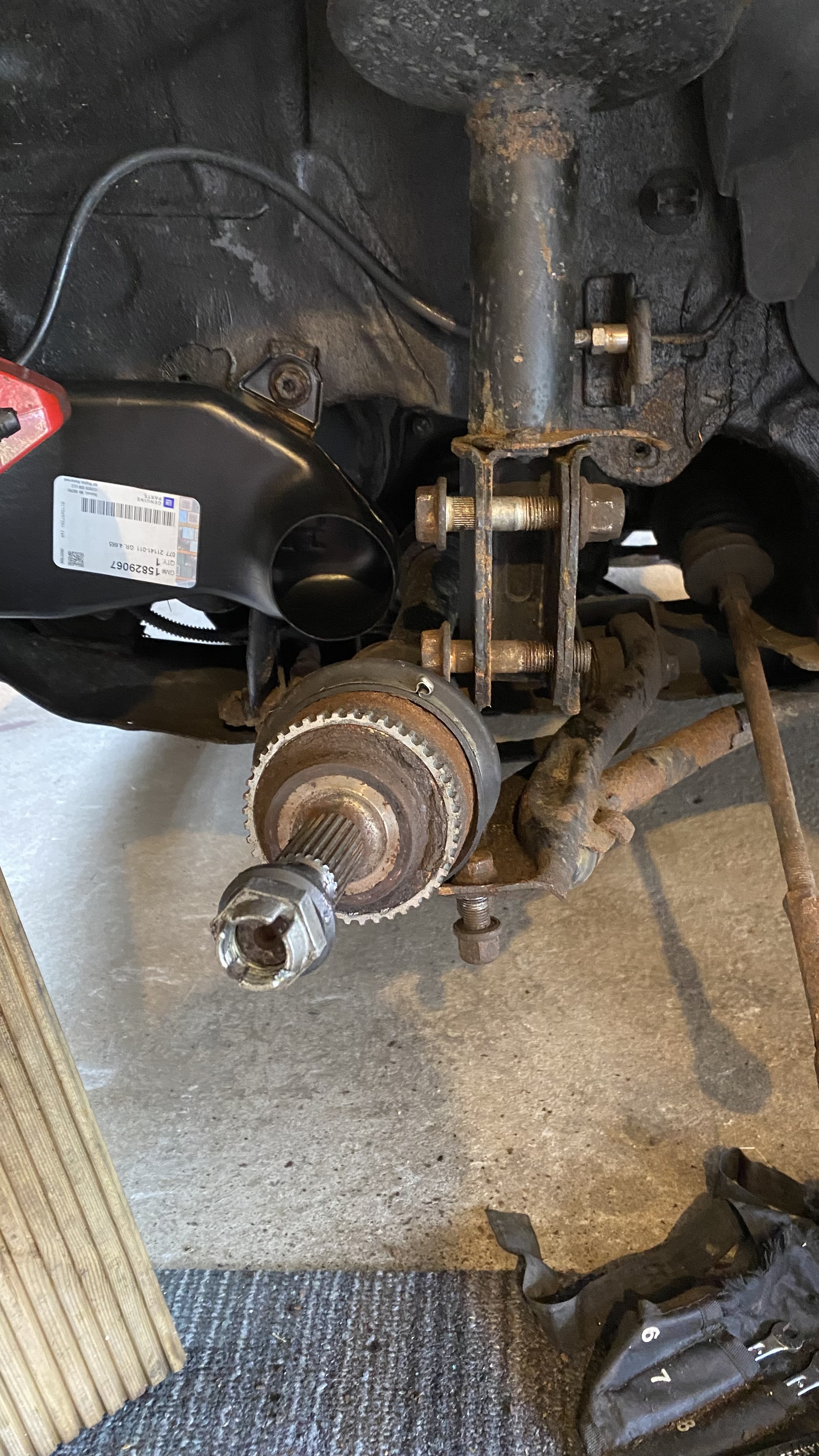

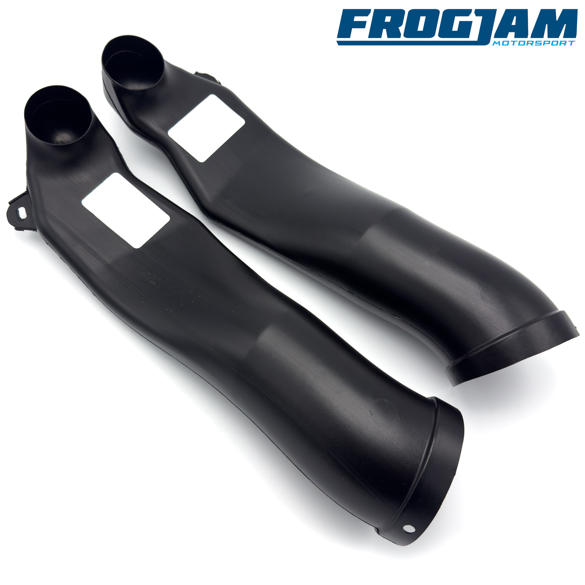

As above. Corvette c6 ducts. They are basically oem. They bolt onto the subframe mounts and align perfectly. I needed to slightly warm them to bend them in a bit so they didn’t catch on full lock when I was running R888Rs on the front.

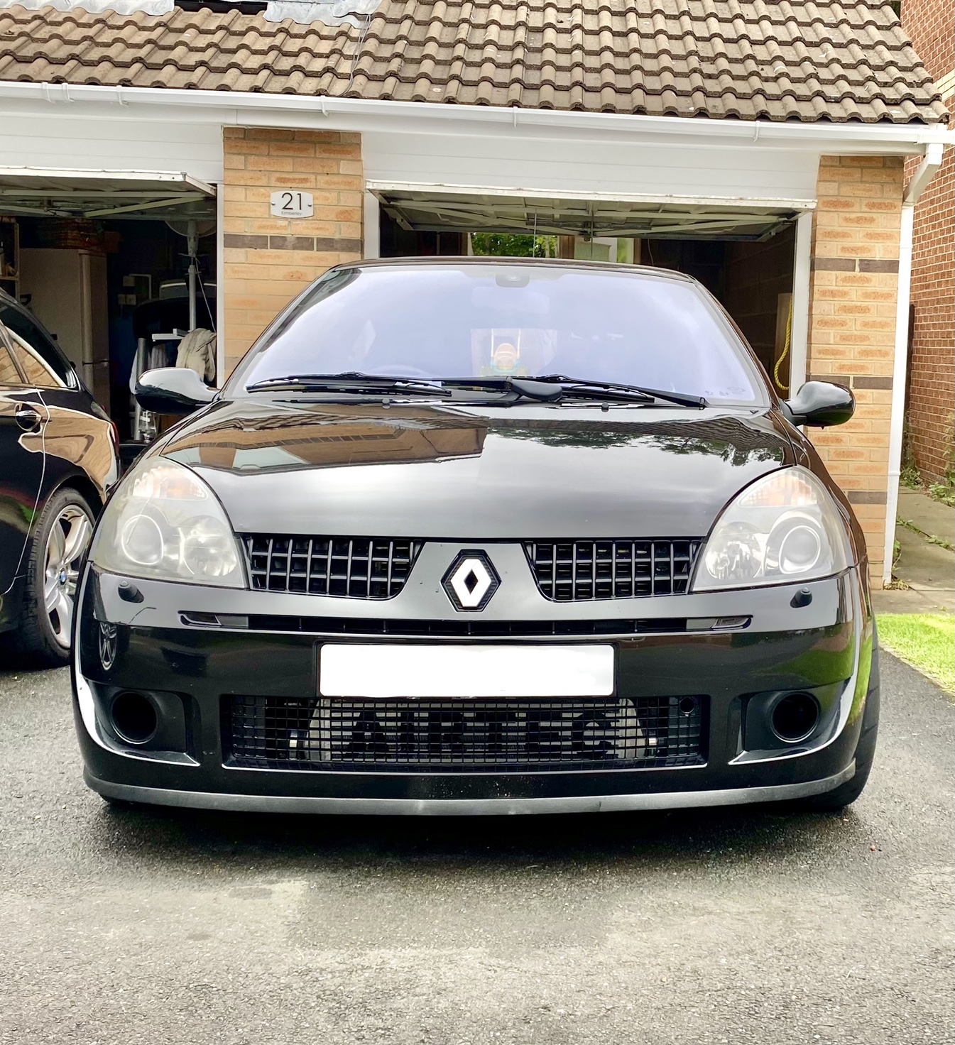

As above Corvette ducts are great. I’ve got Cm composite cup ducts in my bumper and corvette ones fit behind them perfect!

Yep these look good.
I’ve got the fog duct already in place but at the moment it’s just like tumble dryer duct cable tied to stuff and looks a mess.
So the c6 ducting just connects to the rear of the fog duct is that correct?
