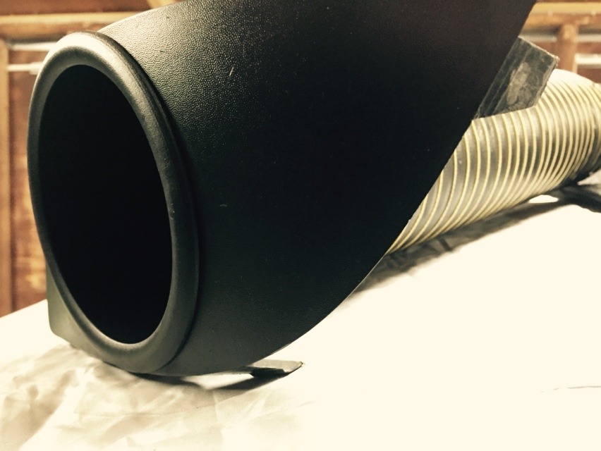

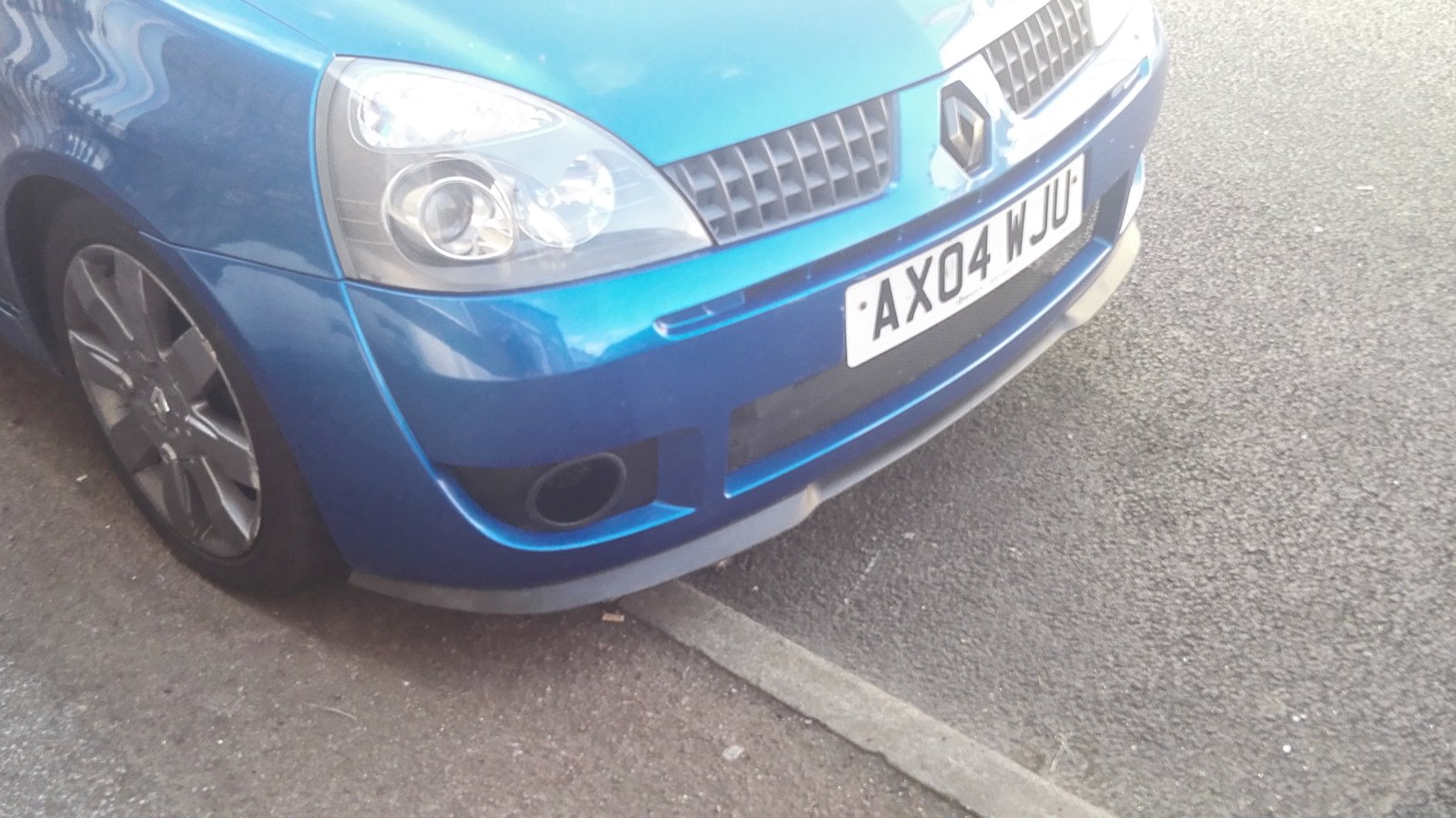

Hi! Recently I bought 100mm bass port to make brake ducts/ cover holes after removing foglights but unfortunately they won't fit. Anyone got ideas what size will be correct? Maybe someone can give me auction number? Someone done it, but now i can't find who was it. Anyone?
I think @MarkX was the guy who made it work with the ports. I bought some to try but I broke one of them trying to push fit it! In hindsight enlarging the diameter of the fog light recess slightly beforehand would have been a good idea. Might have another go next time I get some spare time.
Did you remove the fog surrounds or try to fit the ports in place? The fog holes aren't quite round, it takes a bit of squeezing, much easier with the surrounds removed from the car, tight but they go in and don't move when fitted!
No I haven't removeed them. I just give it a quick try today, probably will have more time in weekend ... Does ports from auction number 201475761432 looks similar to yours? Thanks for replying!
I removed the surrounds but maybe I had slightly different ports as they were nowhere near fitting flush even with a lot of persuasion!
Right... So with a lot of persuasion they fit to the fog light surround... But I don't know where my saw is and can't cut them as they too long and they need to be filled on top little bid as they overhanging.

Warm the bumper & trim with hot airgun, trim top rear of duct to clear crash bar behind bumper and they push in no probs
