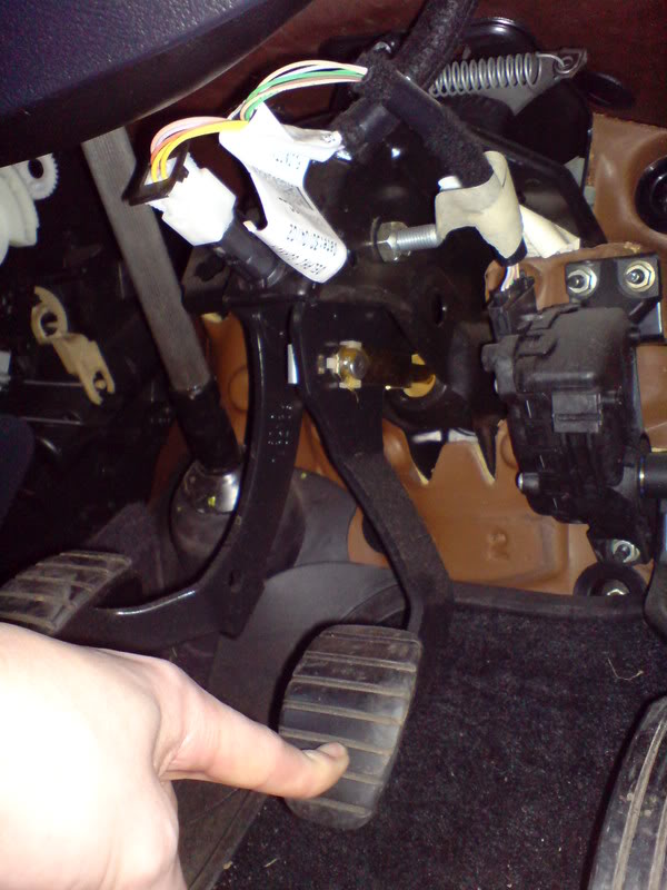

I took a picture of the switch, I can't see any where u can adjust it. Anyone know?

its either pedal adjustment or the simple fact the switch needs to be about 2mm further away from the pedal
could just file off 2mm from the plastic switch (far right in pic :P)

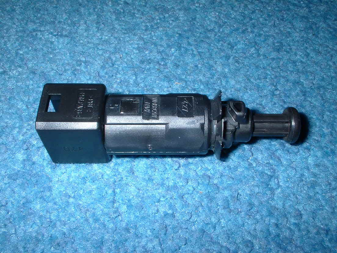

Get a new sensor or fiddle wirth the stock one I made a mistake the Mk2 ones arn't adjustable the Mk1 Clios are adjustable.

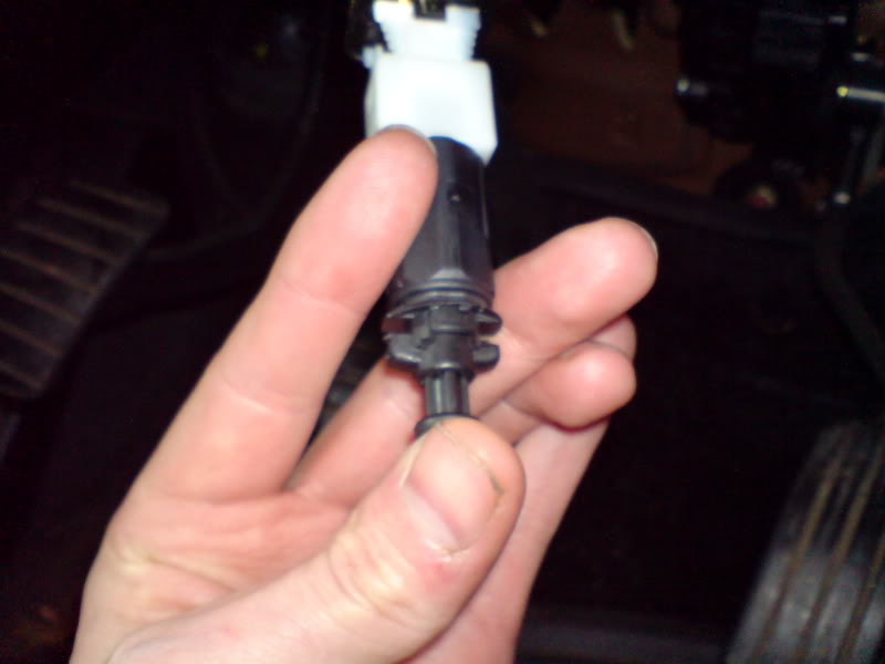

basically, the plunger part of the switch (twist and remove - v.easy!)
has a ratchet. Each ratchet is say 1mm
All i needed was for the switch to be about 3mm shorter.
After a quick play - i pushed the plunger in for 5sec firmly and it click, click, clicked very fast say 5 times.
Cleary 5 clicks was too much as when i re-fitted, the switch then didnt touch the pedal at all :D
After mucho swearing, getting the switch back to its longest setting is easy - just gently but with force pull the plunger for 5sec...again it will 'give way' and click up the ratchet.
I then pressed firmly one more time and voila! 3 clicks and my brakes light 100% perfectly :)

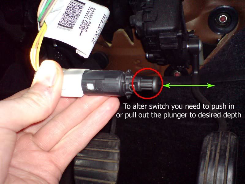

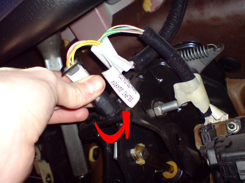

Quick guide for you people who haven't done this that want to.. (this is for the newer brake switches.) btw, you'll might need a mirror or a wall to check brake lamps
1. hold your pedal down.
2. Then with your other hand, twist the switch off (counter clockwise)
3. Then if you grab the switch plunger on the end and push the plunger itself, it will click, let go and push again.. it will click again. Inside it alters a plastic shaft type ratchet system, to reset it, pull the plunger out and it will click out altogether.
after every setting, place the switch back in the hole (holding pedal down when you do so it will sit properly) and test your pedal by tapping it with your hand and looking to the back of your car at the lamps.
If it's not working right repeat step 3.
I've managed to get it to light the lamps just after the point of pressure on the brake pedal, (three clicks in on mine)
Thanks for that little guide :)
I'm going to give it a go on mine because it's the same as others have mentioned. It's not terrible but light breaking doesn't activate the lights.
yeah as said you just yank the plunger of the switch out, put the switch back in the when you press the brake it self adjusts
Check the picture in post #8 If yours looks like this then the guide should work. If however you have an older switch, as edde said in post #3 Then the plunger itself should twist like a screw.
