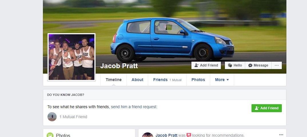

Jacob something on Facebook. He's camberley based and breaks 182's every now and then..
Any 1*2 has the same hose.
