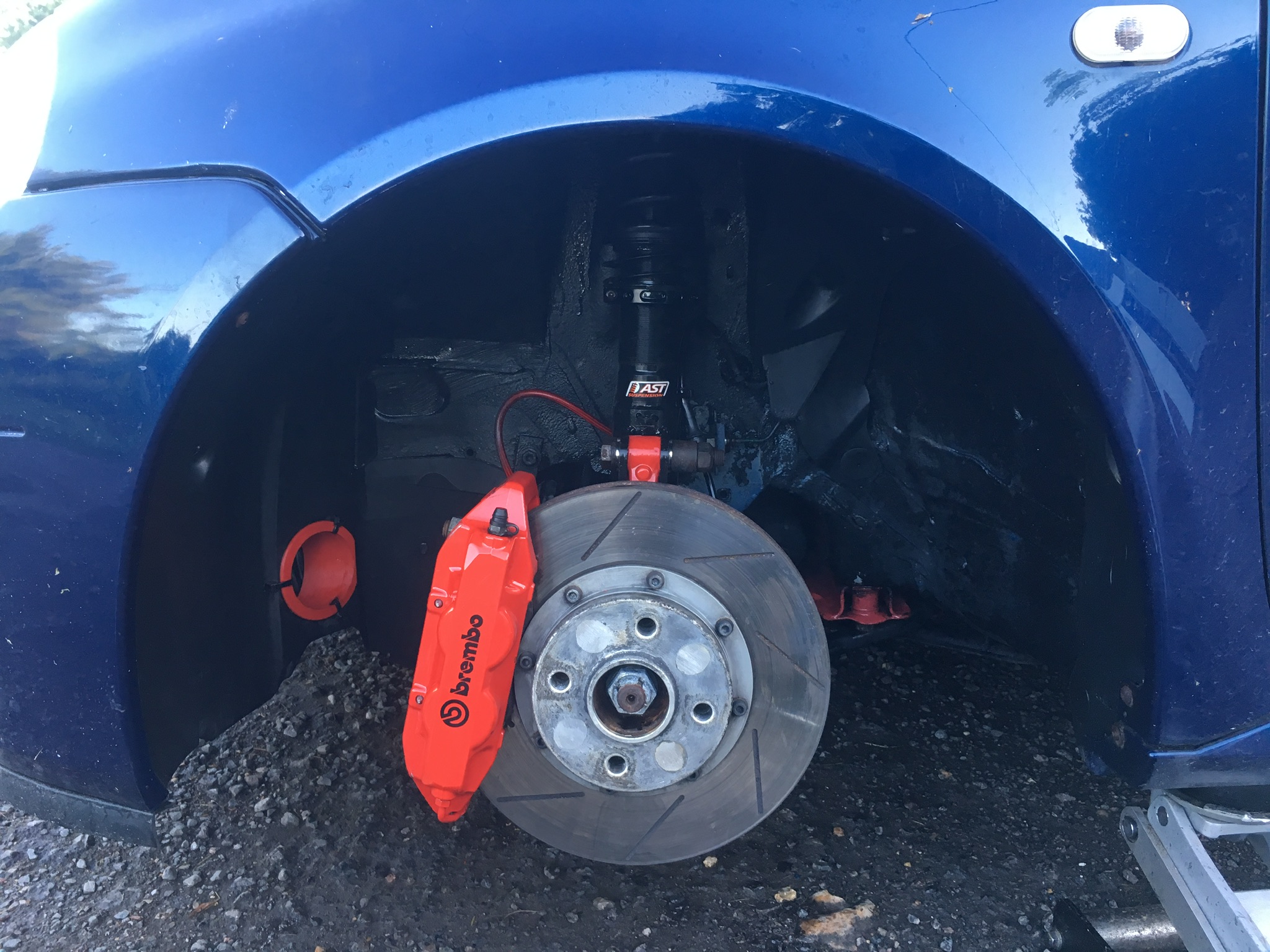

@CTR i got something like this. Not cheep but perfect fit. Only need to drill wheel arch covers.
Cooling is important. It lowers pad and disc wear.
