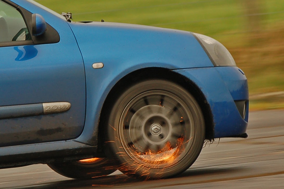

If you care about your wheels and/or paintwork, leave the PF97s well alone.
Running a set on mine was the beginning of its cosmetic downfall...
My PFC 01s were similar till they were up to temp. Once hot they didn't spark anymore. On the road they just didn't get hot enough to be in their optimum heat range. The braking was still mega, but i don't want wheels full of angle grinders every day :D

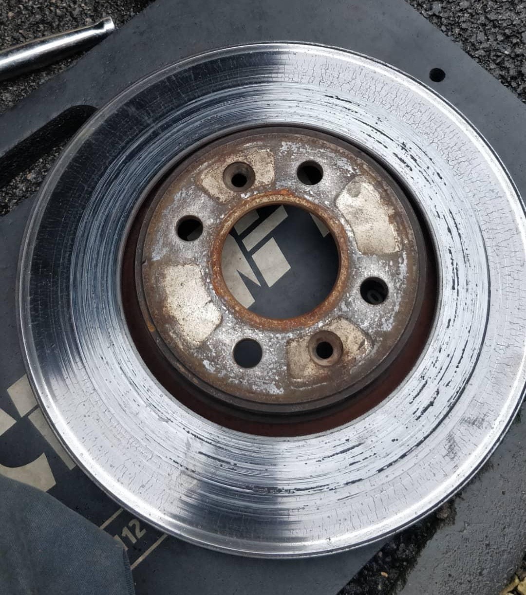

What are they like on discs Olly? A lot of metal removal? Not bothered about squeel so much, it’s more about performance, reasonable durability in terms of life and dust that doesn’t eat the wheels and bodywork.
I have pagid rs 4-2 blue on mine work fine from cold and have great pedal feel and modulation, but are quite expensive now and can't be quite noisy when pottering around, they do leave quite a bit of dust but never noticed any problems with them damaging the wheels and the paint mine were sat in a damp garage with no use for around 12 months and look and perform fine now im using them again.
I’ve only used them to and from the track as I have a road and track set of discs, but I would say they are pretty harsh on discs, more so than the PBS pads.
