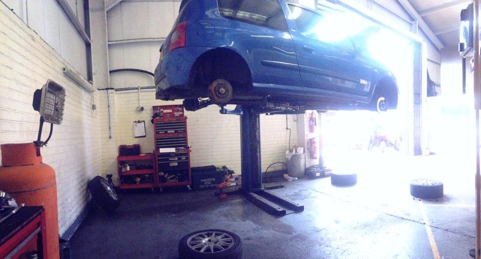

Well thanks lads for the responses. Managed to get it on the ramp for a decent poke around today for a few hours and found out why my brakes were truely shocking, the brake compensator valve linkage had snapped, therefore ruining my brake balance, but all sorted now and found out its running brembo discs and mintex pads all round so thats abit of winner :) So my problem is resolved for now. But G172 has kindly pm'd me the prices of his brakes, and i will be getting some brembo/ferodo setup within the next couple of months :)
