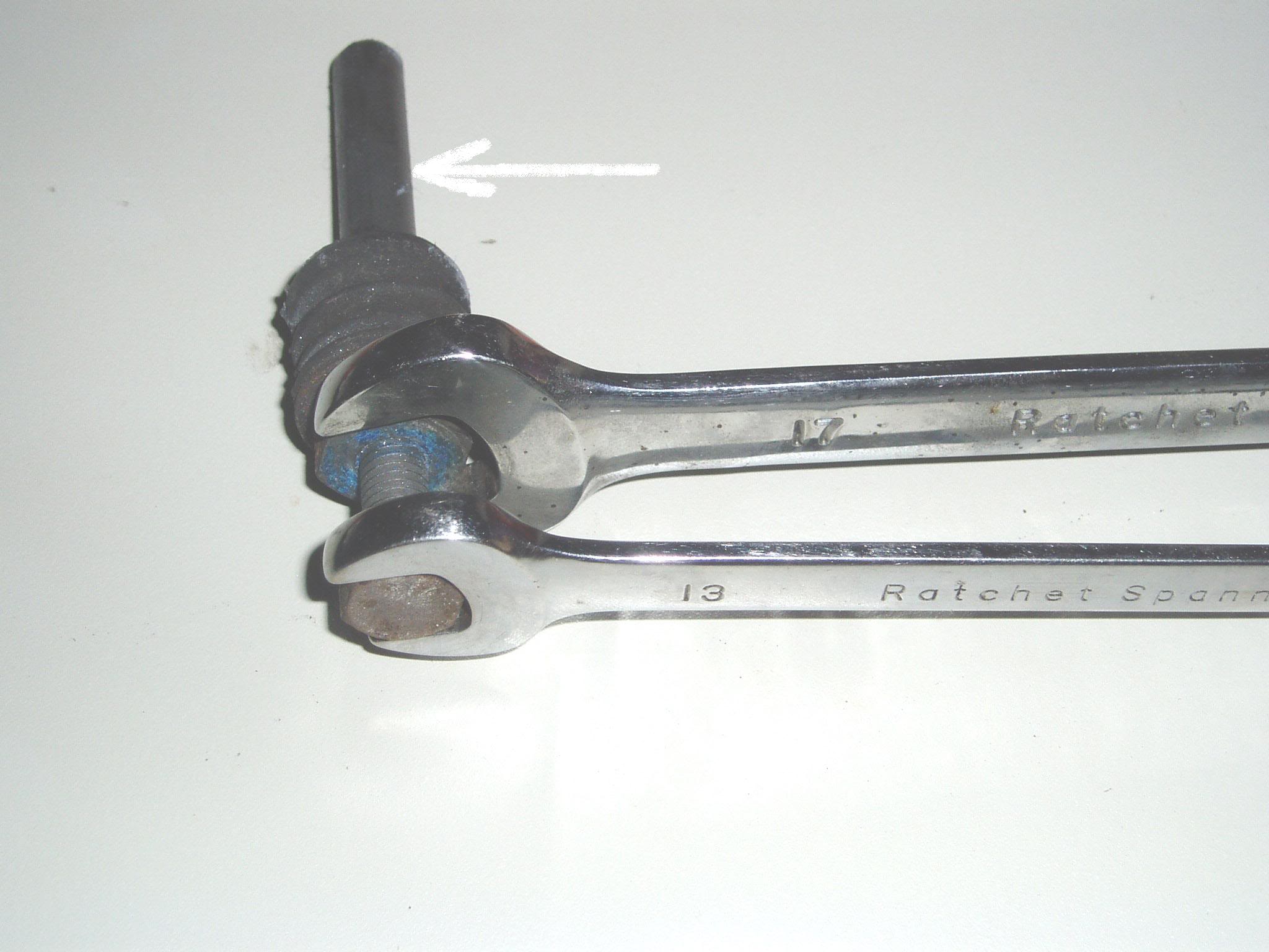

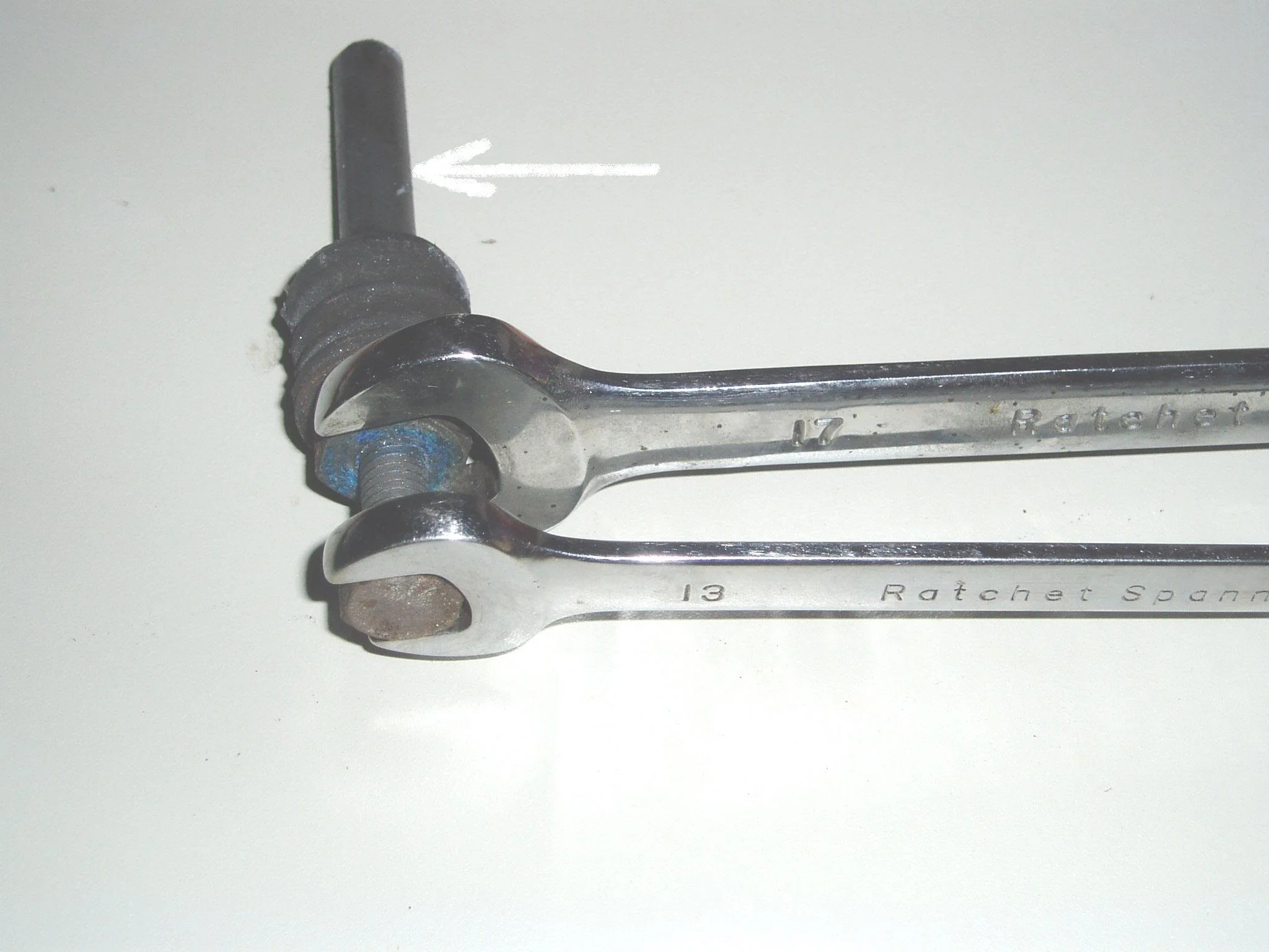

Unbolt the caliper . Usually you need a 13mm spanner and a 17mm spanner , check that the slider is not rusty , if it is , clean it up with some emery cloth and regrease it .
Check the rubber seals/gaiters for splits etc as this could be letting dirt etc get in onto the slider.
