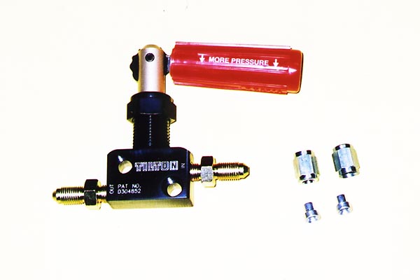

Its ok, I don't think I fully understand the system by the sound of it, I meant more pure stopping effort (total torque (front+rear))
Right, so theres already a proportioning valve taking the poke out of the rear brakes and you just replace that, while increasing its efficiency with the new adjustable valve?
But does that mean the master cylinder doesn't dictate that balance on the clio then, that would be good! The circuits are front/rear, not diagonal?
^i do a better price than k-tec ;), but as i've said previously its not necessary to upgrade the rears, i can supply if you REALLY want them
basically, in simple terms, if you ran a pipe to each corner off the master cylinder direct, each corner would receive equal force, by fitting a bias valve into the rear lines you "block" the flow of fluid to the rears in increasing amounts for less rear pressure hence reducing the braking force. the fronts always remain the same, you just adjust the rear force with the valve
