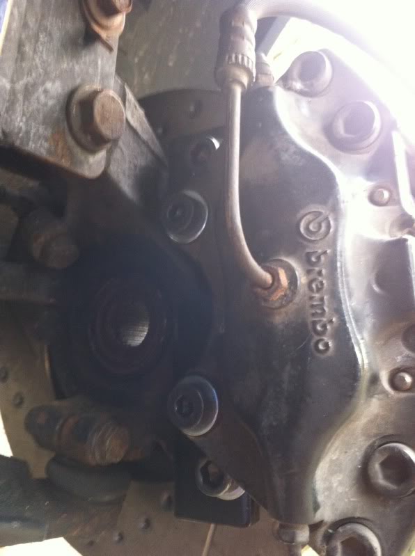

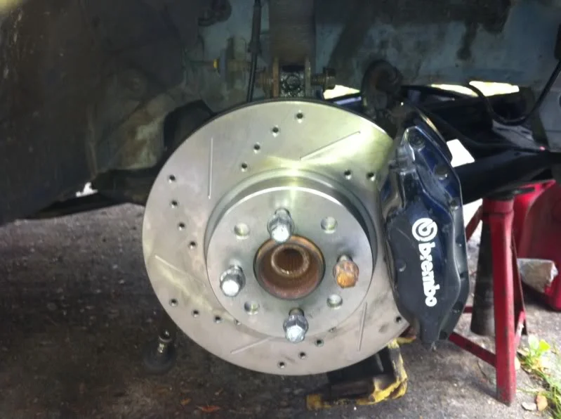

I got the 406 callipers with custom mounting brackets. Or you can get the Brembos off the 197/200
The 406 ones are good as the mounting points are so close together you can fit with just a flat bit of think plate:
With the fiat ones they wont do the same as the bolt holes are too similar (but sadly not the same) as 172 ones, only way to use them really on a 172 is if you go for really big disks so you can mount them outboard of the original lugs.

Cheers guys for the feedback...;) That's a different idea chip about a flat plate,never seen that before...! I thought you had to have some proper brackets made up...! I will keep me eye out for a pair of cheap Peugeot Brembo calipers then. Chip..any chance you have dimensions of the plate you used so I can get some from work..;) Save me some time on trial and error.. Lol...!
