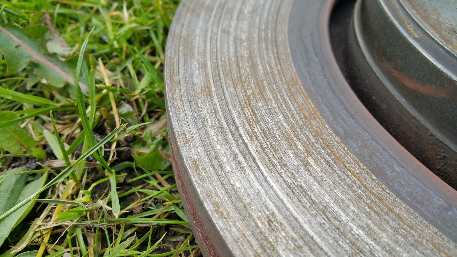

So after my MOT on Friday, i got an advisory for my front pads. Plan was to get them done in the next week or so but this has now been pushed forward to ASAP after i felt a grind under braking. This is what my driver's side disc looks like.
Needless to say, it's time for new discs and pads up front and this is where my question comes in. Despite being a 1.2, the clio is on coilovers and decent tyres so it's a hoon for my weekly commute over snake pass and i have experienced brake fade a few times. It currently has Pagid discs and pads but i wan't to try Brembo out now ecp stock them.

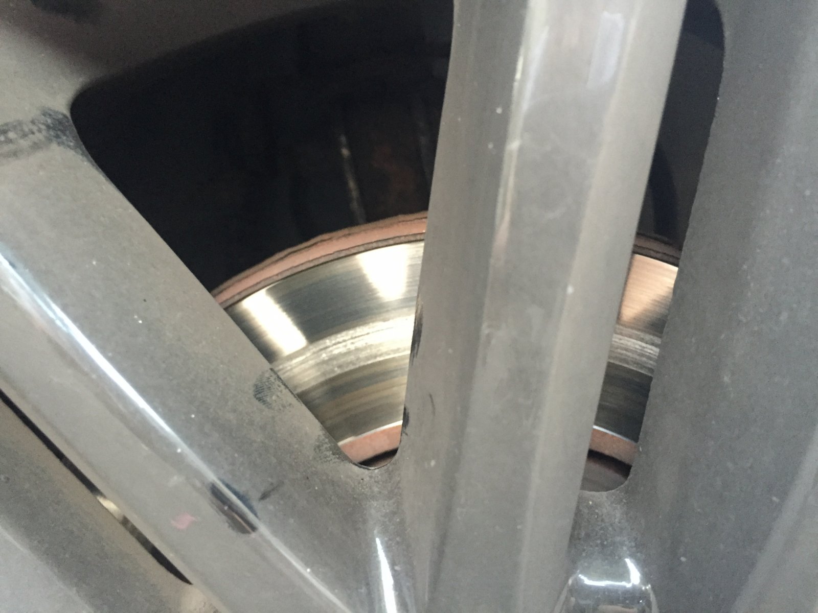

OE brembo discs and pads are no different to Pagid IMO, in fact I'd say the OE Pagid are better, if it where me I'd keep the discs unless they have a good lip on them and throw some Ferodo premier pads in there. Probably cost you £20. I scored my HC discs recently and where much, much worse that yours and they had cleaned up within a 100 miles of aggressive braking with no real inefficiency in braking whilst flattening them out.
See attached.
