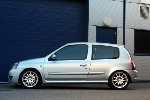

I've got an iceberg 172 and I love the colour. So much more to it than 'just' silver IMO.
Love the way the blue shines through in moody weather.

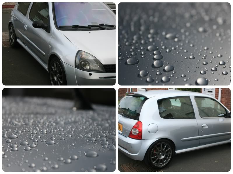

That's mine after a coat of Auto Finesse Tough Coat.

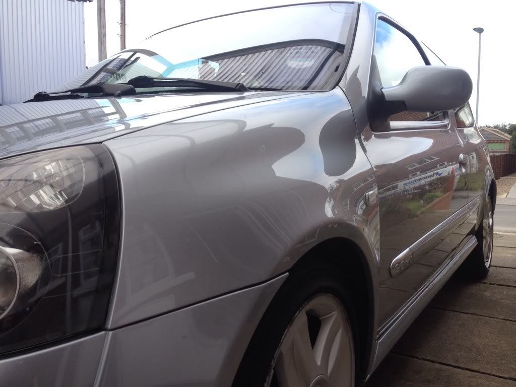

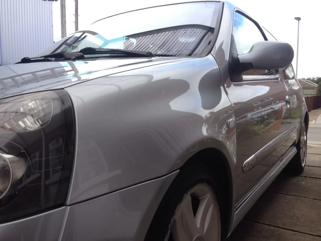

This is the finish R222 cleanser gave me before any LSP. Plus it's an iPhone pic
