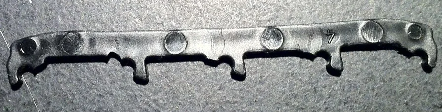

Low and behold, the one that sits horizontally has broken -
Is it possible to obtain spares of these?

Think you might be able to through renault, god knows how much they would want though. Tried giving clio spares a ring, you might have to get a whole new vent as im not sure if their meant to pull apart.

Trying to source one from here, been whoring the car parts section!
