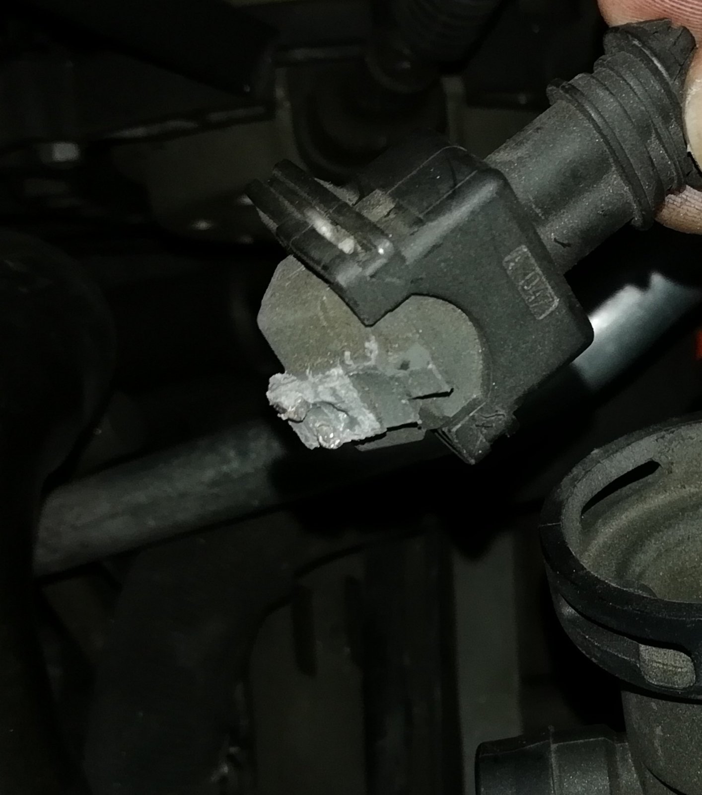

What a shi**er of a day (n) had nothing but car trouble today, here is the latest balls up.
I took the fuel rail guard to gain better access to the oil filter in order to change the oil.
I was super careful or so I thought and I only realised something was amiss when I went to start the car, misfiring and basically knew straight away it wasn't right.
I looked in the engine bay and seen this dangling in mid air, well cheesed off!
Is this knackered? I tried connecting it back up but there was nothing to hold it, guessing the plug has snapped off?
I actually read that theead and was chuckling to myself... not now I'm not!
I did that recently, not that bad though, just cracked it....
Best get a new one.
Probably more to do with the plastic going brittle
I must of caught it unknowingly when getting the oil filter off, what a place to put it.
Anyone know the best place to get one from? guessing no chance from a shop on a Sunday. PITA.
Magneti Marelli IWP042 Pico Injector, are these the ones? found them for £28 delivered tomorrow.
