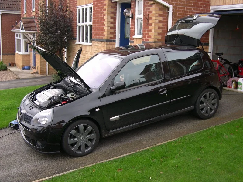

So, we start by winding back to Autumn 2004 - my brother had just bought his other half a 172, and having been initially sceptical about this little french thing, had a go, and was hooked but the combination of a turn of speed, lovely handling and also lots of kit for such a small car! My then wife-to-be at the time was driving a bog-basic 2000 1.0 Corsa which had been a great reliable little car, but the clio was proving very appealing. So I started with the man-maths, and by late October, were the proud owners of a black gold clio 182 with the cup suspension and spoiler packs. This was bought right when the car supermarkets were getting a foothold with their parallel imports, and we ended up buying from Motorpoint at £11,699, compared to a Renault list of just under £15k - and the local dealership weren't willing to knock a penny off, despite motorpoint being only 1/2 mile away!
So, when it turned up, it looked like this, all shiny and new (it was, I believe, sourced through Cyprus, but brand new with 17 miles on, and we were the first owners).

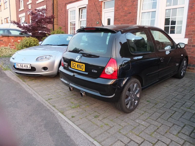

All was going well, and it was being well used, and then by spring 2006, I had bought myself a Cupra R to keep it company on the drive!
And thought I'd get a plate for the clio to make a decent (but not mega-bucks!) pair

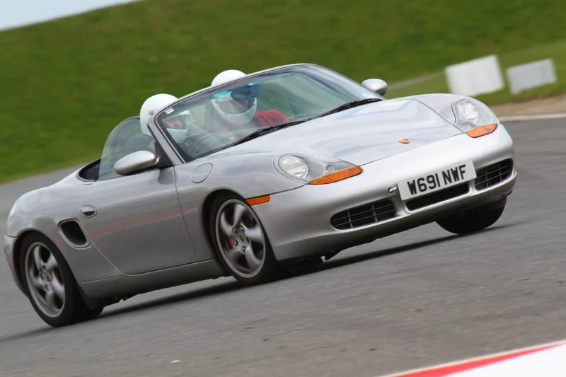

which was all good, until I decided I fancied doing some more trackdays decided that the boxster was ok, but I wanted something a little more playful, and also cheaper on consumables!
so it was back to what I knew, and in summer 2012, the Boxster was replaced, with the Clio hitting the dizzy heights of 40,000 miles by this stage, and still going fine!:

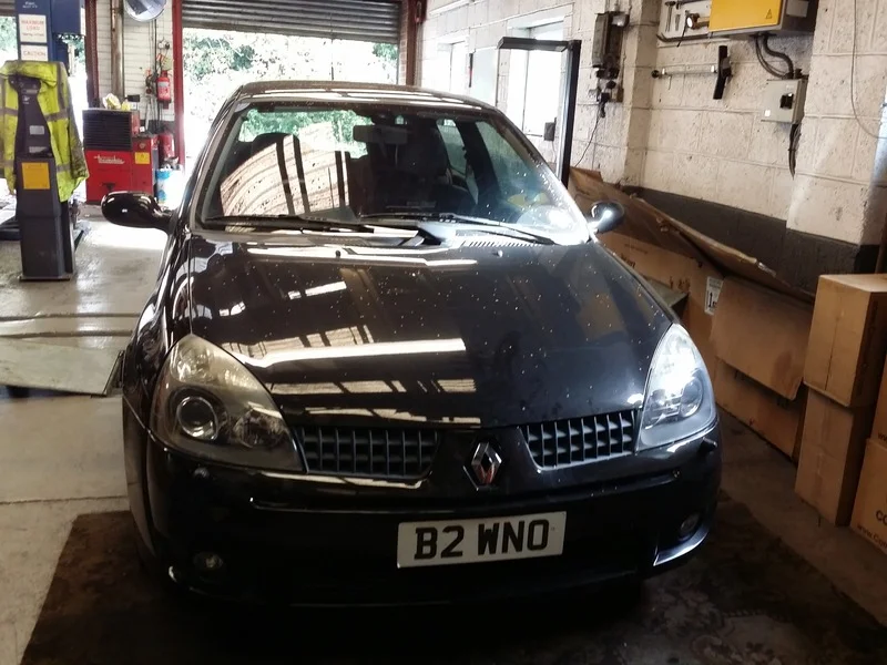

It went through the MOT, having just ticked over to 50,044 miles with no issues, and all was good - so I went off for a business trip to Asia happy that all was well with the world... until I got a phonecall on week 1 of a 3 week trip that my wife had been out and about, and had been bumped from behind in the Clio! My wife was all ok, and the other guy (in a Kia Sorrento) was all insured, and happy to let the claim go through his insurers, so that was ok, but what about the car? My wife sent me pictures, and got it checked at the garage, and it looked like just a light and a cracked bumper, so that's all ok...

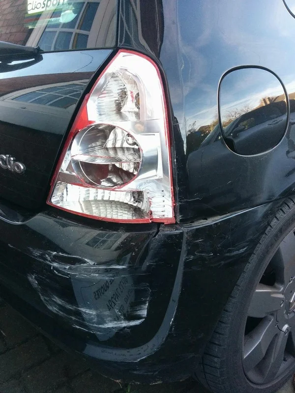

So, our insurance company were called, and the car taken away to be assessed and repaired... until a couple of days later the call came, that it had been assessed that it was an uneconomical repair. So obviously, we were a little surprised at this, and did wonder if there was hidden damage, but accepted the verdict, but immediately asked for the car to be returned as we would like to buy it back (if nothing else, I was thinking of a new track car!). So with the car back to us, we then waited for discussions on values. I assumed that we would be in for a fight, due to the relatively minor damage, but actually the first offer that came back was actually very reasonable, and pretty much what I would have been looking to argue them up to. So we agreed a settlement, and the car was ours for a charge of just under 20% of the settlement (and classed as a Cat D) - now what to do next! I would say thought that insurance company have been good through the whole process, and handled everything smoothly throughout - I know we see varying reviews of the "nautical" insurers sometimes, but I can't fault them.

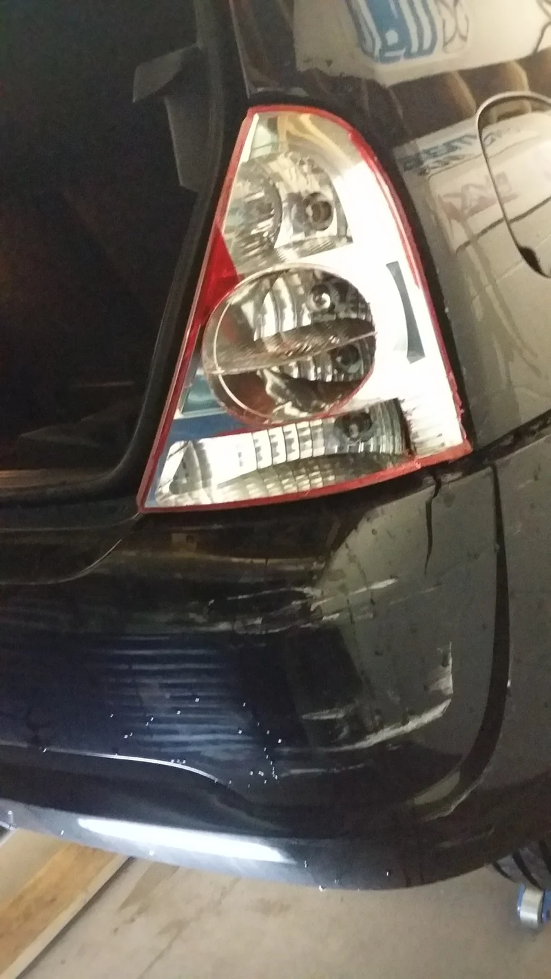

Obviously, before we had even settled, I was off to Ebay looking for the bits I might need and had pre-emptively ordered a pair of tail lights and managed to snag a bumper in the right colour - so I thought that would get us started and I would see what lay beneath the surface. So, with the settlement agreed, it was time to get it in the garage and get it stripped down...

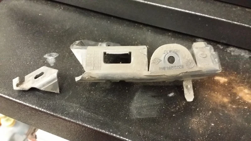

Stripping off the bumper and light revealed that actually all was pretty much fine beneath the surface - there was one locating tab on the light that had got slightly bent and needed straightening, and a plastic bracket on the bumper had snapped, but other than that it all looked structurally sound - Result!
Unfortunately, the new bumper was missing the bracket, so I plastic welded that for now until I can get a new one, but then started building it up to see if everything would line up ok...
Light all went on ok... how about the bumper?
I would call that a result - all fixed for £85 of used parts, so then to satisfy the insurance company that it had been repaired it went off for it's second MOT in 6 weeks, having only covered 138 miles since the last one, and funnily enough passed without any issues.

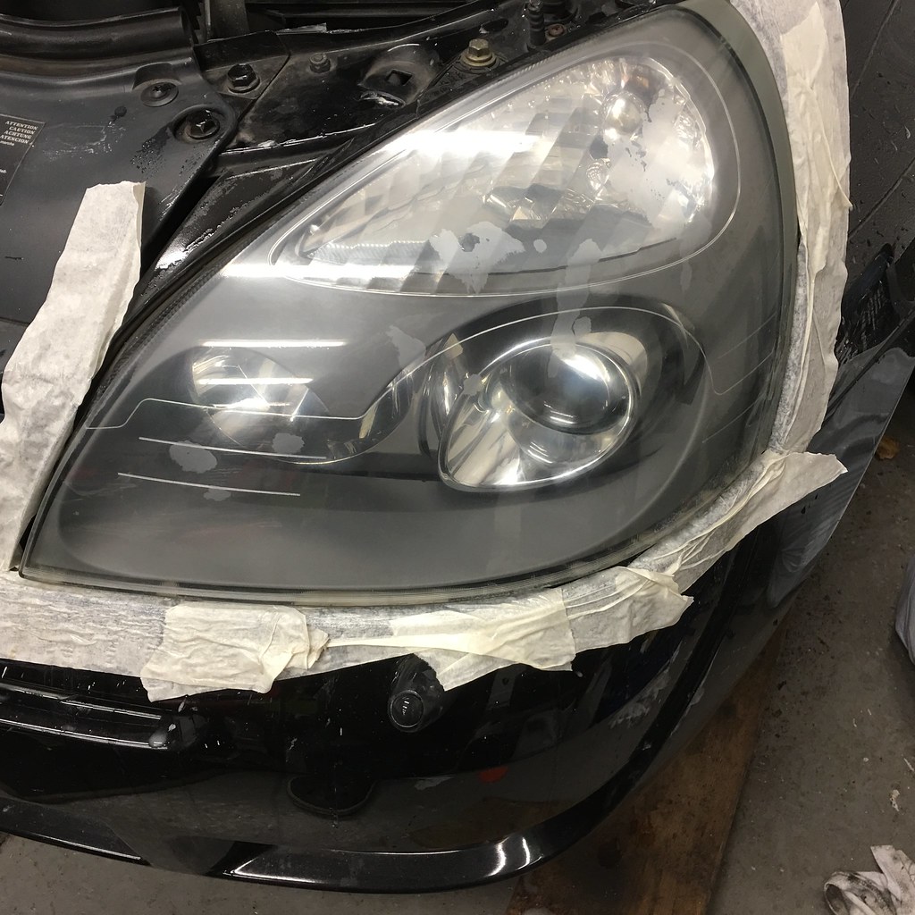

I also treated the lights to a good clean-up as they were getting very hazy:

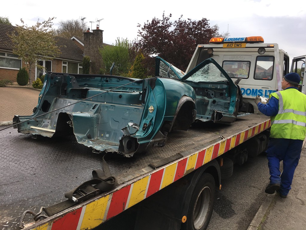

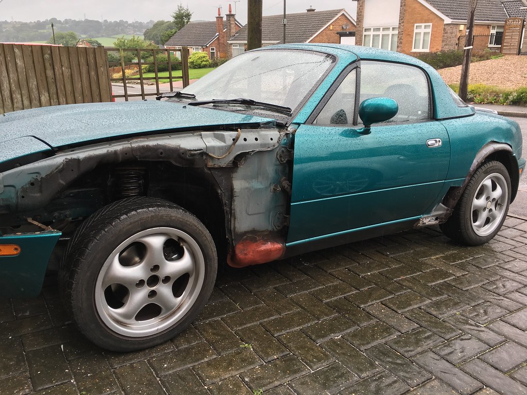

bought another MX5 (to go alongside the mk3) from a colleague that was rusty - with the initial plan of a restoration - but after some chopping, I have got a little more brutal!
Untitled on Flickr
Untitled on Flickr
Untitled on Flickr
Which is looking more car-like (but differently shaped!) - and now approaching IVA test... (now a MEV Exocet - which after IVA will likely gain a turbo - aiming for ca. 250BHP in somewhere around 650Kg).

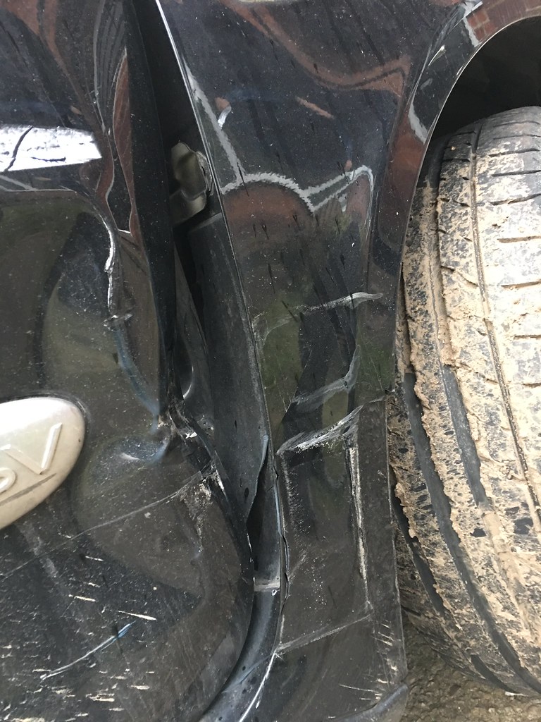

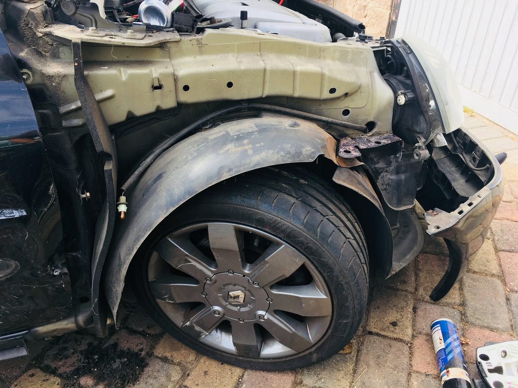

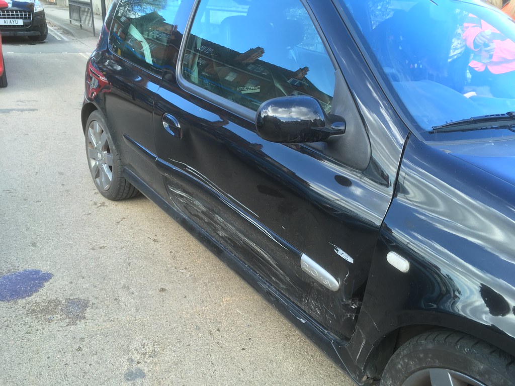

So, back to the clio, and we are back once more where I was 2 years ago. My wife was driving though a green light and was hit from the side by someone that had come through a red (having mistaken a green filter for his light). The car has a crumpled wing and door and bent track rod - and so is once again back in the hands of the insurers.
Untitled on Flickr
Untitled on Flickr
Untitled on Flickr
This time, we have bought a new car for my wife (picking up an Evoque on Friday), so I get the 182 - which I have today agreed a payment for and have retained the car (for £417, I couldn't not do, really!). Since the golf (potentially) goes back in July, I have a bit of time to repair and give the clio a bit of a makeover before I am going to put it back into service.
I have got the track rod ready to replace, and am on the lookout for a wing and door (I would like panels that are original paint if possible, as I figure it might match best). In the meantime, I was a little impulsive last night and have bought myself some trophy wheels, which I think will look good - once the car is sorted again!

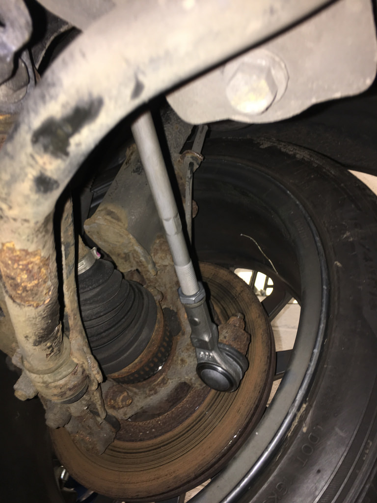

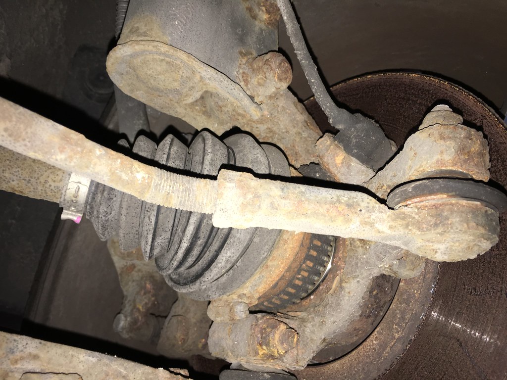

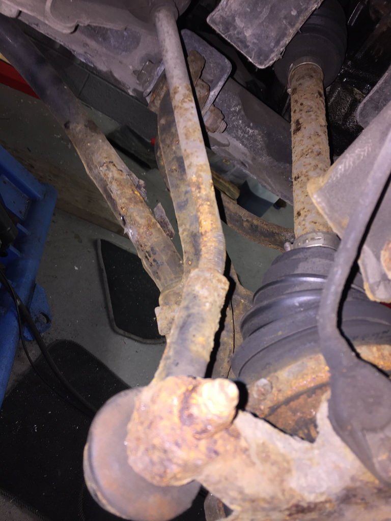

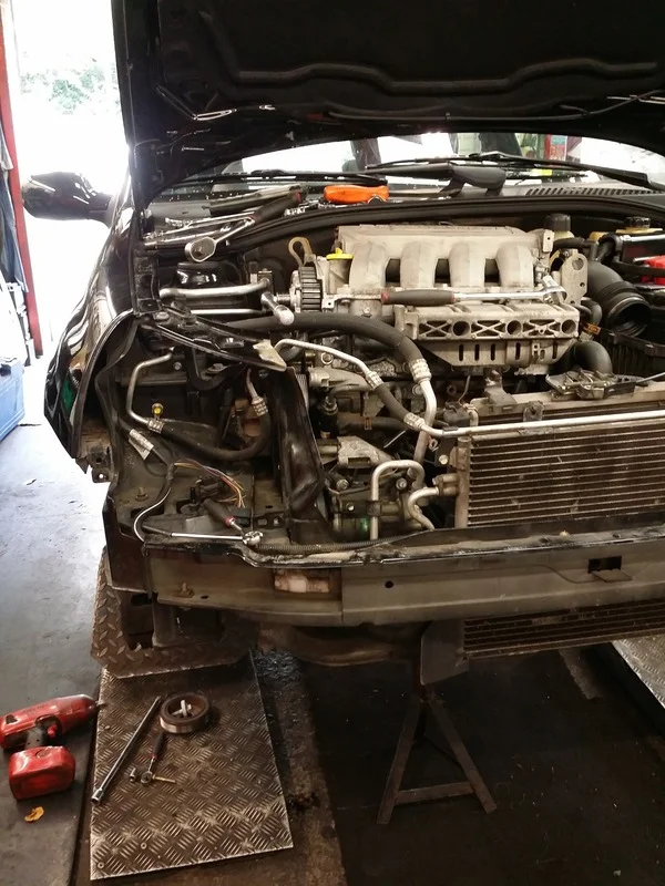

First job was to get the car on my ramp and take a look at the tie rod and track rod end... which was fairly well bent!
Untitled on Flickr
all replaced with shiny new bits, which meant the wheels are pointing in a more similar direction to each other!

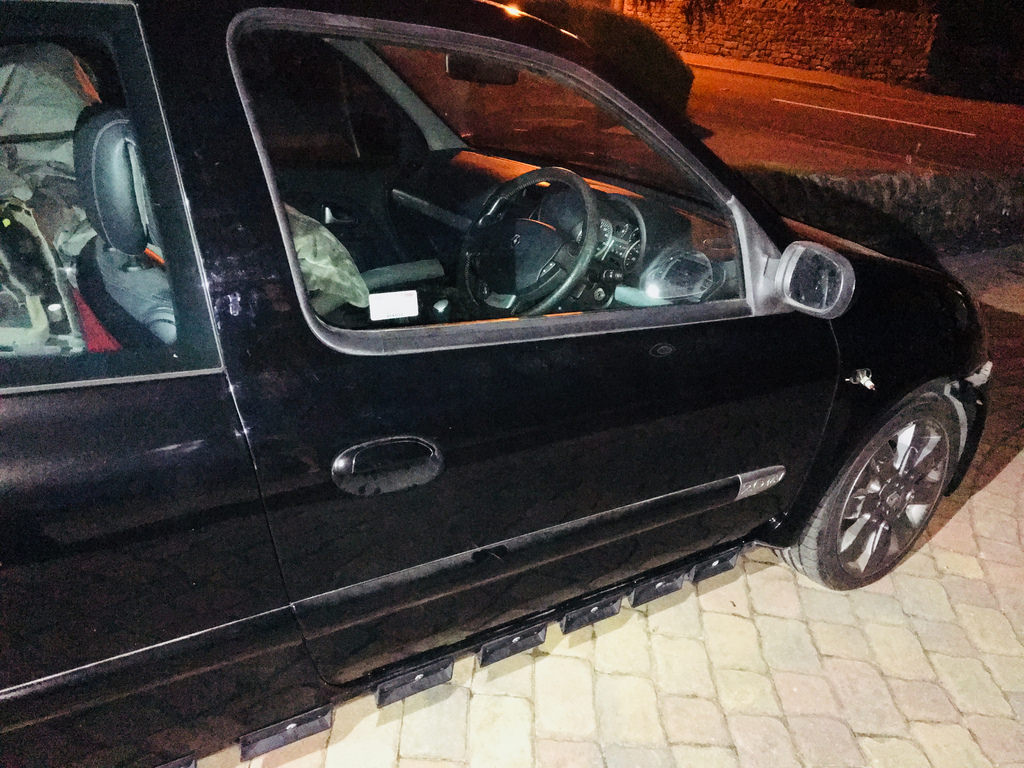

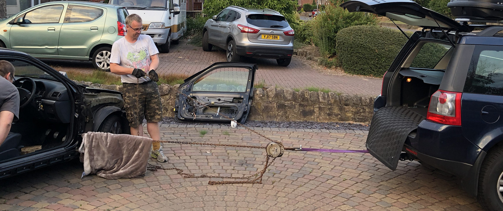

Unfortunately, when I first tried the replacement doors (both of them!), they didn't fit properly - and with a closer look, and a compare to my brother's cup, we could see that the lower hinge had been knocked in the impact - as the other car had slid along the door it had pushed the hinge back. So we thought we would try some delicate persuasion to massage it back into line - by use of my mate's Land Rover, a block and tackle and some kevlar sailing rope through the hinge pin hole.
Untitled on Flickr
After a few attempts at pulling with slight adjustments in direction, the good news was that the door would now fit and close, but wasn't well aligned (with a big gap at the front, and tight at the back), so needed some more adjustment. So, with the help of a bit of wood and grips and some adjustment of the striker, I managed to greatly improve the fit - it's still not 100%, but is a lot better than it was, and I am going to get it perfected by a local bodyshop once I have it all built up and sorted.
Untitled on Flickr
So after a bit more building up (including a good clean out under the side skirts both sides - amazing how much crud was in there) it looked reasonably decent.

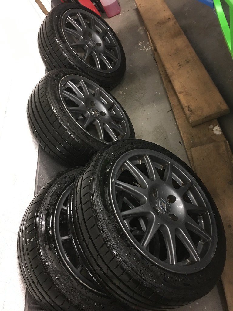

Which meant that I had to then swap the wheels and drop on my turinis, which I am happy with:
