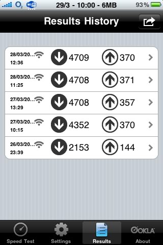

Now firstly I decided to actually remove the bell wire physically from my master socket...left it for over a week and saw no improvement :( So bought the Iplate home...put that on, reset the Router and bosh....
Now up to 4.7 ish meg. Whats interesting is that there is bugger all in the Iplate bar a couple of inductors to remove the noise from the bell wire so removing it from the back of the master-socket should in theory have the same effect..but it didn't. Have been running with this now for over a week without a drop in speed so im quite impressed. I thought they were a gimmick and whilst they don't help EVERYONE it certainly seems to help my line. Now I just wish they would install an ADSL 2+ DSLAM in my local exchange so I can get higher!

Nah that bit got taken out. Went and bought an IPlate from Maplins. Improved by 1.5mb :D
