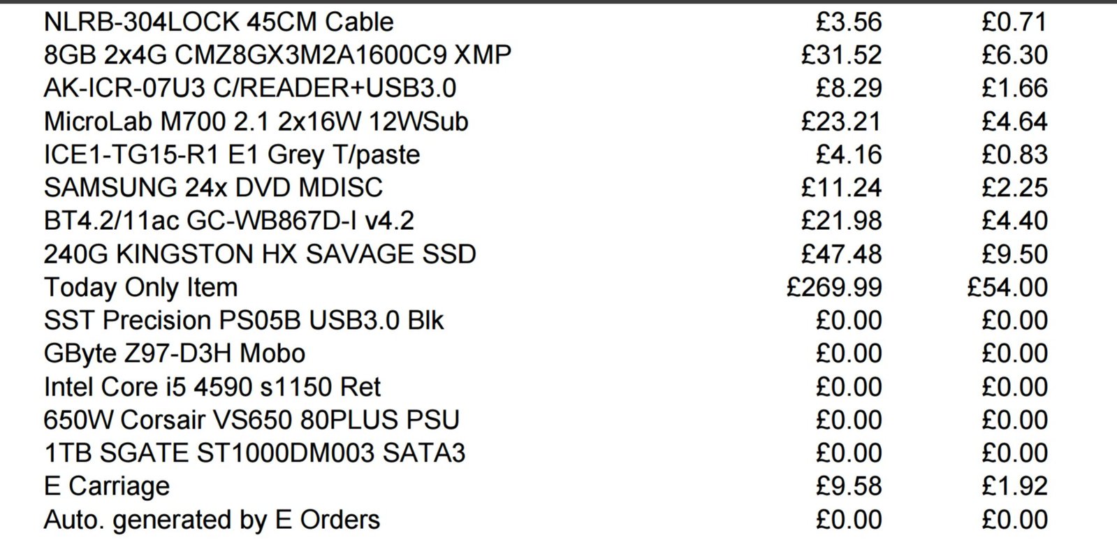

Aye, I've had loads off scan... And low and behold just ordered a PC from them.
Today's deal bundle with the i5 4590 and z97 d3h Gigabyte Mobo.
With everything I wanted, SSD, HDD, WiFi PCI card, dvd, RAM and some 2.1 speakers for him... 500 bang on. (Loads of little bits with it too)
He's getting a cracking machine too, I'll plink w7 on it for him and let him choose if he wants w10.
I can also plonk him Office 16 on it (10 quid through ex-work) and away he goes :)

Ordered it all Sunday, arrived today, got home at 5:30pm - now just doing all the updates and awaiting W10 request.
Cracking machine. Fecking large though lol
