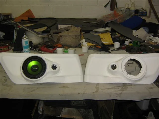

Well I took the task on in the 172. Decided against Pods. But instead, a bit extreme, built mdf rings for the speakers and mounted direct to the door metal, then cut out the door card inside to accomodate. You would never know :p
Otherwise ask Hydeho, as he has done door pods :)
Edit:
Also check out TalkAudio forums, found alot of info from there, muz from here is on there and has done some too.

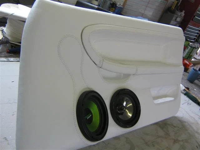

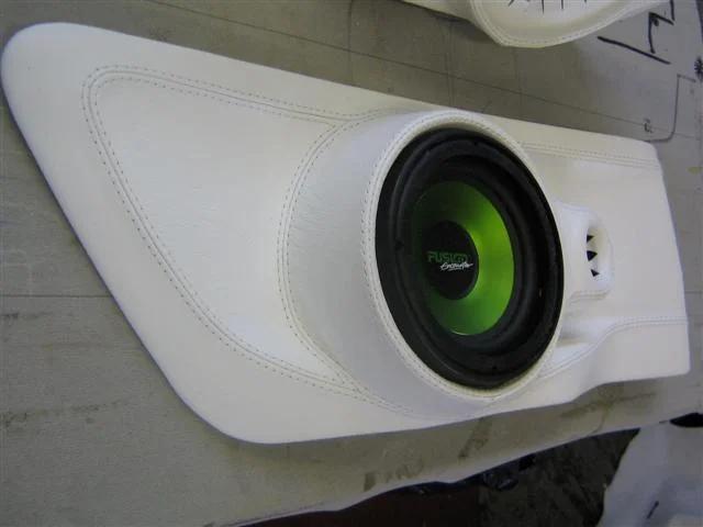

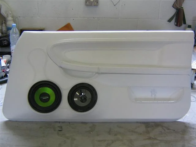

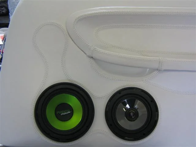

Here's what I put together >
I never actually finished them I just went down the mdf spacer route. They weren't difficult just a little time consuming. You just need resin, hardener, and fibreglass (mdf is always useful too). All the items needed can be bought from http://www.cfsnet.co.uk/acatalog/
