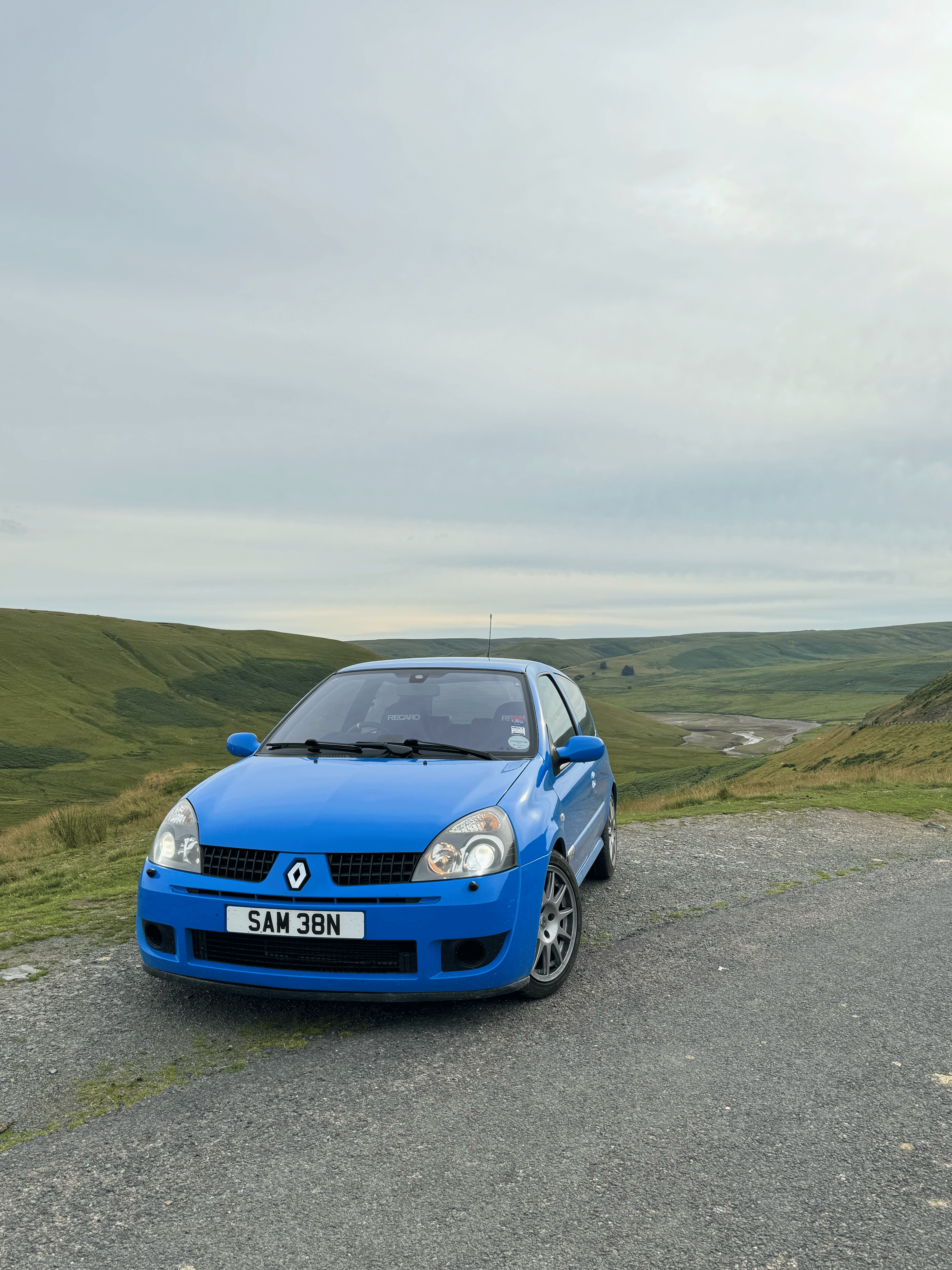

I might give the ride height a check, but when I set it a couple of years back it was quite high on the struts. You can see in the pic below that it's fairly sensible, height-wise.
