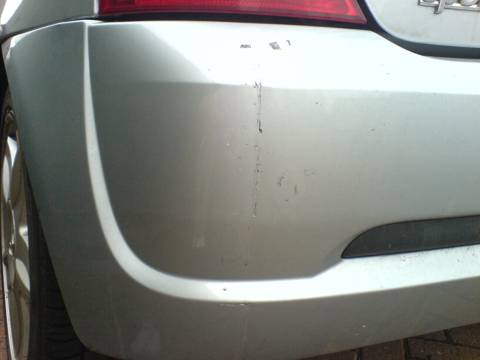

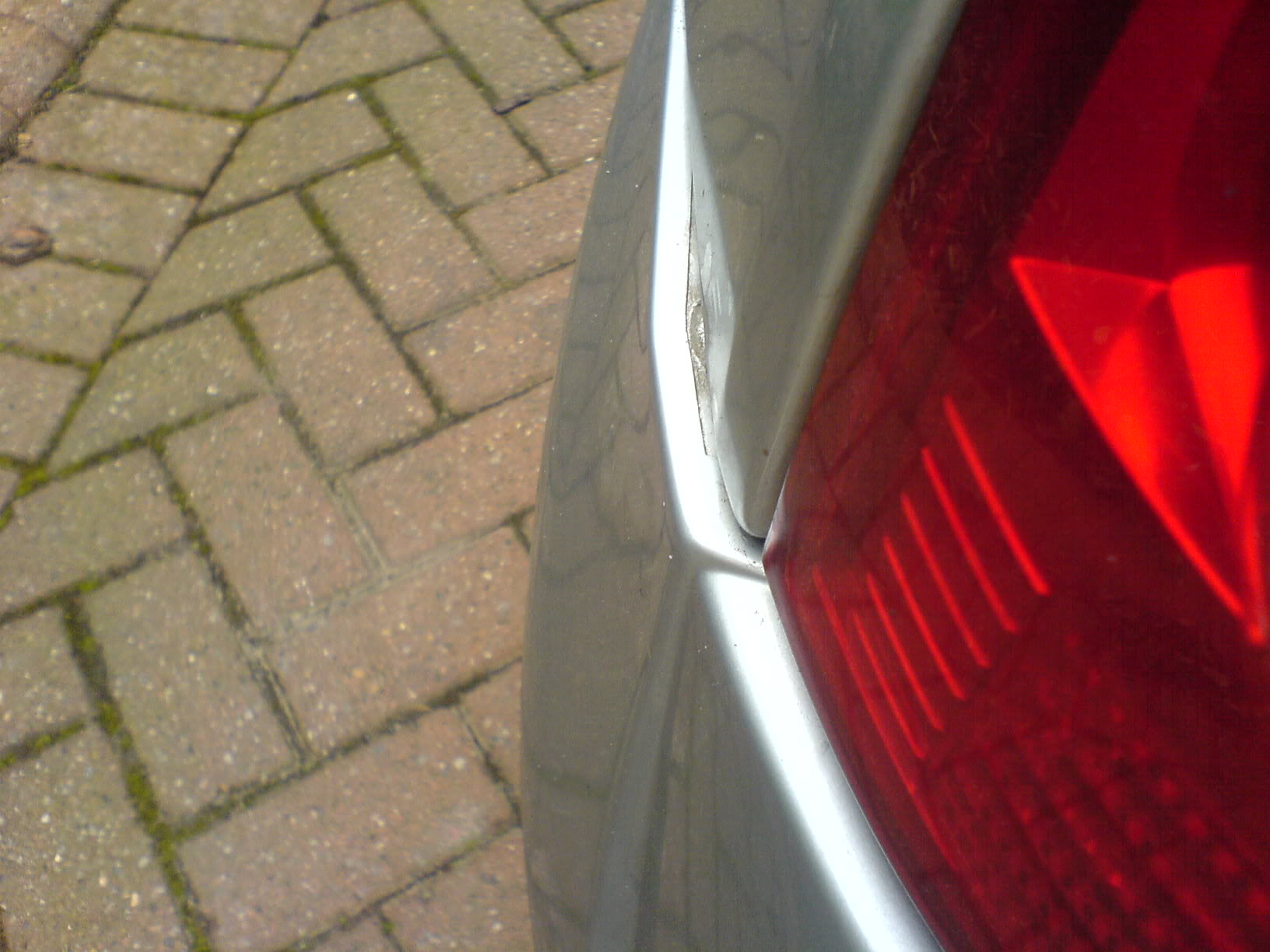

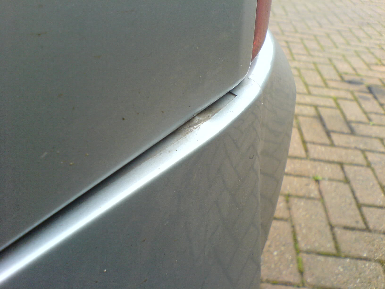

Well this morning rushing my girlfriend to work, i managed to crunch the corner of my bumper on the corner of driveway wall. The result is a scar verticalled down the bumper and its also creased on the left behind the wheel where it meets the rear wing. Luckily theres no damage to my wing/arch and its purely the bumper.

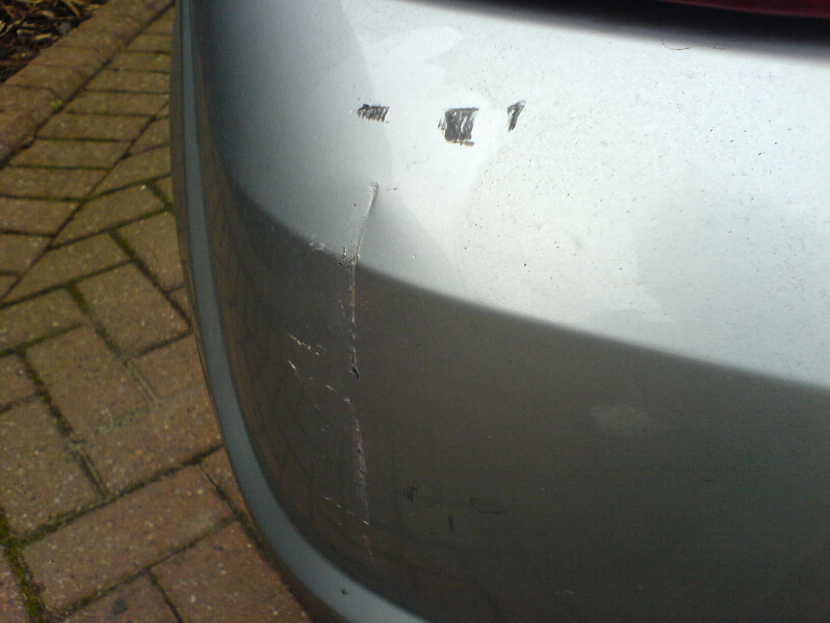

No mate, its the picture angle. Its actually the bumper that is 'bent' the 4th picture is the same area from reverse angle. Its just where the bumper sweeps around the side, but im guessing theres a retainer clip behind it and its folded around that point.

the actual slight indent and scratch will just be prepped and fillered, primed and sprayed, the part where it sticks out to the tailgate along the edge will need to be heated up with hot ait gun or heater, pushed back into place and left to cool down, easier with bumper off
