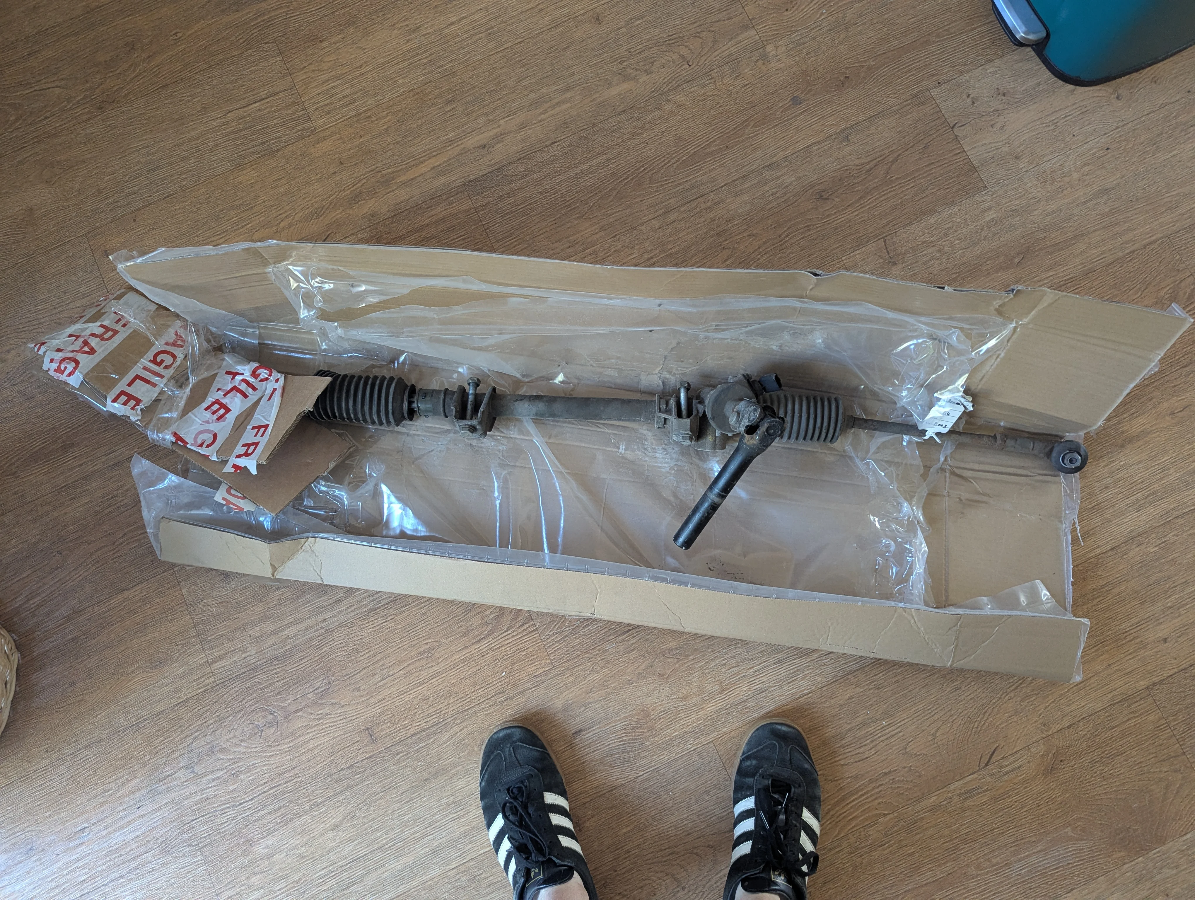

2.5 turns lock to lock DCI rack. Not completely sold on EPAS but had to snap this up while I could. If I was to go EPAS I wouldn't use a controller but wire it into the RPM/speed signals. My daily is a 1.2 and I really don't mind the EPAS feel (although HPAS does feel better).
INB4 throw it all in the bin; it's a road car and I like comfort. And part of that comfort is not having HPAS problems - plus tidy up the bay.
f**k off the PAS pump and the tensioner and do this:
It's a good plan, maybe one day it will happen. I chuck anything I take off in a box so can always be reverted.
Dci rack is good if going epas. I hated the dead spot in the centre the torsion bar gives on looped hpas rack, and bonus of solid mounts on the dci rack instead of the oem bushes.
Wiring in the epas ecu to see speed and rpm is absolutely the way forward👌

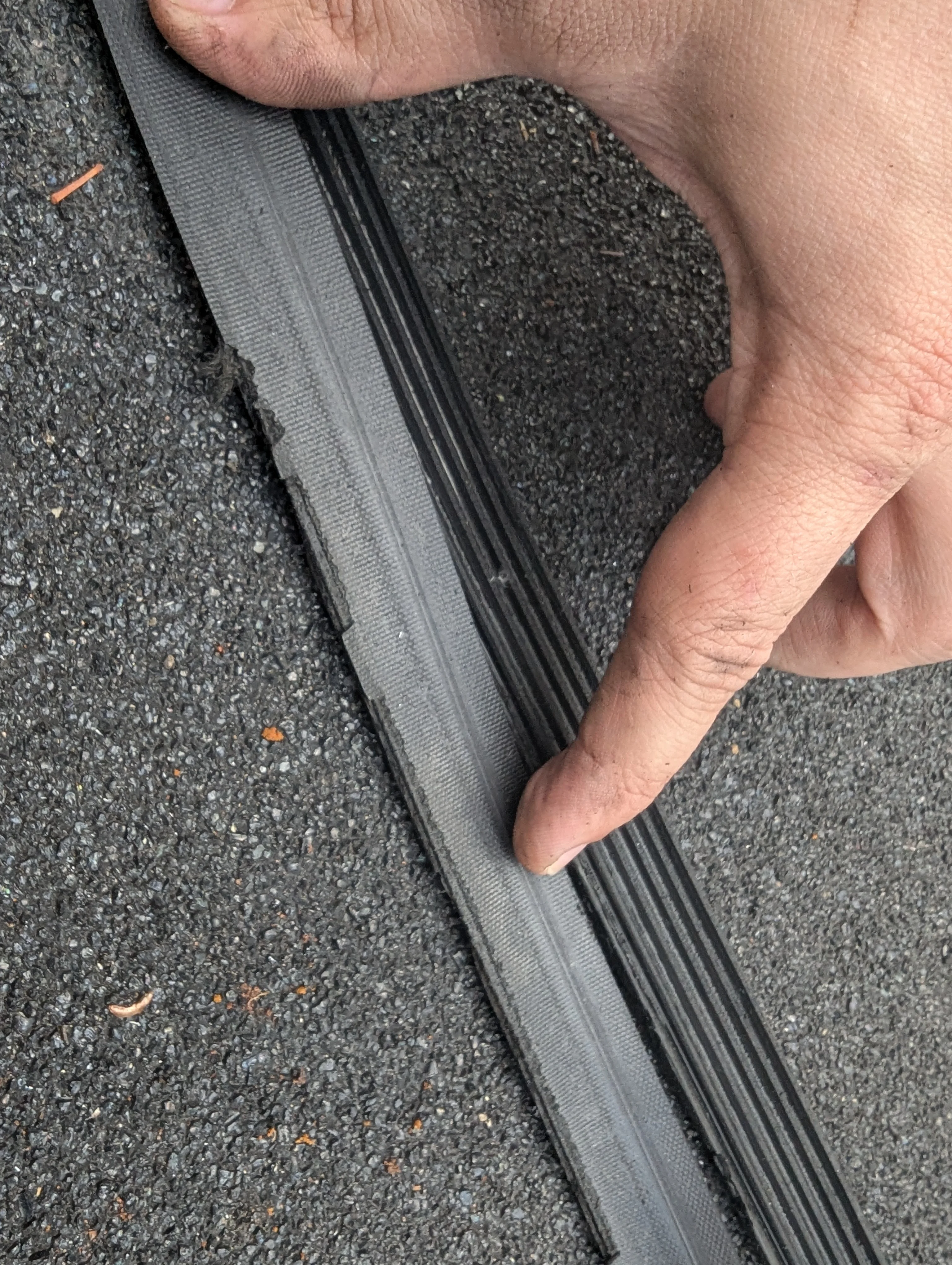

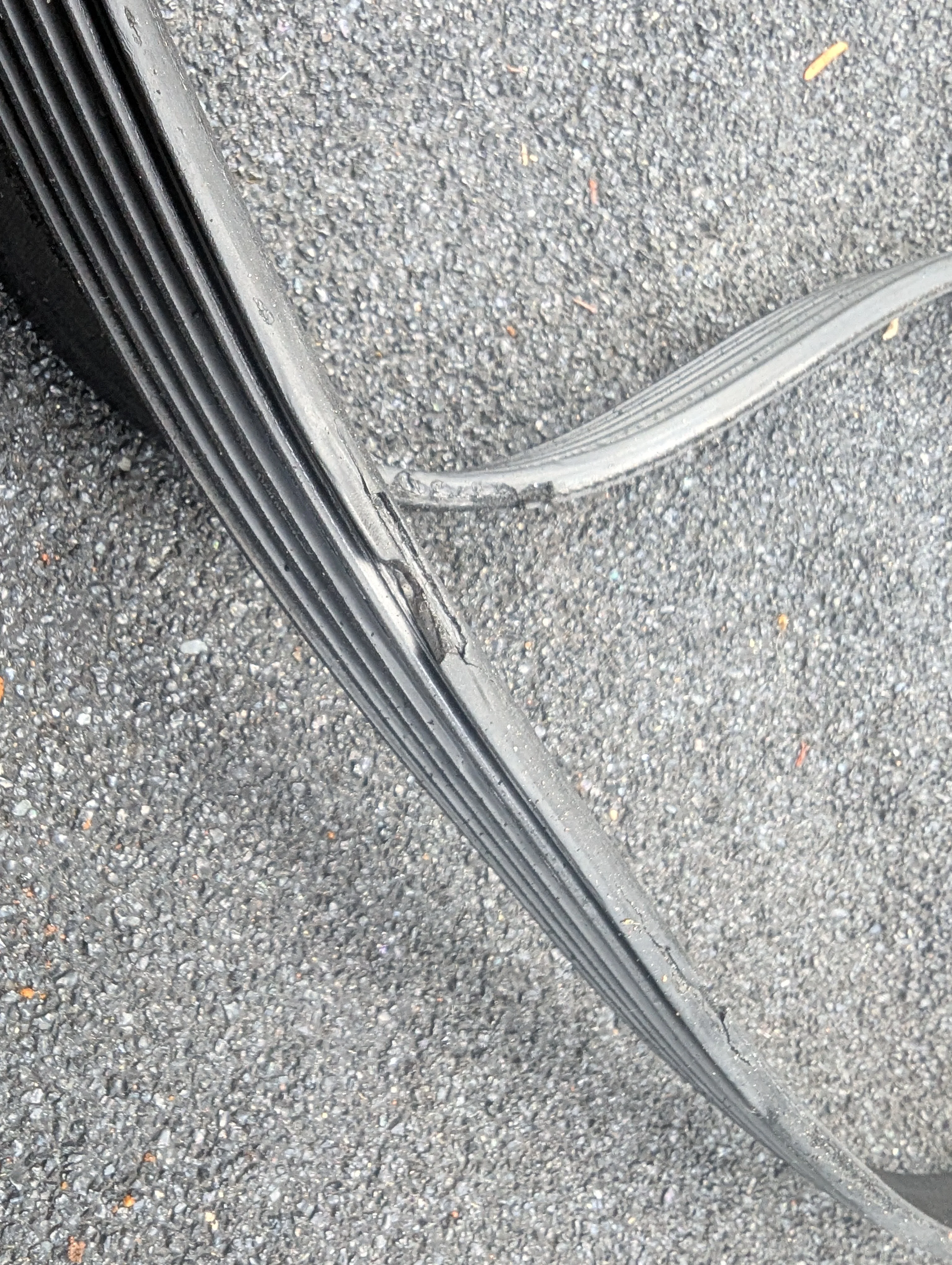

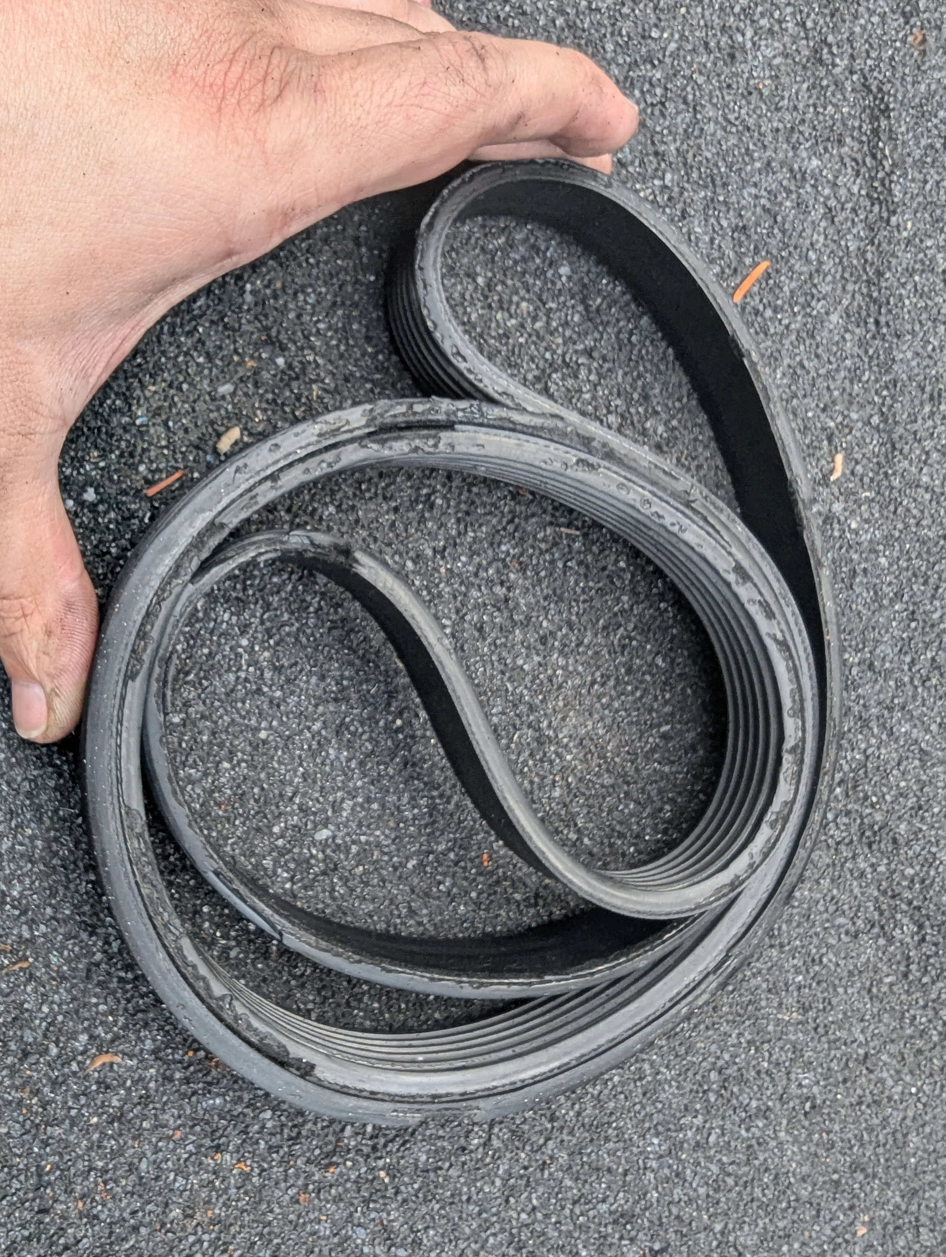

I tried FetLife for belt experts but they redirected me here.

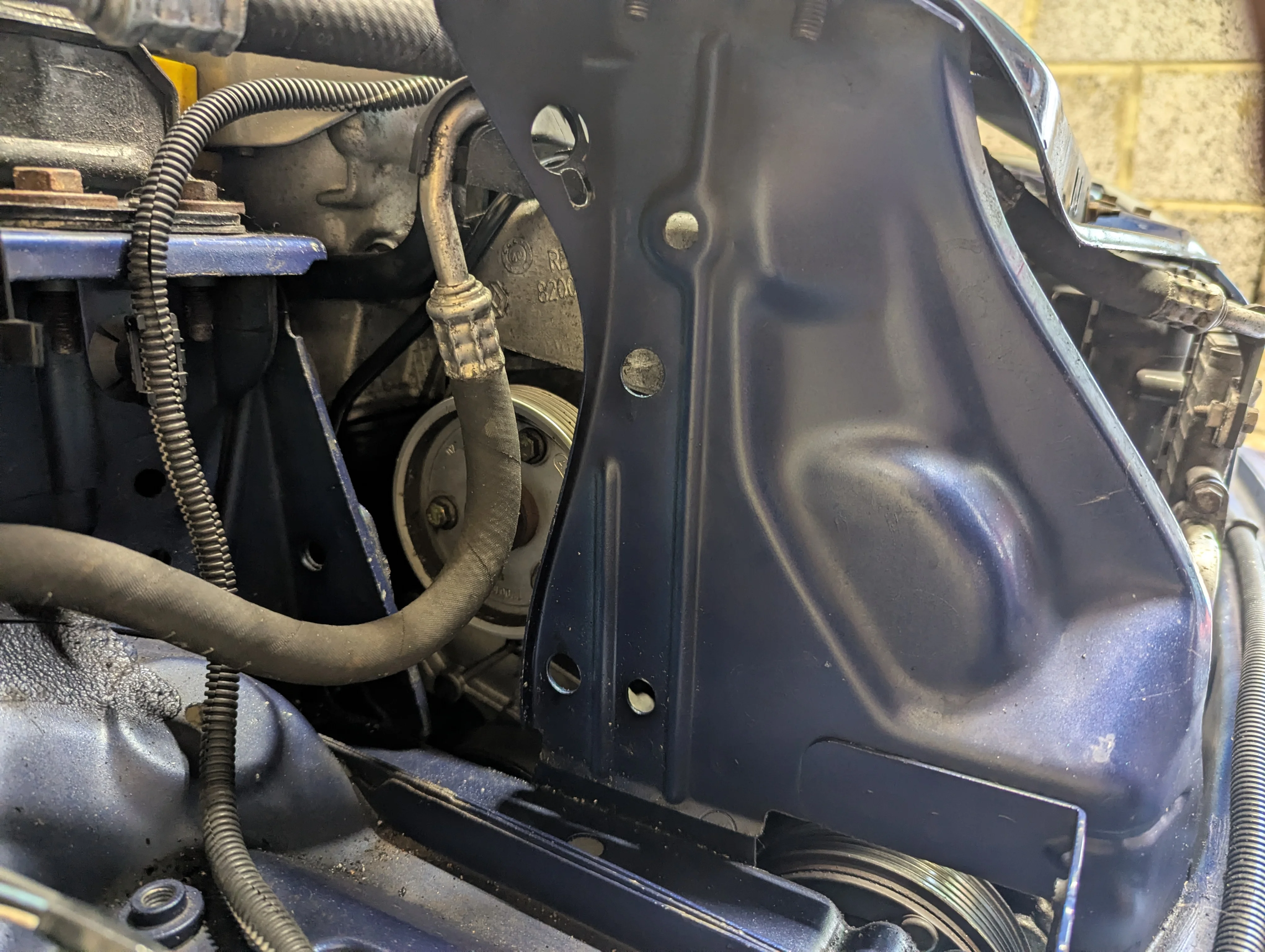

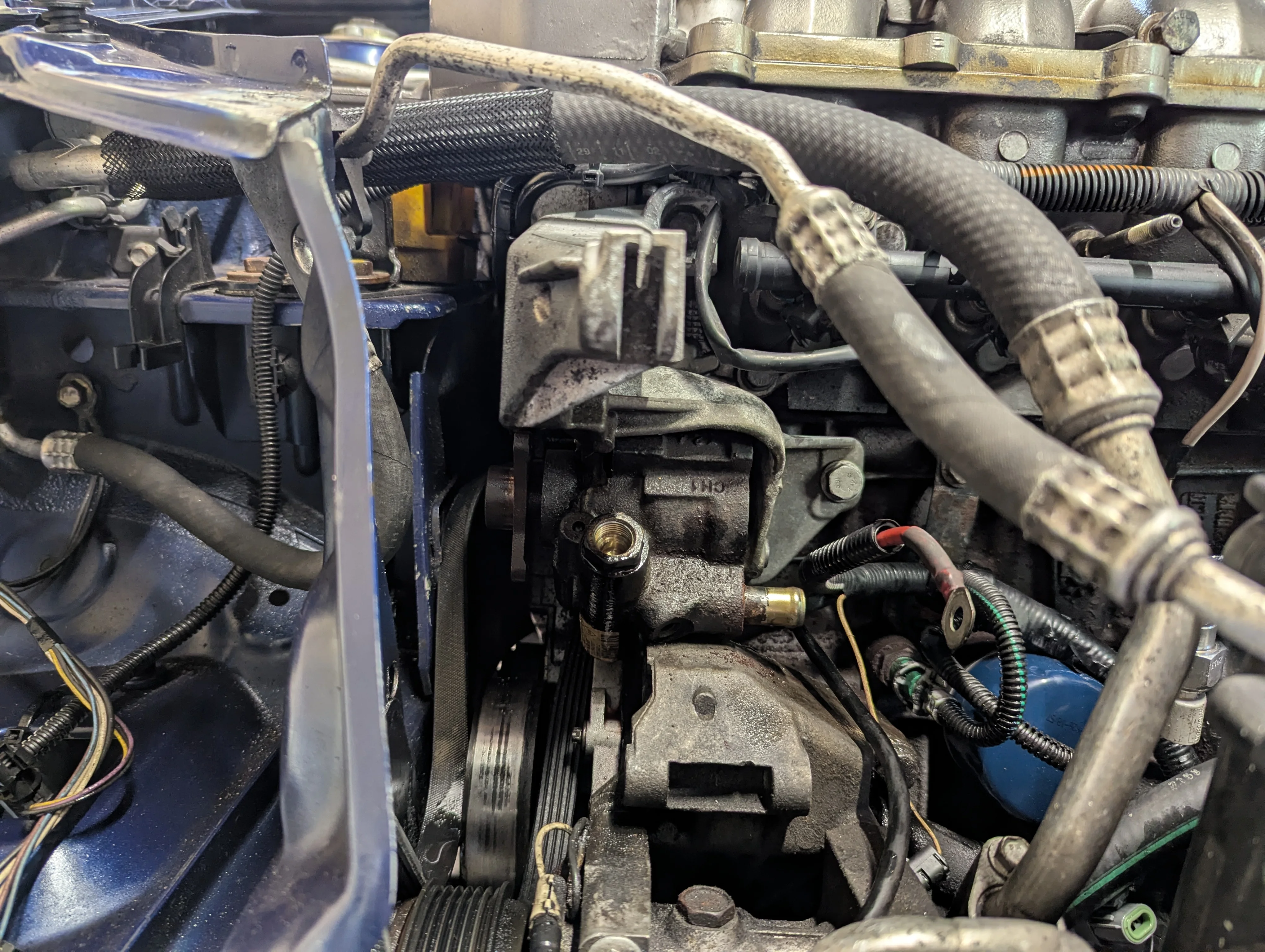

Pulleys all in line and no obvious damage, PAS pump and tensioner idler have slight movement to them.
My spare PAS pump also seems to have this movement, waiting on replacement tensioner to check that.
To me it seems the belt is at the end of its life or the tensioner is seizing (or both) but I haven't got it off to check yet - but I'm no expert.

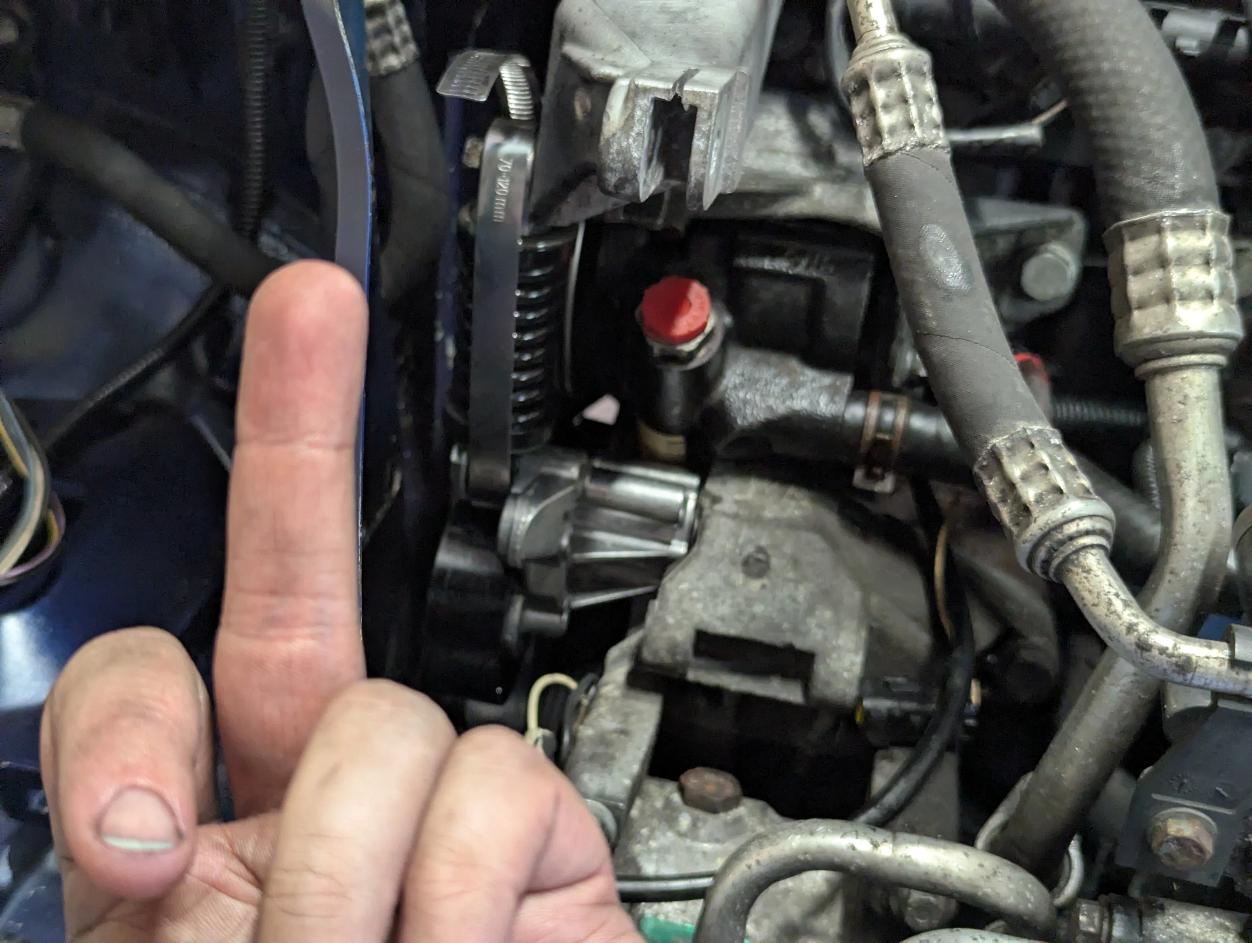

Tensioner doesn't seem seized, but there is rubbing on the spring so it needs to go. Out with the old and in with the new.

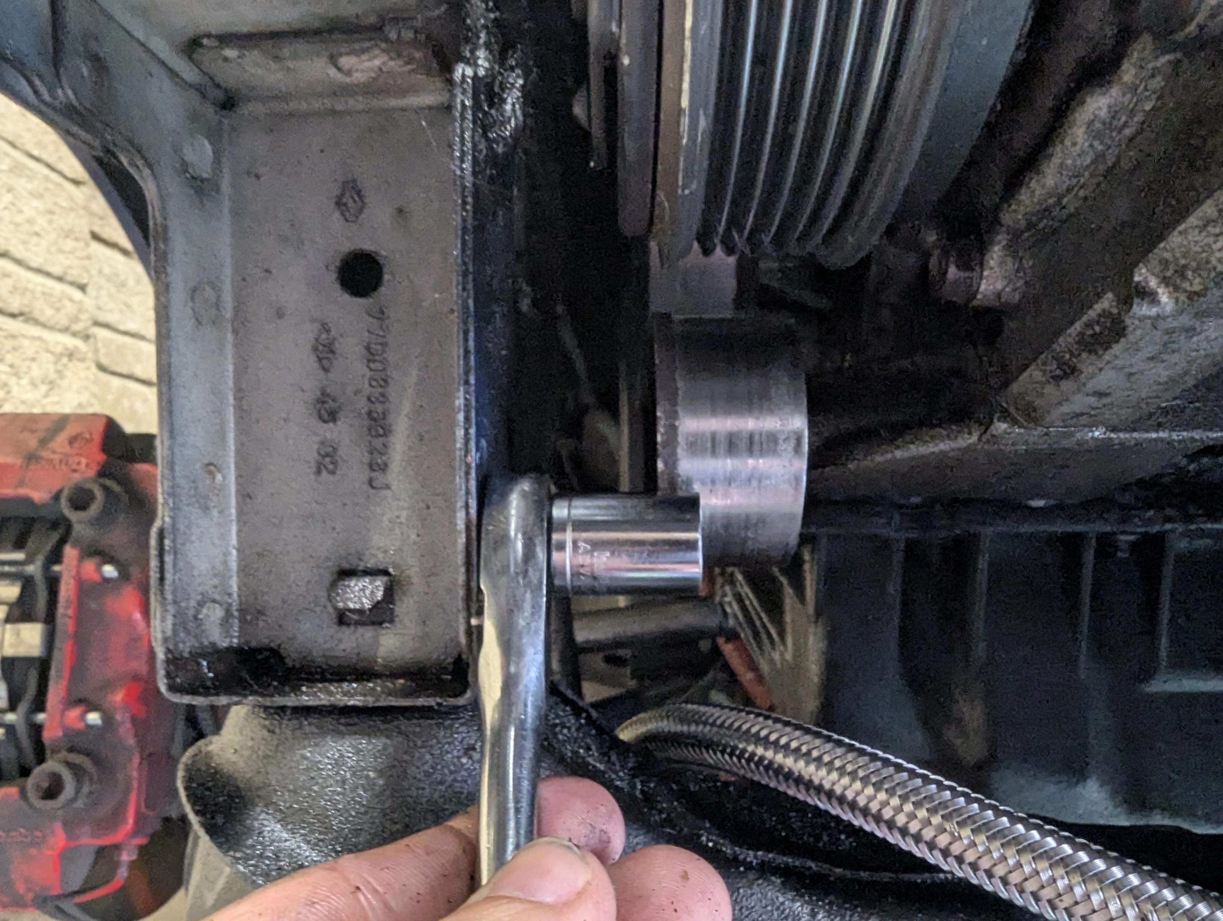

Or not, as there is no cunting room.
Lifting the engine shortens the gap. I could try lifting the gearbox but CBA. Don't think there would be enough room and I would rather it be easier in the future.
I'm either going to drill an access hole for an extension through the leg or sacrifice a socket with an angle grinder to slim it down, undecided.
I've already drilled out these access holes, what were Renault using? Chopsticks?
*Edit: Maybe a deep offset spanner will do the trick
A swan neck spanner works
Or Halfords sell spanner to socket adaptors and you can get in with them Alec
I do have a spanner to socket adapter but that doesn't fit either 🙃
The other issue is that even if it did fit by the time the bolt is wound out 5mm then it's wedged on the frame and nothing is moving
Swan neck would be the sensible first try

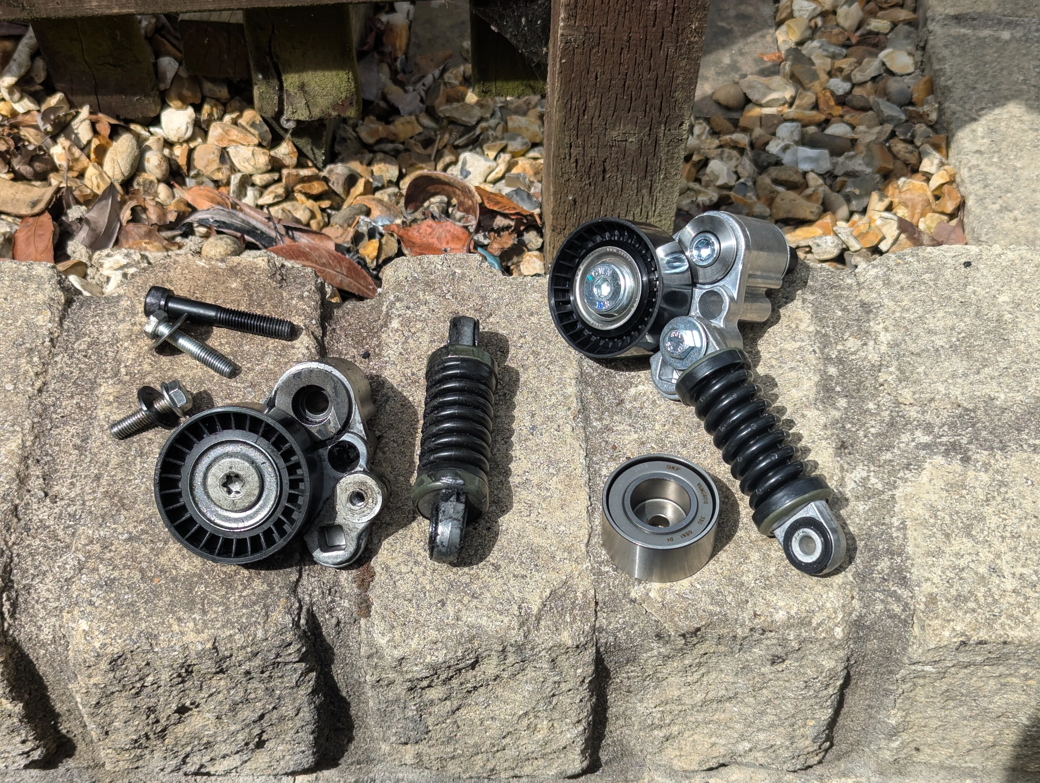

Thought I would wack the tensioner in while I'm waiting on spanners.

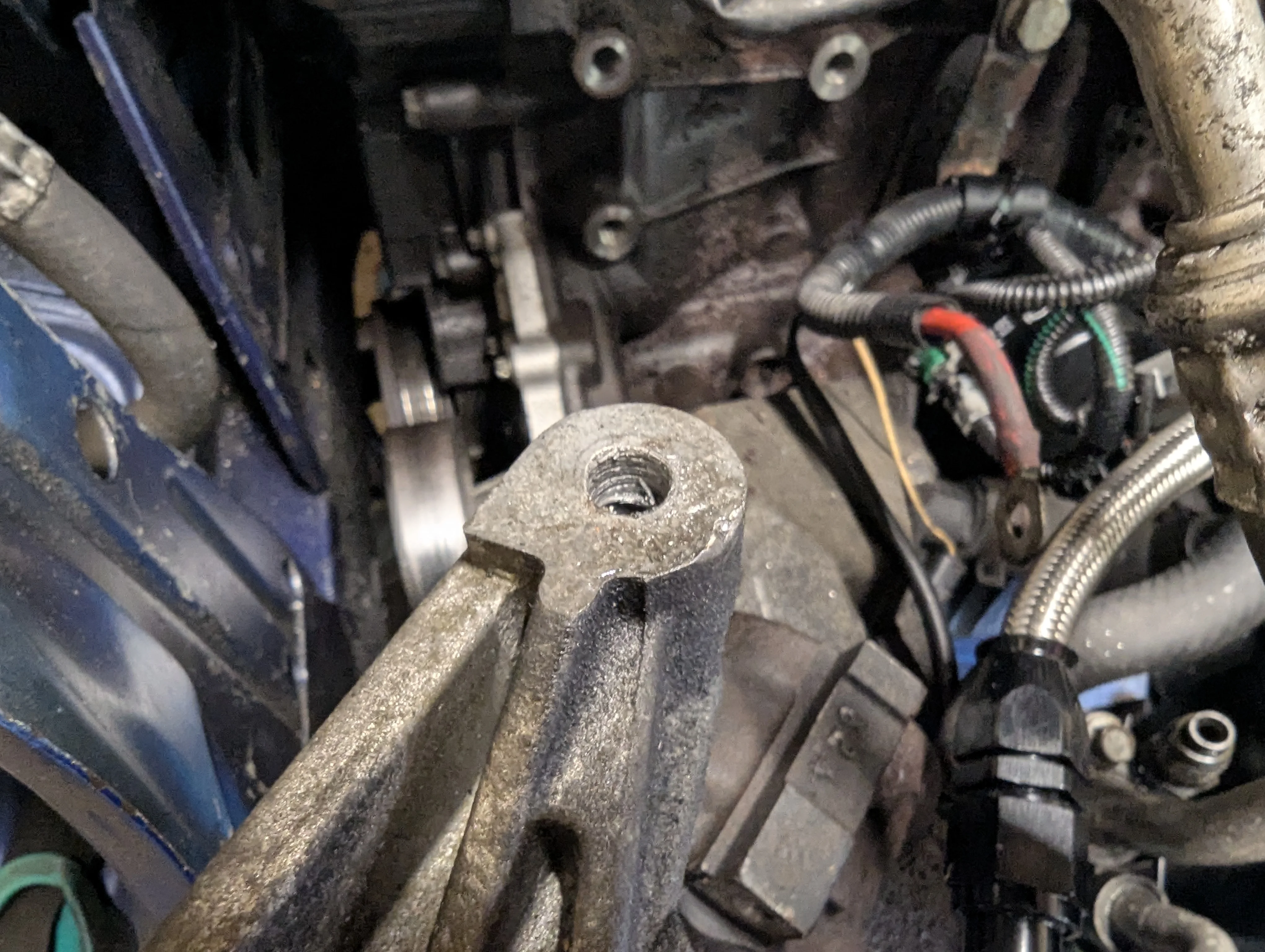

Bottom bolt fine, middle bolt fine, top bolt starts to grip then spins...
The threads in the mount have turned to cheese. I can see the light at the end of the tunnel but it's not getting any brighter.
TBF the car is quite easy to work on after you remove everything around the thing you want to get out. I did buy the car to spanner on... So right into the deep end I go.
New bracket ordered as well as a Halfords worth of spanners, should have it back together in a couple of days.
At least with this amount of access I can sort some niggles. As always, thank you for reading.

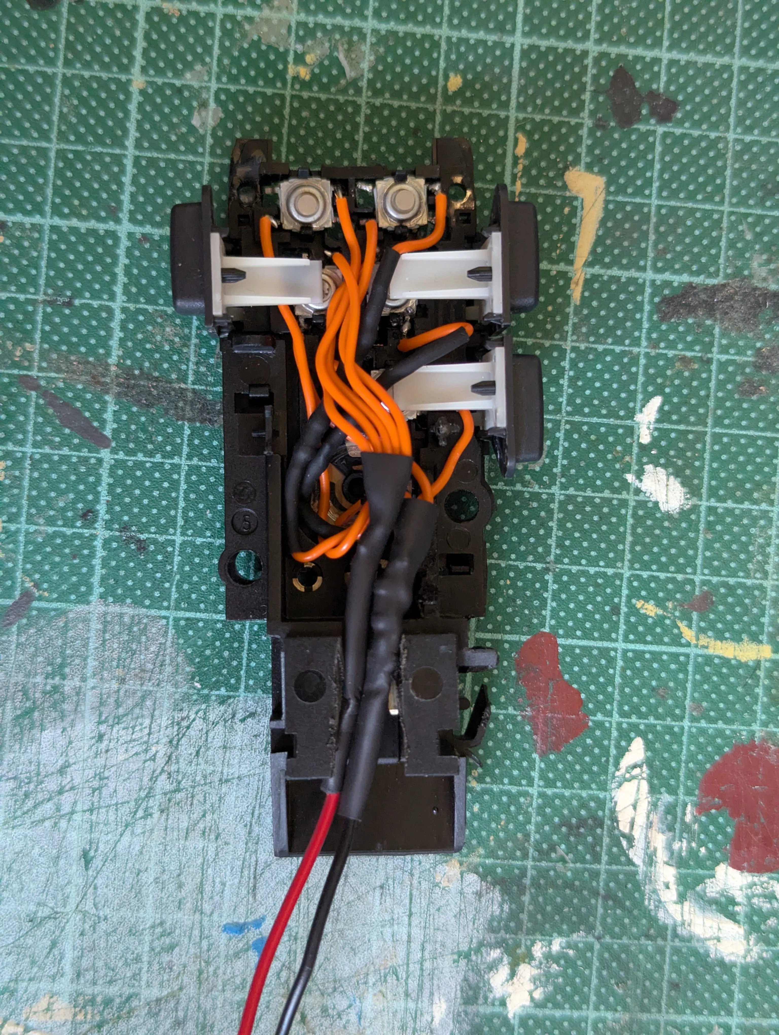

  • Rewired an audio stalk into a CC controller

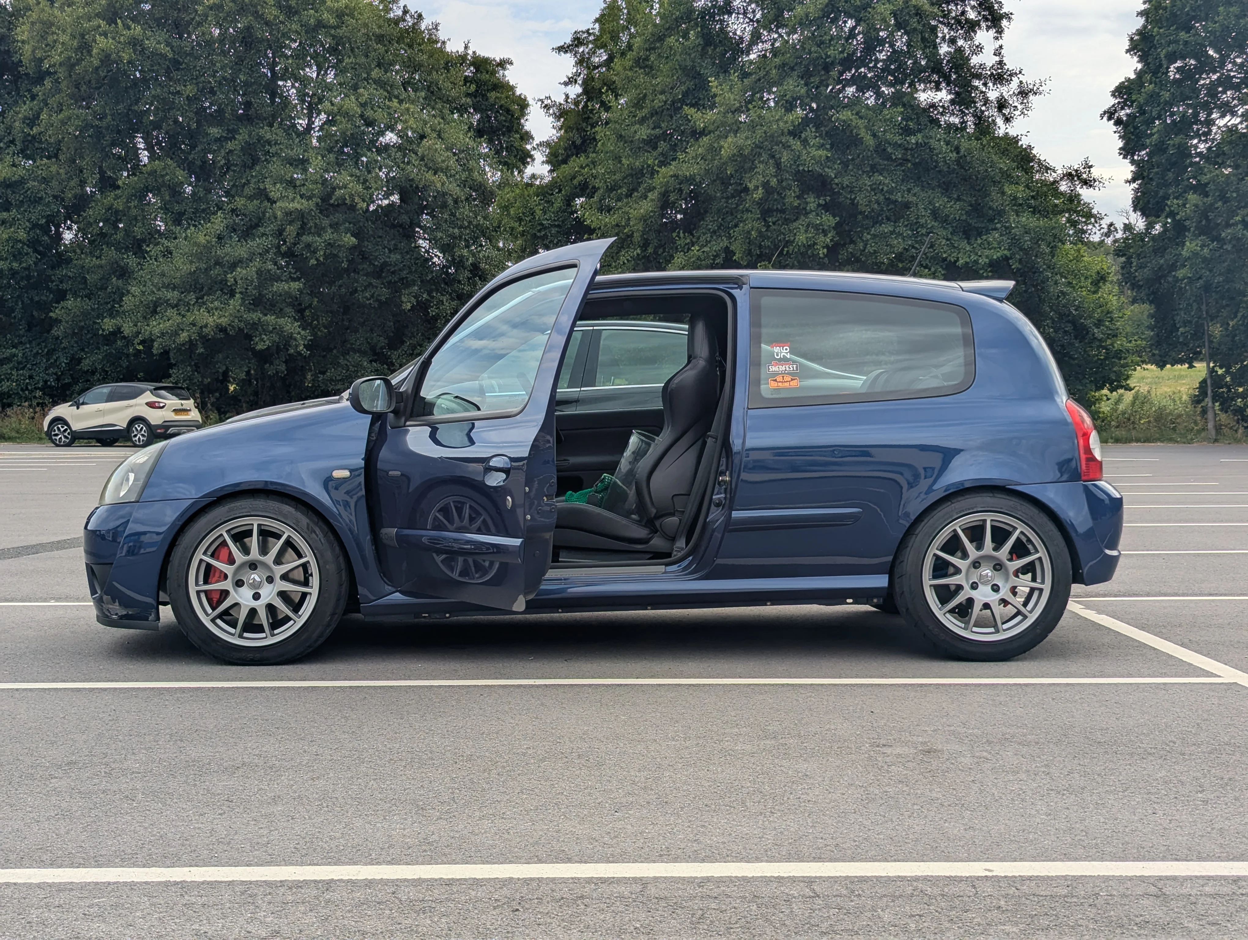

For those that should be doing something better with their Sunday:
New ride height from wheel centre to arch 315mm front 325mm back. Front left rubbed on a pot hole so I think I will go to 330mm all round. Turns out it wasn't the lip rubbing at Cadwell, the tyre hits the edge of the frame and the dimple in the passenger arch.
Lowz are cool but not rubbing at compression is even cooler.

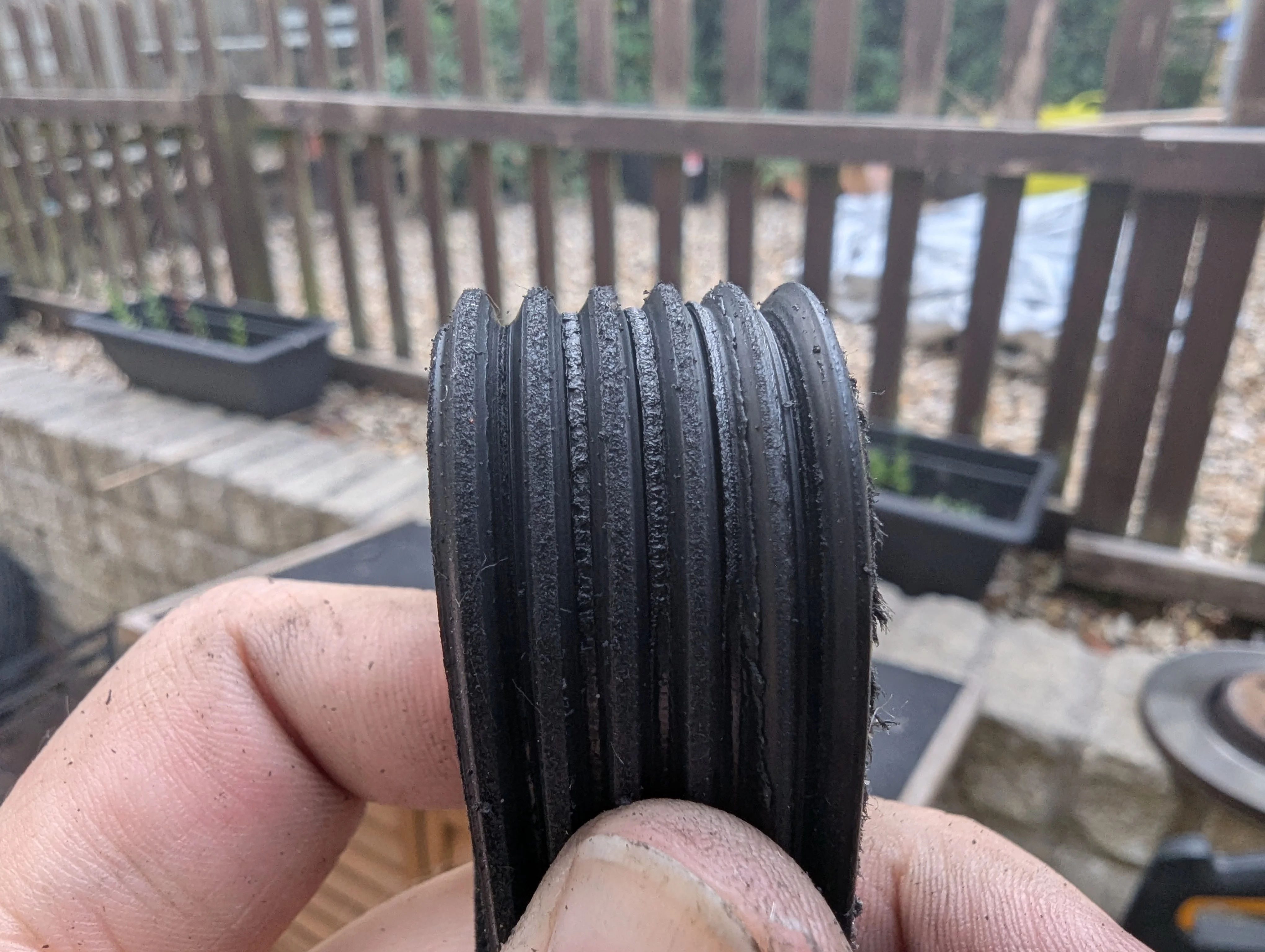

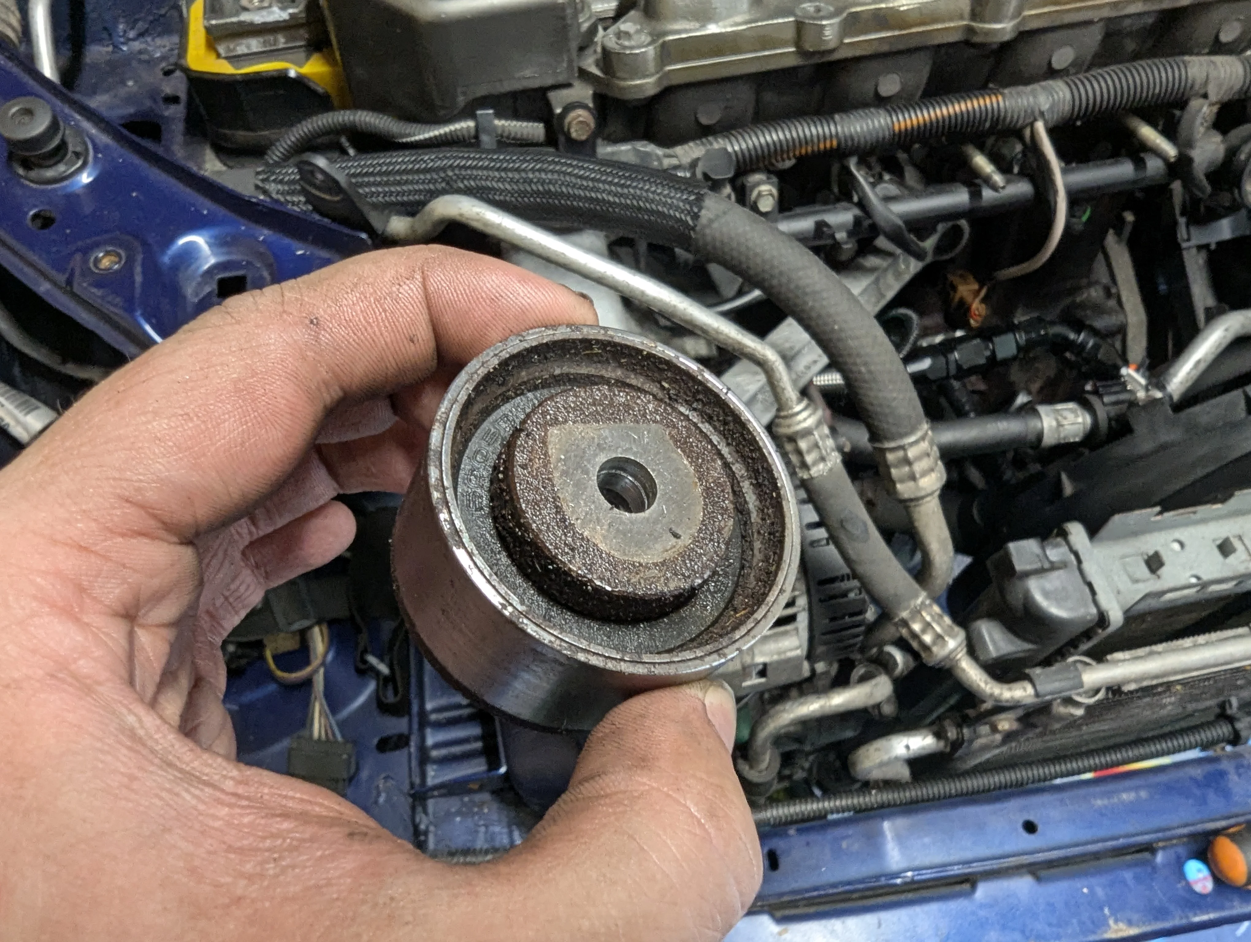

Bottom idler couldn't be removed with a spanner as it had been gunned up, needed to use a 1/2 ratchet to loosen it...
Since last belt change the car has done 5K, seen the rain under ten times and spends most its life in the garage. This idler looks a bit older than that, to me anyway.
New idler in and torqued correctly as I'm a nerd stand up guy.
Bit random but rewired an audio stalk to be a CC controller. Much nicer having the controls closer to the wheel. (I don't have a CC squib).

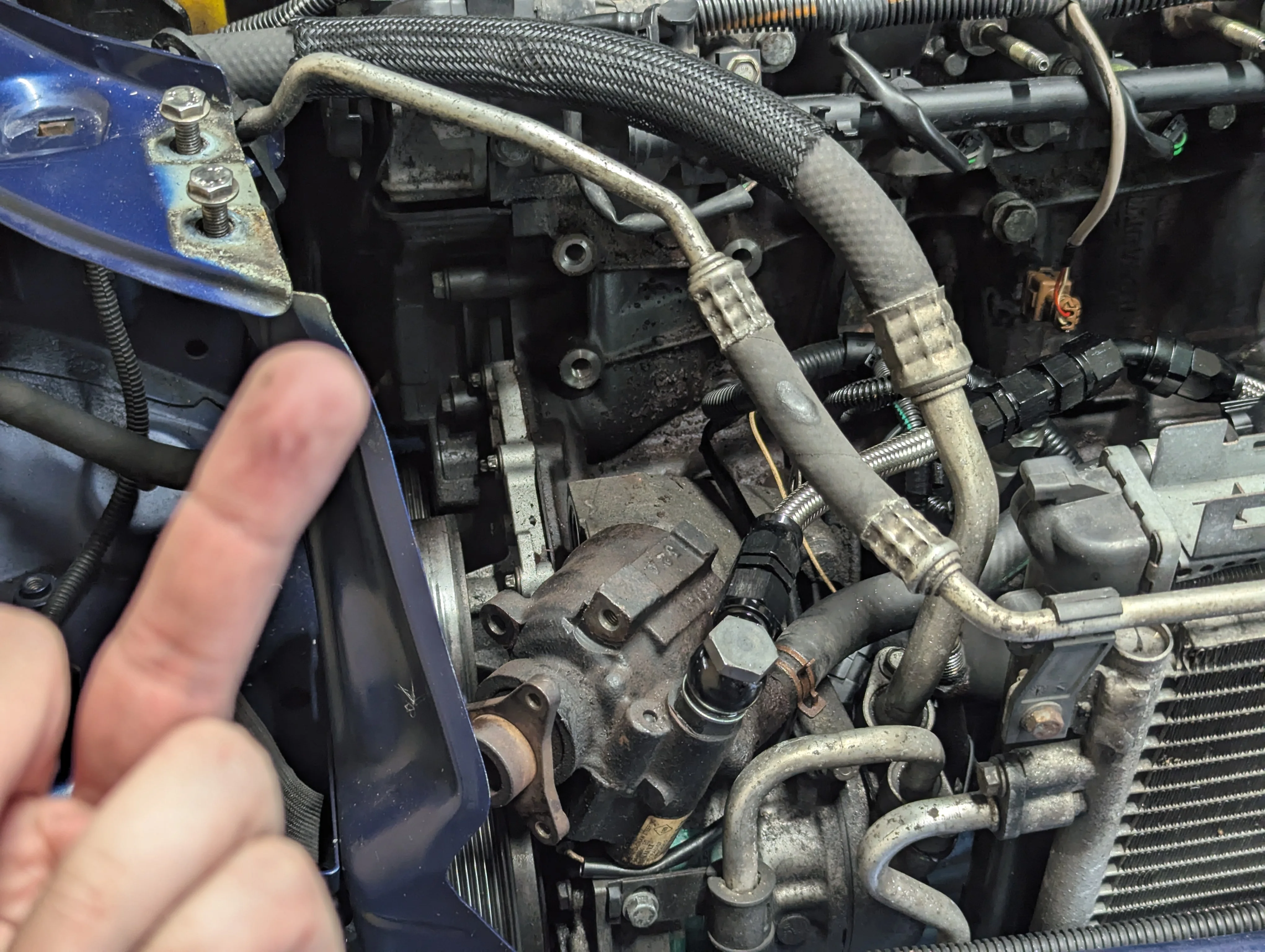

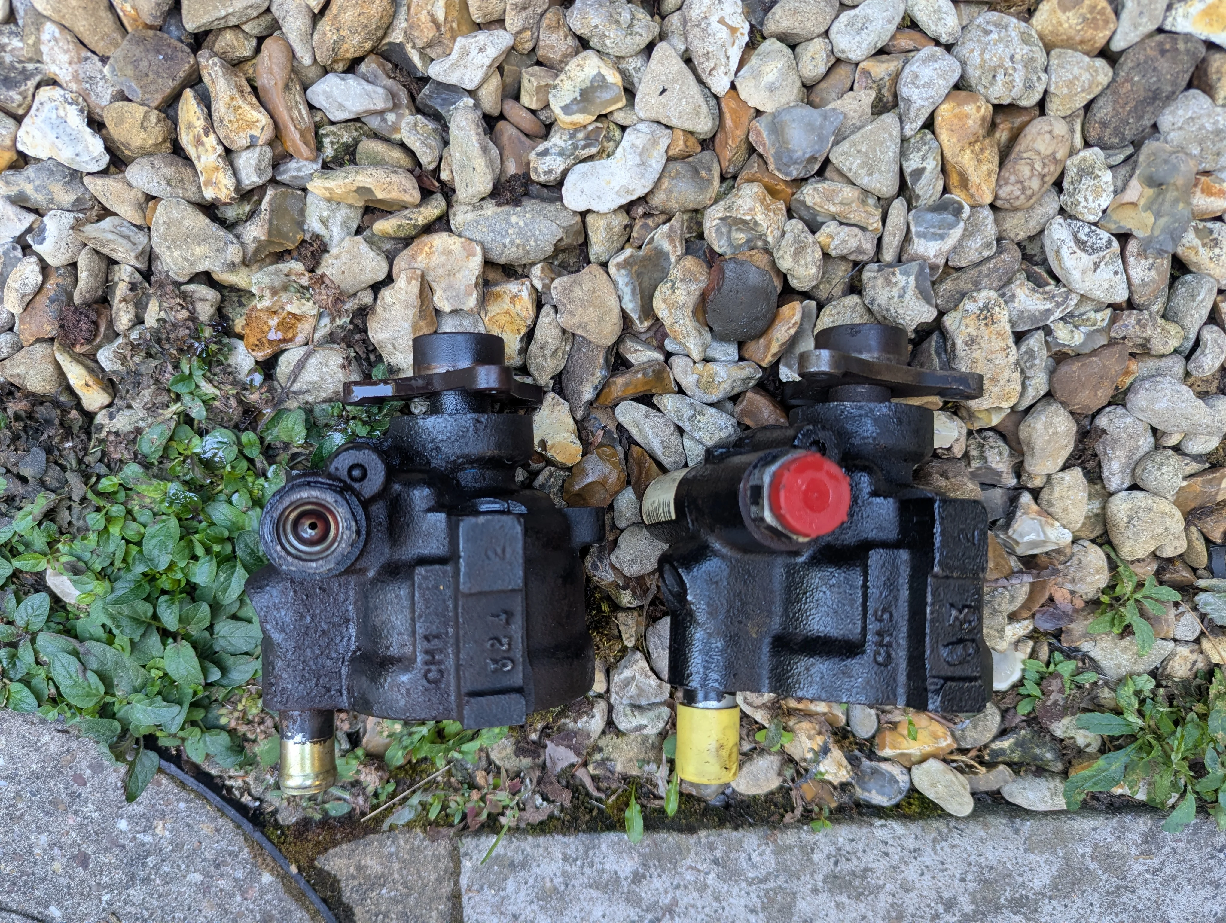

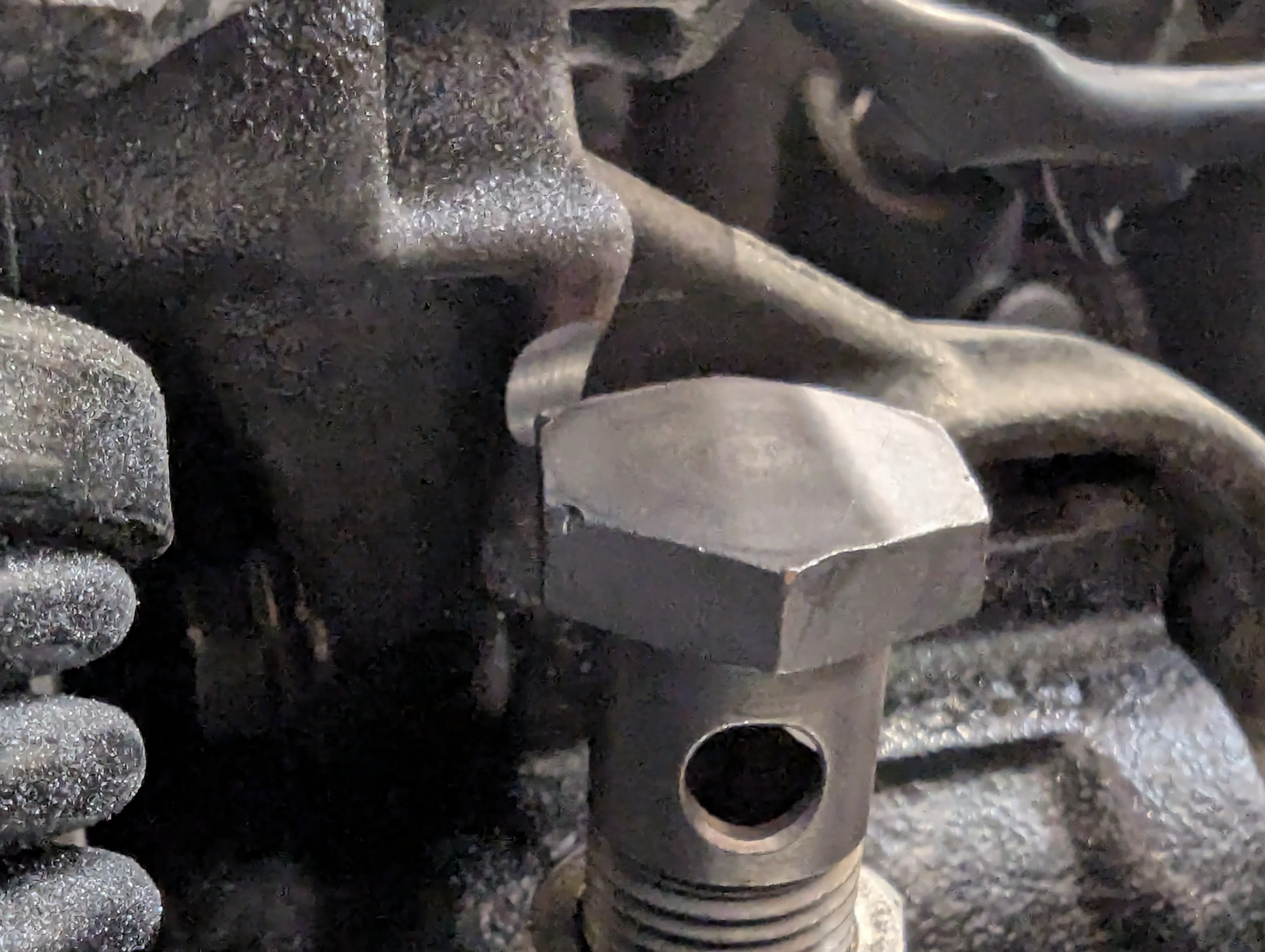

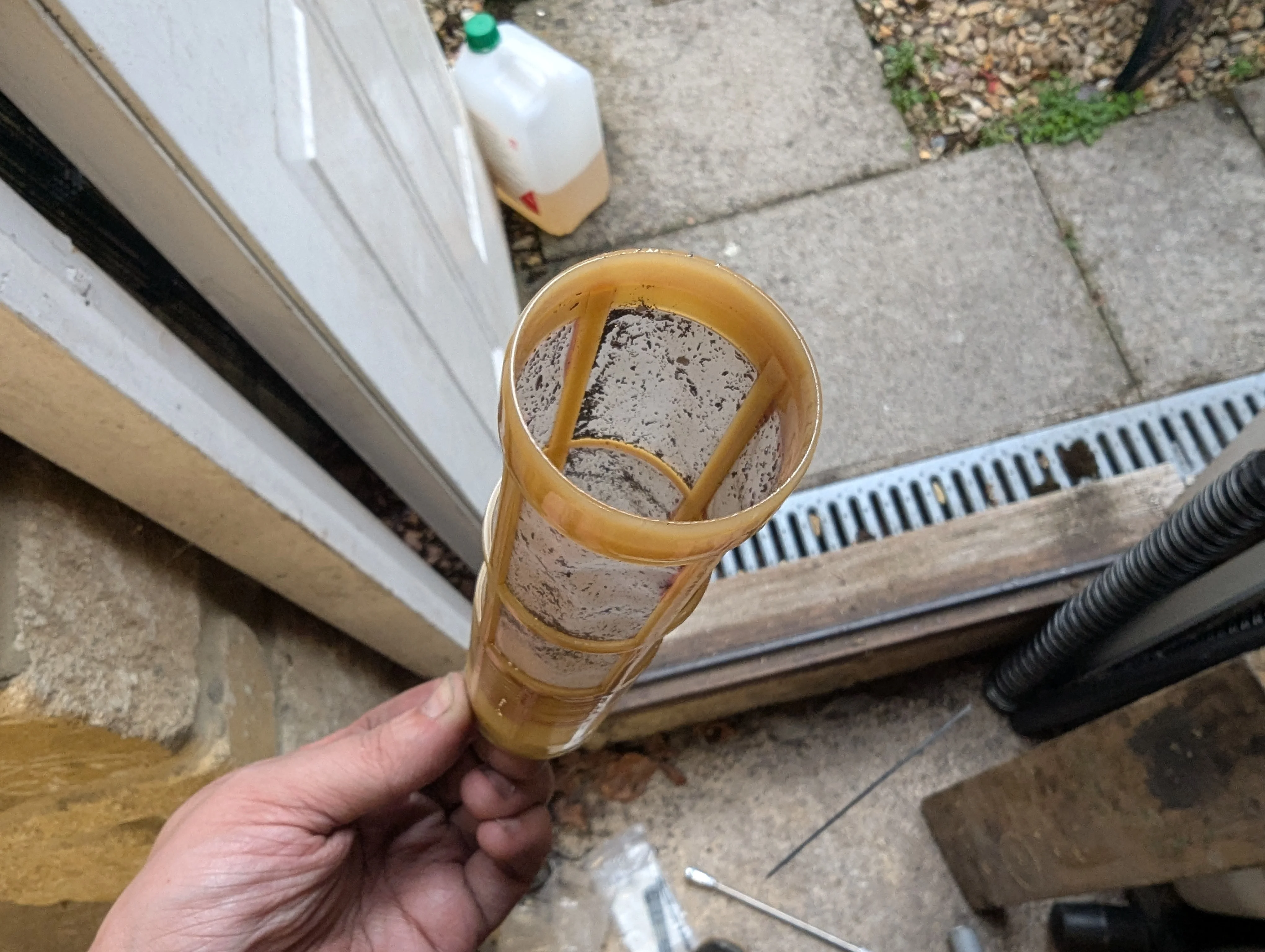

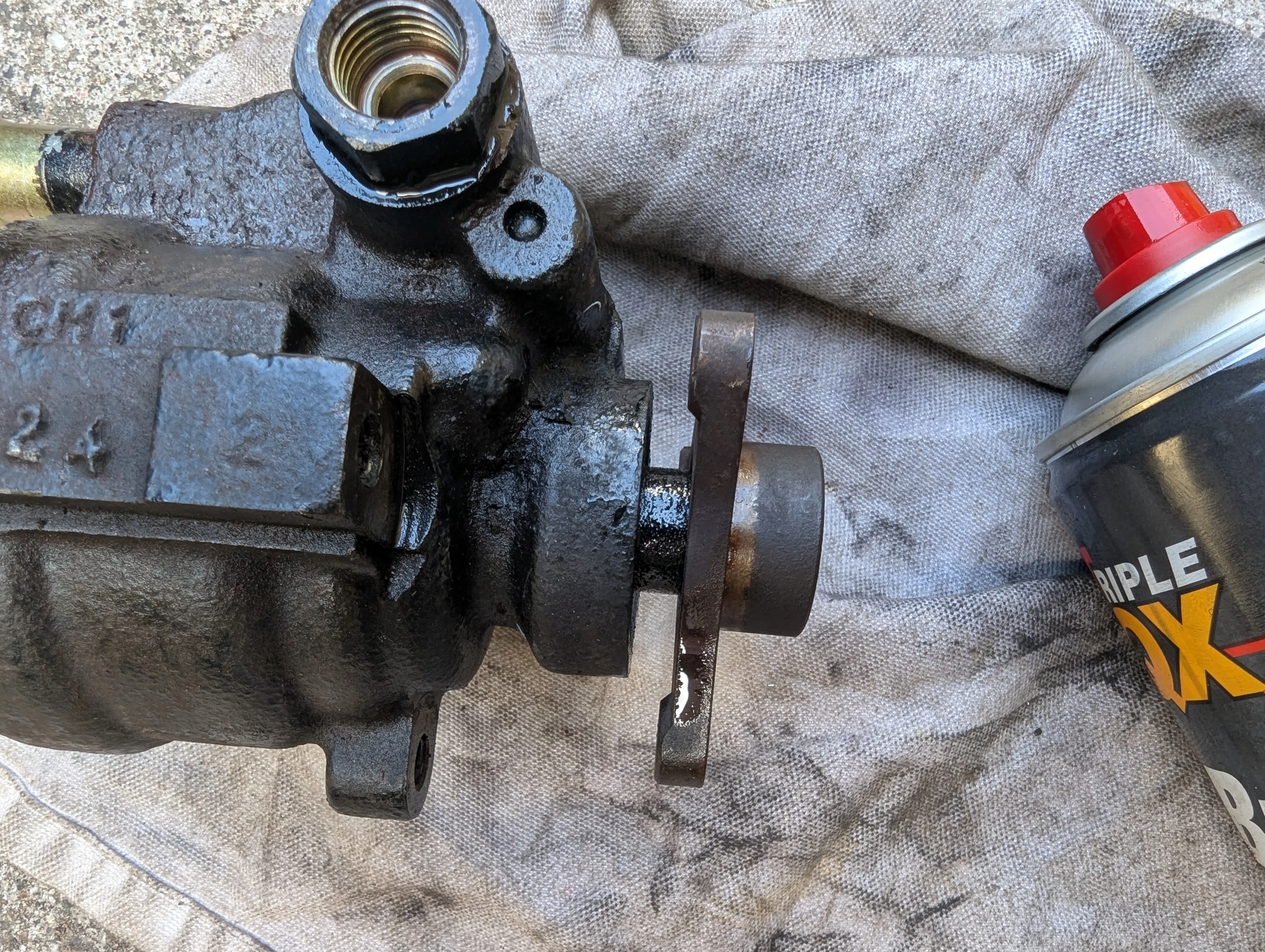

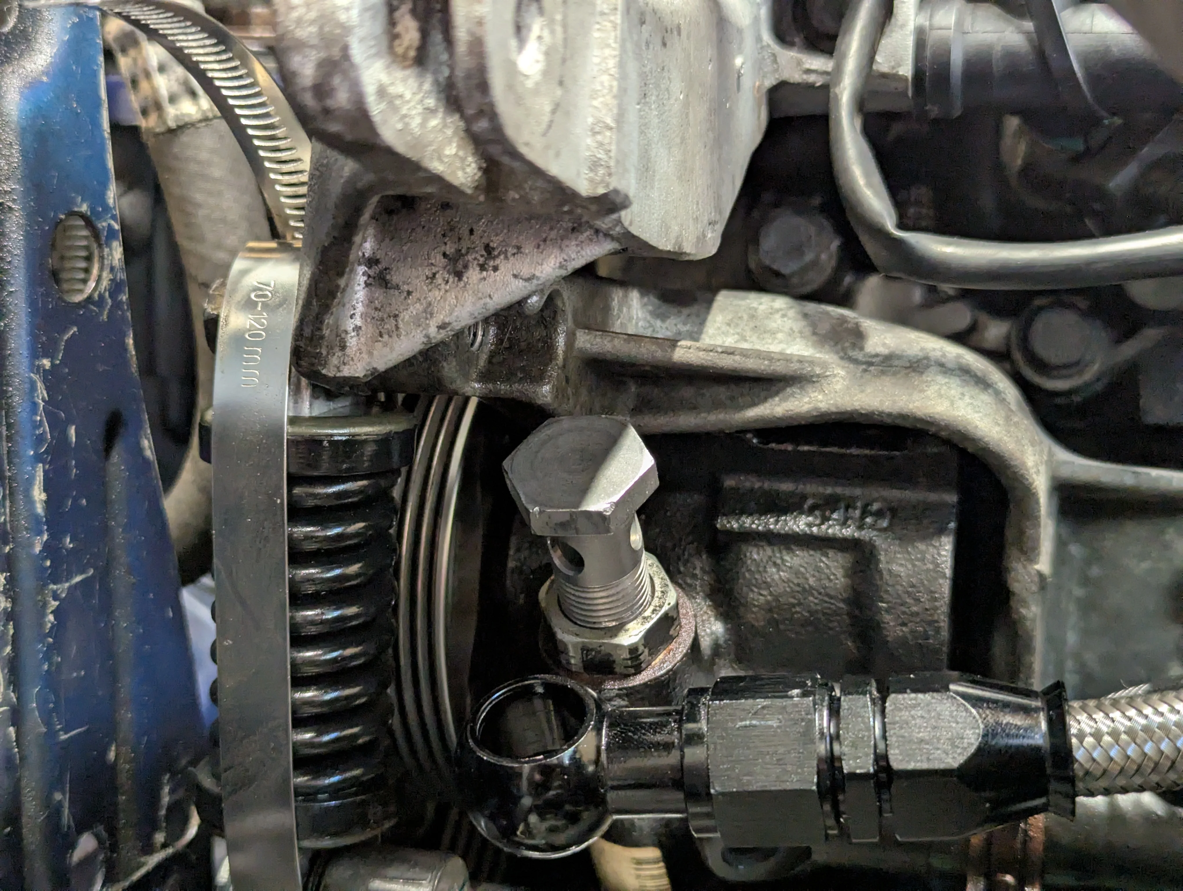

Back to our regular scheduled programming of my car in pieces, only took two hours to replace everything so I am getting better. Just need to grab some new washers for the banjos and send it using the mystery pump.
Old Vs new. Liquid pisses out of the spindle when you spin the old one, has more resistance and makes more of a clonk than a click when spun.
Fingers crossed it survives until EPAS, otherwise it's getting looped for Pembrey. Pray for me, and thank you for reading.

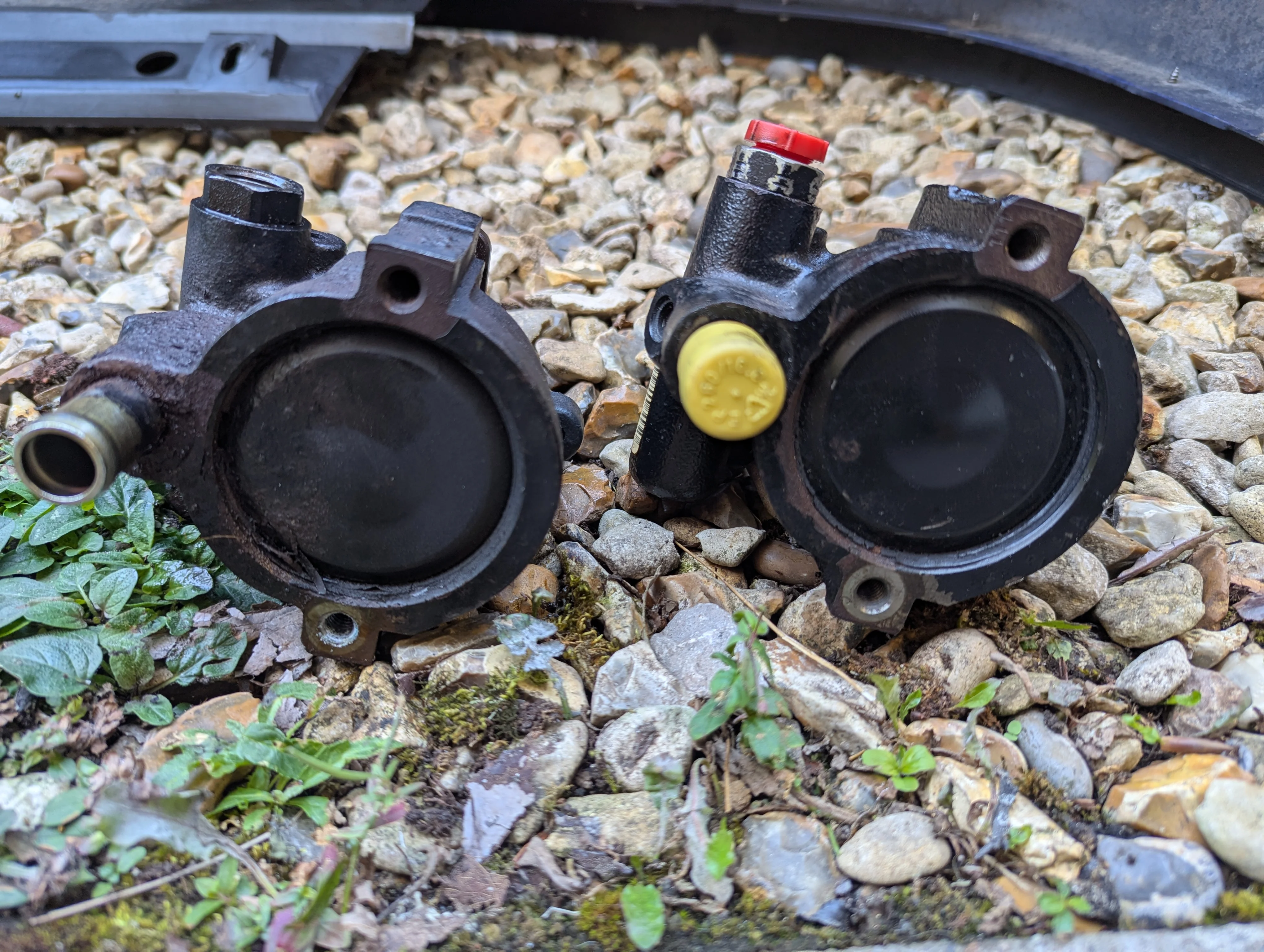

So that's where my PAS pump went...
New one in. A little whine from cold but it's not a new pump - anything that isn't actively producing shrapnel is a win.
Had to notch the mount as this pump's angle is slightly different.
Had to wait a week for washers. Halfords don't sell them anymore.... GSF will only sell them with sump plugs (truthfully I was too busy mid week to go get it)
Then both royal mail and DHL had delays.
Up to the min mark with Motul Dexron III (for the third time) ready for a bank holiday blast. Couple runs checking fluid to make sure it's OK.
