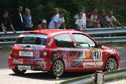

Found another pic of the great man at work in Hungaryland
