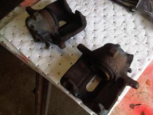

When we fitted a new set of pads at Anglesey we noticed one of the caliper dust seals had split and been baked hard by all the heat. It was a good time to do a full rebuild on the calipers. A quite simple job removing the pistons and cleaning everything up then replacing the o’rings and seals. The pads were cleaned up and a litre of new 5.1 fluid bled through.

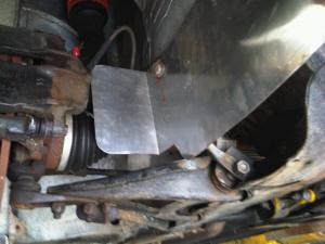

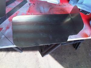

We also made up some new brake cooling duct deflectors as the flimsy ones we had before had finaly crumbled away. they were made from left over bits of heat shield. Some slightly more rigid ones were made out of tin and them carefully trimmed down once on the car so they didnt catch on anything. Quite pleased with how they came out. tested them with the leaf blower when we had finished them.

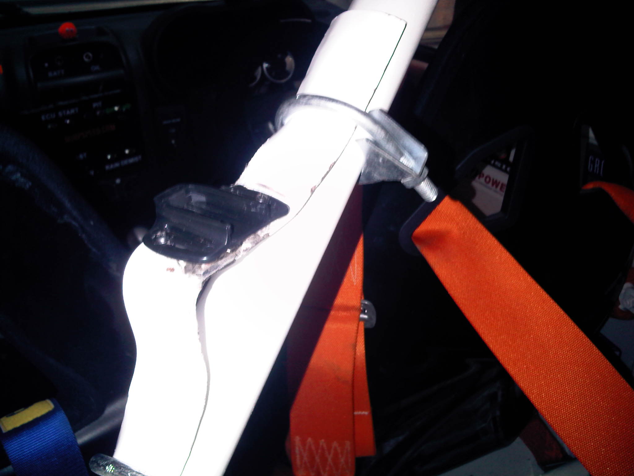

Was trying to find a pic,there is one somewhere but I can't find it.
Basically a piece of metal that's been bent and held on with exhaust clamps.
Christopher.
South Central-South Coast
Think i know what you mean. To make a sort of right angle off of the diagonal then the camera just sits on a bolt on the flat bit, can sort of see it in a few pics of the car while your racing.
