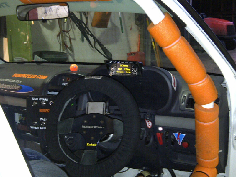

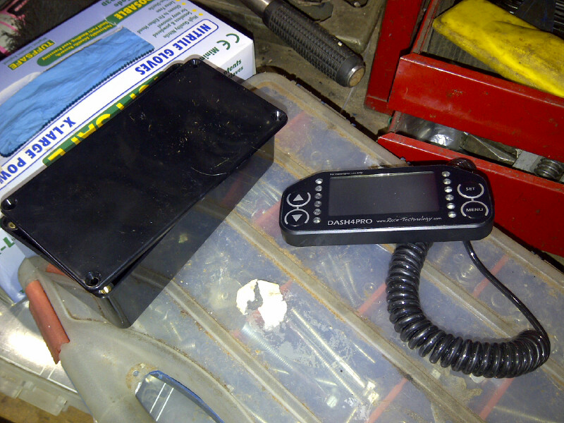

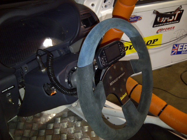

Nope, we run the Dash4Pro, little diddy thing. Cant really comment yet as weve not seen it. Was steering wheel mounted but with helmet on you cant see it without looking down. Not great idea at 115mph into Paddock Hill Bend

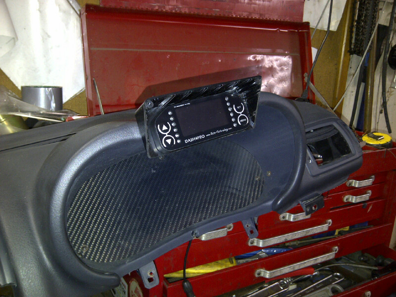

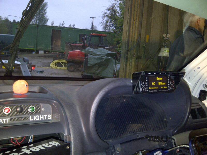

Weve relocated the RaceTech dash to the top of the dash so we can actually see it.
Made a little sun shade for it...............
Very pleased with how it came out and as Tony says i spent ages configuring it to display what we want, when we want. Its a very customizable thing an takes a while to get your head around. Still not 100% done with it as ive got to program all the oil pressure and water temperature alarms in.
I take it it can show whatever readings you want Jay?
Pretty much yes. Its got an interface to read data from the ecu. If we had a data logger it could predict lap times etc but were just using it as a dash. Revs, coolant temp, oil pressure and pit lane speed. Its got 2 sets of built in shift lights too
