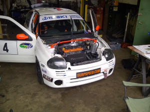

So after getting our best result at Silverstone last weekend, we had a few issues to sort out.
We finished the race with:

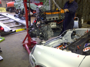

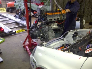

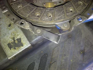

We were pretty confidant that we had almost ran out of fuel and after the race checked the gauge to find it virtually empty. We knew the engine and box had to come out to sort out the clutch so Tony whipped it out last Sunday. To our surprise it wasn’t the release bearing that was noisy but a broken clutch pressure plate. That would have meant we were not fully disengaging the clutch when changing gear leading to the gearbox crunching. It had done some damage to the bell housing as it flapped around but nothing serious.
We sent the box off for inspection at Agency Transmissions of Worcester and Martin did a superb job as usual to have the box rebuilt in less than 2 days. He replaced everything on 3rd and 4th gear. Whilst martin was working his magic we looked into clutches and discovered that the one we had been using was made by Sachs. It was sold to us just over a year ago as OE quality. When comparing it to other OE quality clutches we found some major differences. Weve ended up buying a Valeo clutch kit that is ‘Actual’ OE. The friction plate is a lot bigger and the pressure plate difference is surprising. The part that broke on the Sachs clutch is twice as thick on the Valeo. The valeo kit just looks better all round when compared. So it turns out there is OE spec and there is Real OE.
So today the new clutch and repaired gearbox were fitted back on the engine. The starter issue turned out to be a broken trigger wire so that was easy to sort out. We re-routed the wiring to tidy it up and dropped the lump back in the car. The engine getting hot at Silverstone was a worry, but on inspection we found that the thermostat had partly collapsed. We hadn’t changed it with the new engine, stupidly, so hopefully fitting a new one has put an end to the problem.

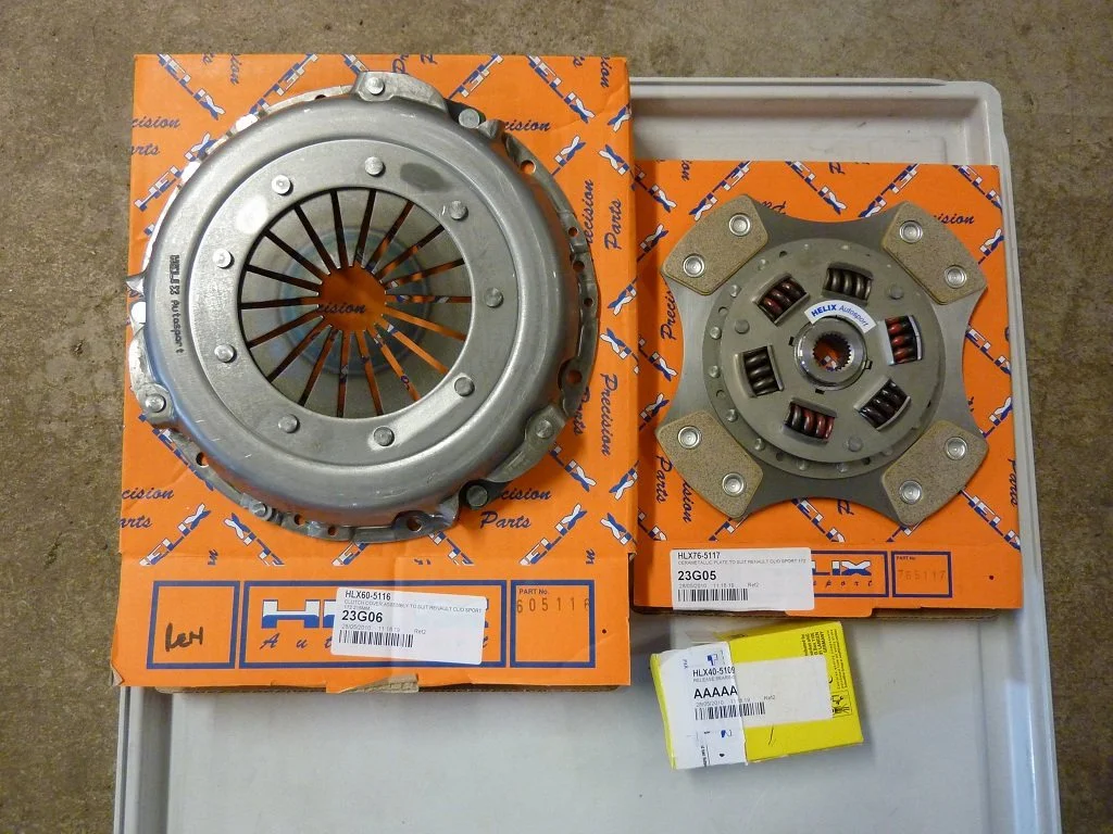

Your choice just letting you know what happened to mine, the truth is Valeo probably suck just as much as that Sachs clutch you broke. But hey its your choice, if you would like a Helix Im sure you could afford it on your own considering the amount of upgrades you throw on that car...
Pressureplate + release bearing + Ceramic Sinter was £409 including shippment to sweden. An organic setup would be cheeper and better IMO. Ordered from DemonTweeks

It was only a joke Marten, appriciate your comments but our budget is wafer thin this season and any kind of failure wasn't wanted. It may be something we will look at in future but for now we needed to get it work as best we could for as little as possible. The Valeo clutch is the best 'stock' clutch out there we could find. It was less than £90. If we'd of paid £400 for a clutch we wouldn't of been racing at all the rounds we plan to do. Yes we have done a lot of upgrades to the car but after the loss of 2 big sponsors we didn't have enough money to run it so we have cut back on testing and dropped one of the races we intended to do. If we knew thatd happend we wouldn't of spent so much over the winter
Sure I understand you are on a tight budget, I just object a bit against the Valeos being so good, they may be better than Sachs sure but far from bullet proof. As one example mine was only 325km old when it exploded @ 7000+ rpm... They took full responsebility and got me a new box and everything, at least thats something.
From quote 2010: "HLX60-5116 £156.73+vat CLUTCH COVER ASSEMBLY TO SUIT RENAULT CLIO SPORT 172 215MM"
