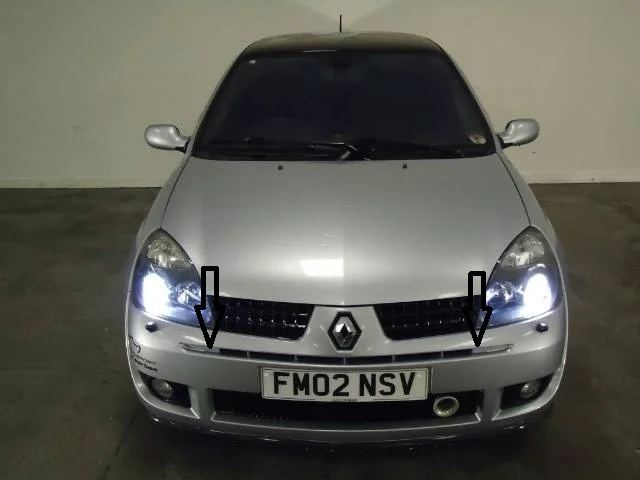

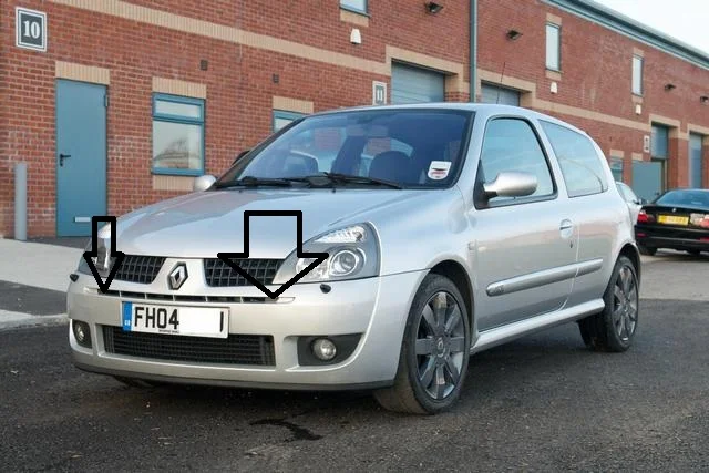

hi, just wondering what you mean by black inserts, cant see any difference, just you seem to be able to tell straight away if its been sprayed or not. you are right about the silver one btw as that garage is round the corner from me. just want to check mine thats all
Look underneath the lights, on the piece between the upper grill and lower grill, there are 2 black plastic 'stickers' which when a front end is resprayed, most resprayers don't take account of.
See amended picture with arrows pointing to the black inserts.
the 2nd picture is the without (so they've either been removed or painted over...
