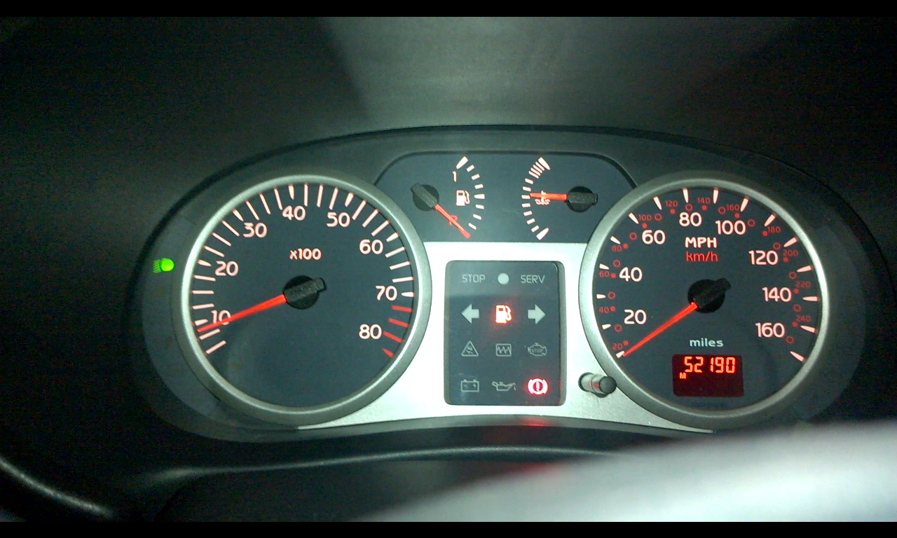

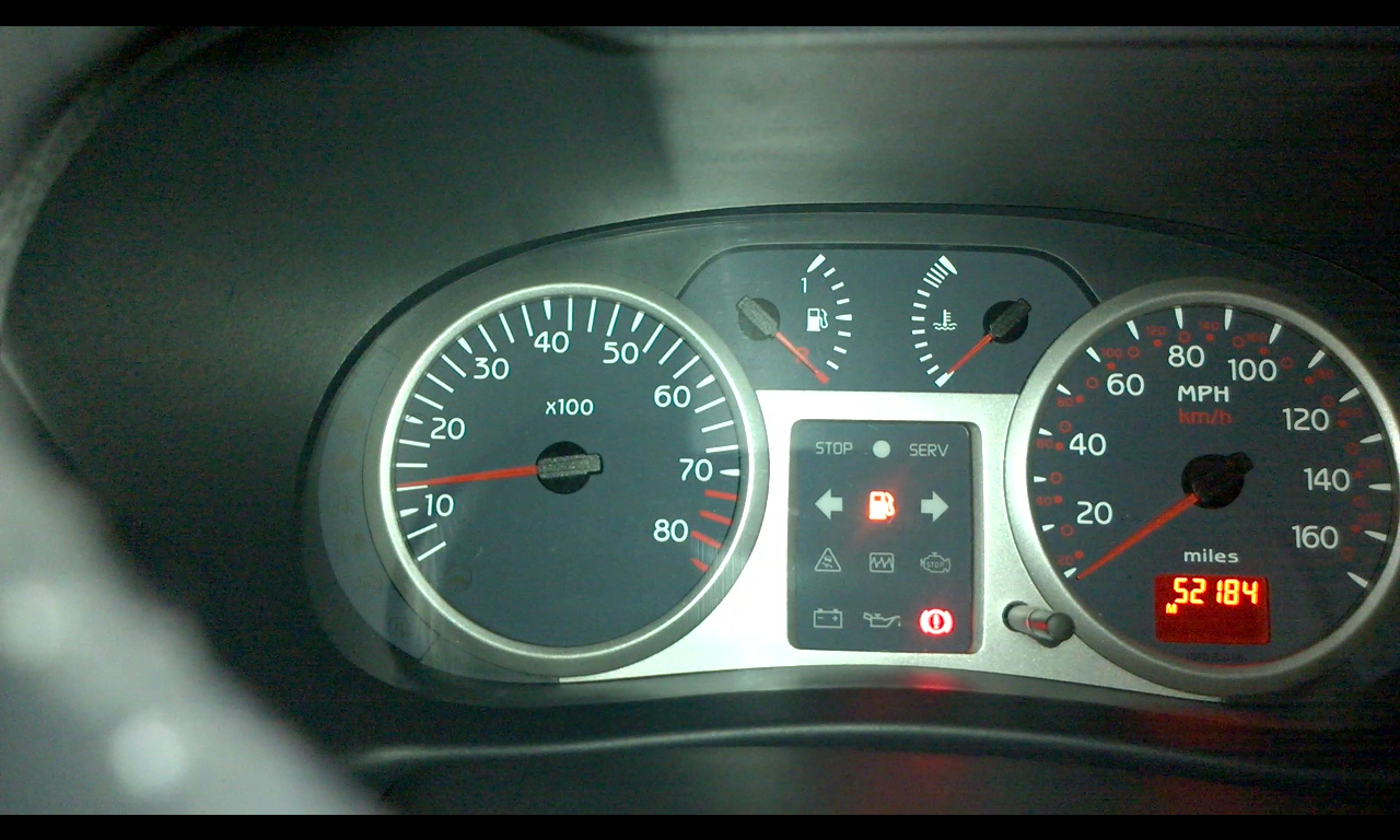

right, had a bit more of a read about it from various threads on here and ive found out a few things.
I've read that the 98ron map idles at 1100rpm cold and settles down to a steady 900 when warm.
Mine does exactly this already. So does this mean mine is already running the map?

couldn't get the vids to upload so took screenshots. obviously one when cold and one when warm. It hit the limiter on the second red notch after 7 in second gear.
  turbo 182
Idles at 1000rpm if it has already got a rs tuner map on it and the higher Rev limit is 7600rpm in 3rd + should be able to do 98mph in 3rd as you hit Rev limit in 3rd
LeeRS
well that's different to what other people have said aswell. I guess its different on all cars. I believe 900rpm is the target idle though.

I echo all. But I still have my "5k kick" even after the map for some reason.. mines special I guess lol.. But seriously it's a great mod. BTW @LeeRS judging from your warm idle, you do not already have the map installed as it idles slightly higher than that once mapped up.
Oh BTW - Get some bloody petrol!!
LeeRS
its above 900 but under 1000. Surely it cant be that accurate :p.
I phoned the bloke who owned it before me and he said it has had a remap. He didn't have any reason to bs me as I bought it from a car dealer he had traded it into. I will plug @bob the builder RS tuner in on Saturday. Will it show if it has got a map on it without being unlocked?
