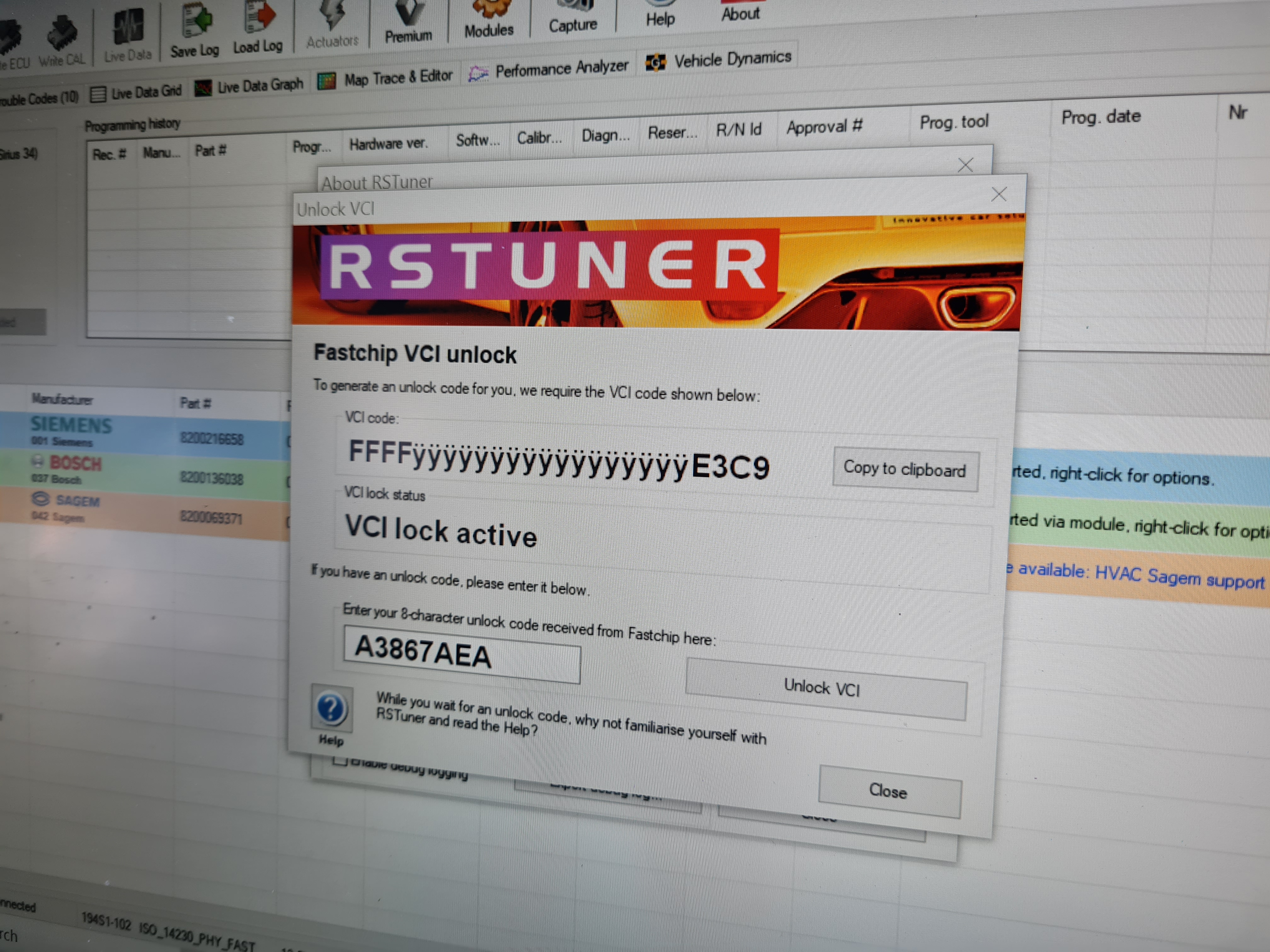

No I unlocked it then when I went to do the next step it said unable to obtain security access from ECU. That's when the VCI number went mental.
For what it's worth my car start with everything disconnected.

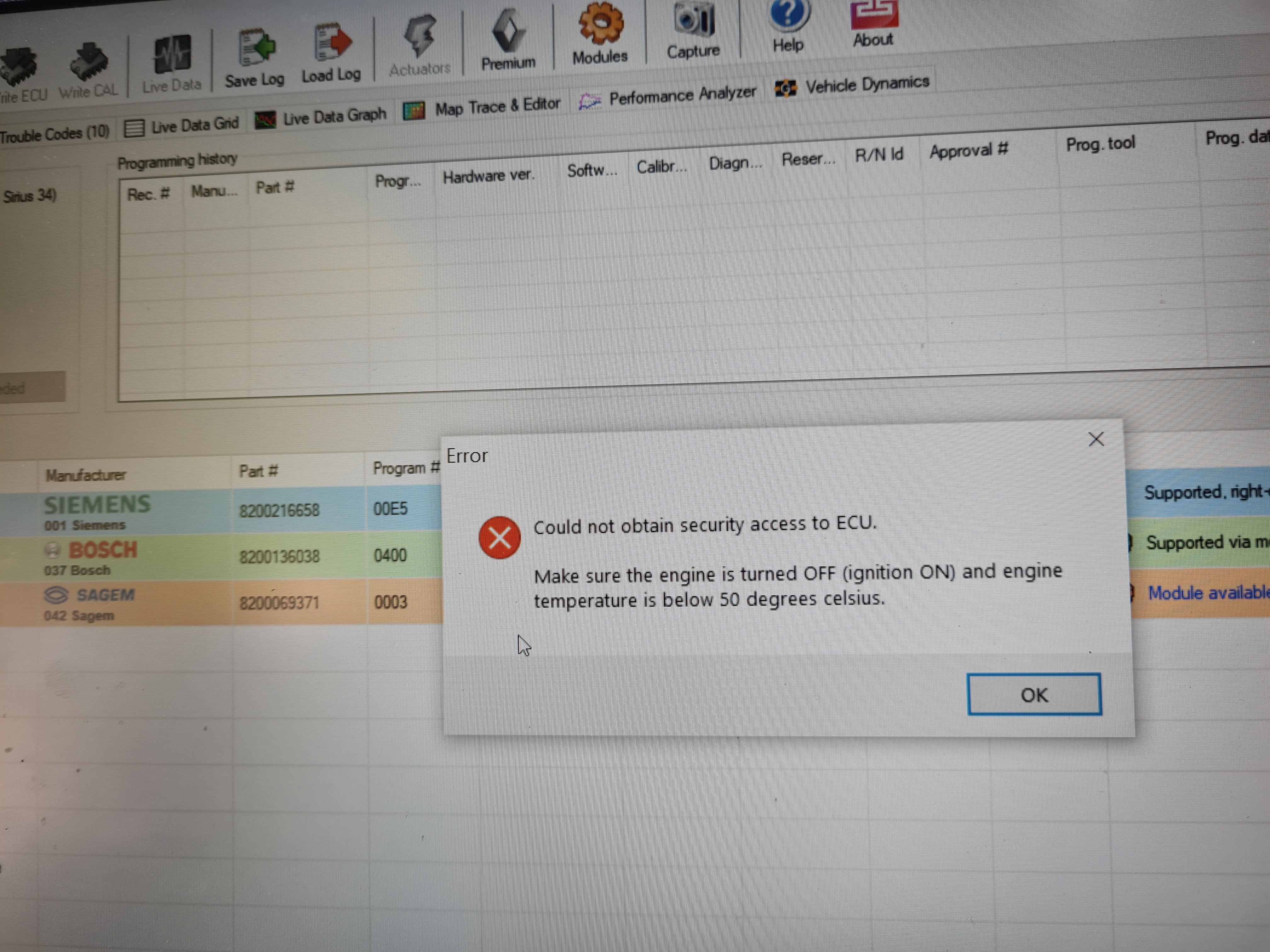

From Henk-
If you cannot get security access check the following;
- engine cold < 50C
- engine stopped
- ignition key in the full ON position
- proper battery voltage
- immobiliser function working normally, red dash light off. Usage of 2 keys or a key without a low battery can result in a malfunction

All of the above I'm doing correctly, I'm ready to give up on this soon

Right this could be wrong as my brain is fried now.
I initially unlocked the ECU
Then connected to the ECU
Went to read ECU and it opened a window to save but wouldn't allow to save and said "couldn't obtain security access to ECU"
