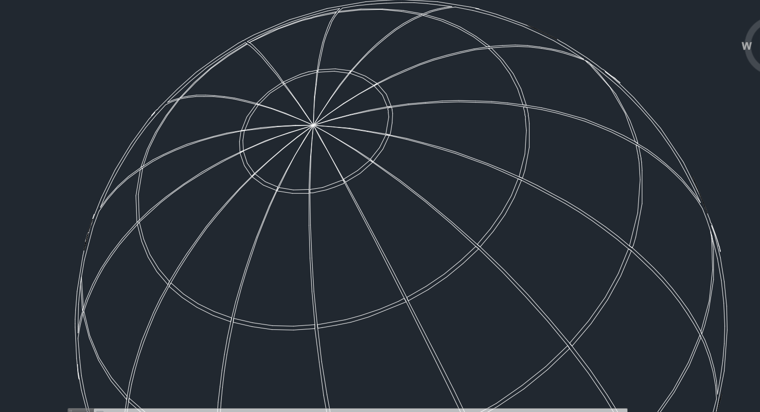

Ok got bored and converted a random vector image off google, I dont have autocad on this pc but it should work as a dwg with some fettling.
LOL

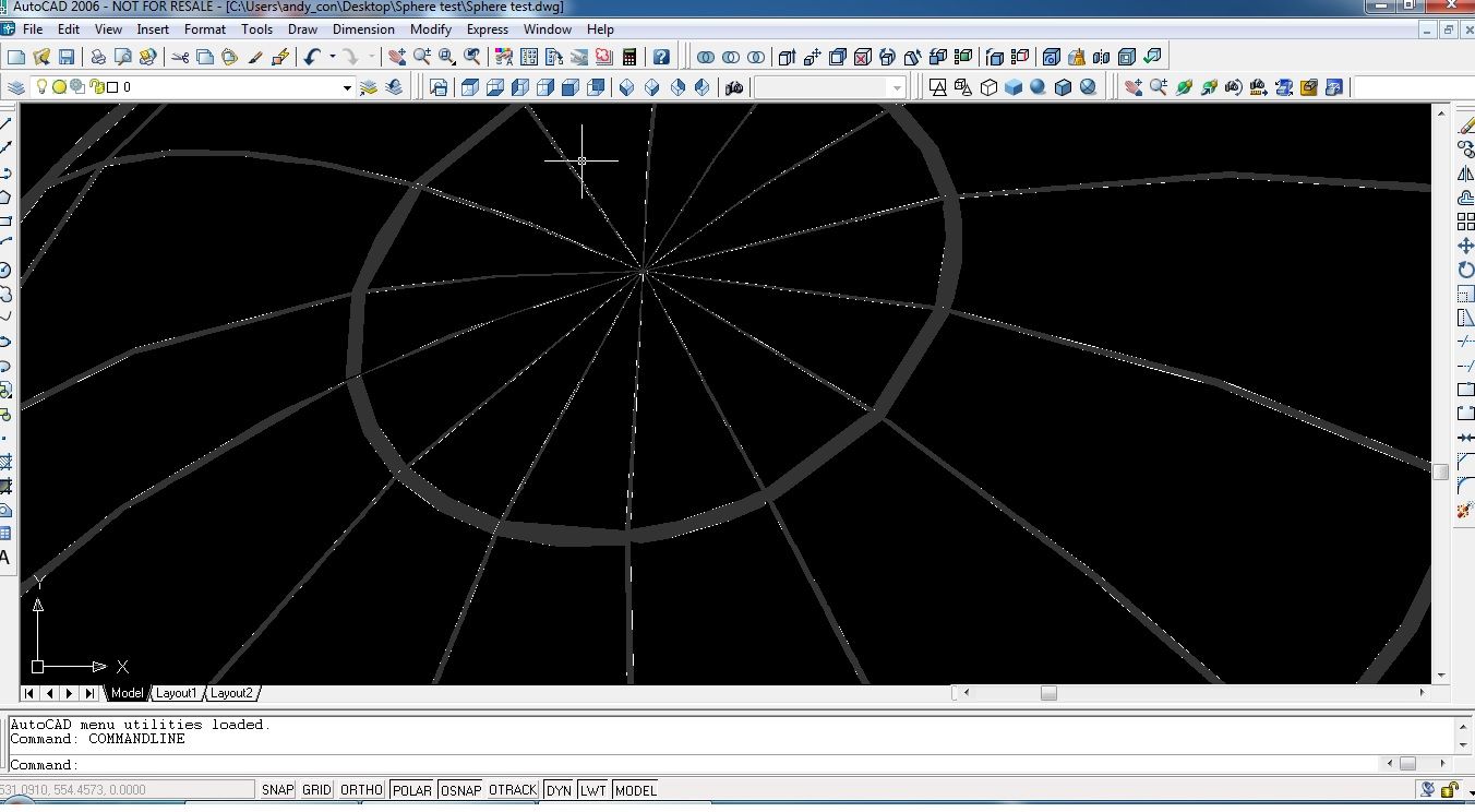

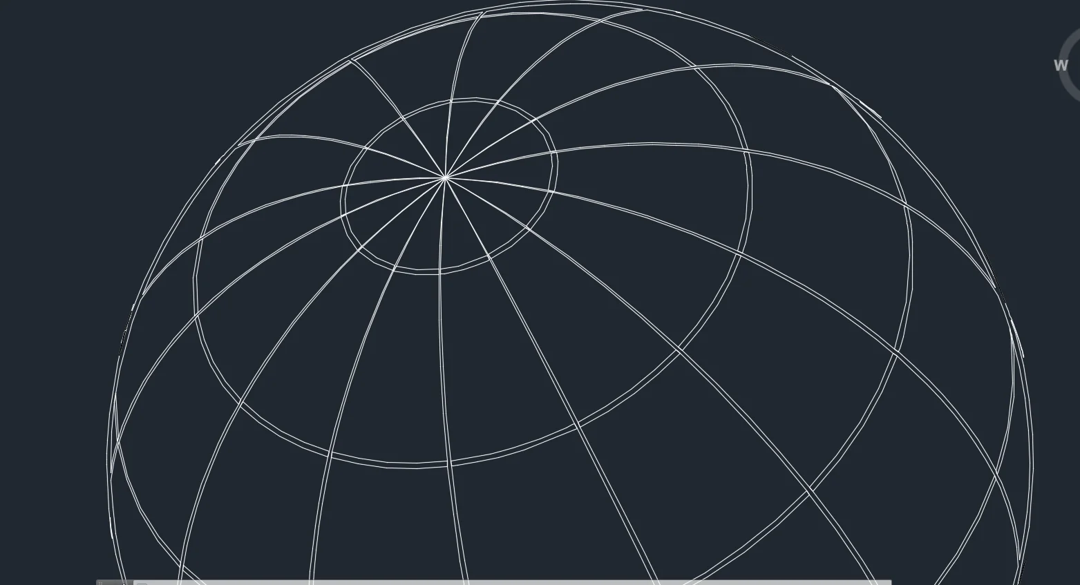

yeah they open fine, but double lines and messy.
who ever makes these has em off to a fine art, all lines are just single smooth lines. very clean and no mess
The double lines are probably the fsr suede of the part that you can see through it, as you would if it was a 3d wire frame in your hand. That snowman only shows the nearside of the frame.

Nah its because I used illustrator to convert it and it treats the edge of the white and black as a line.
So each vector line is treated as two lines in cad, requires a bit of work to prep it.
Unfortunately it’s the only software that I had that still exports to 2006.

this is how it looks in cad

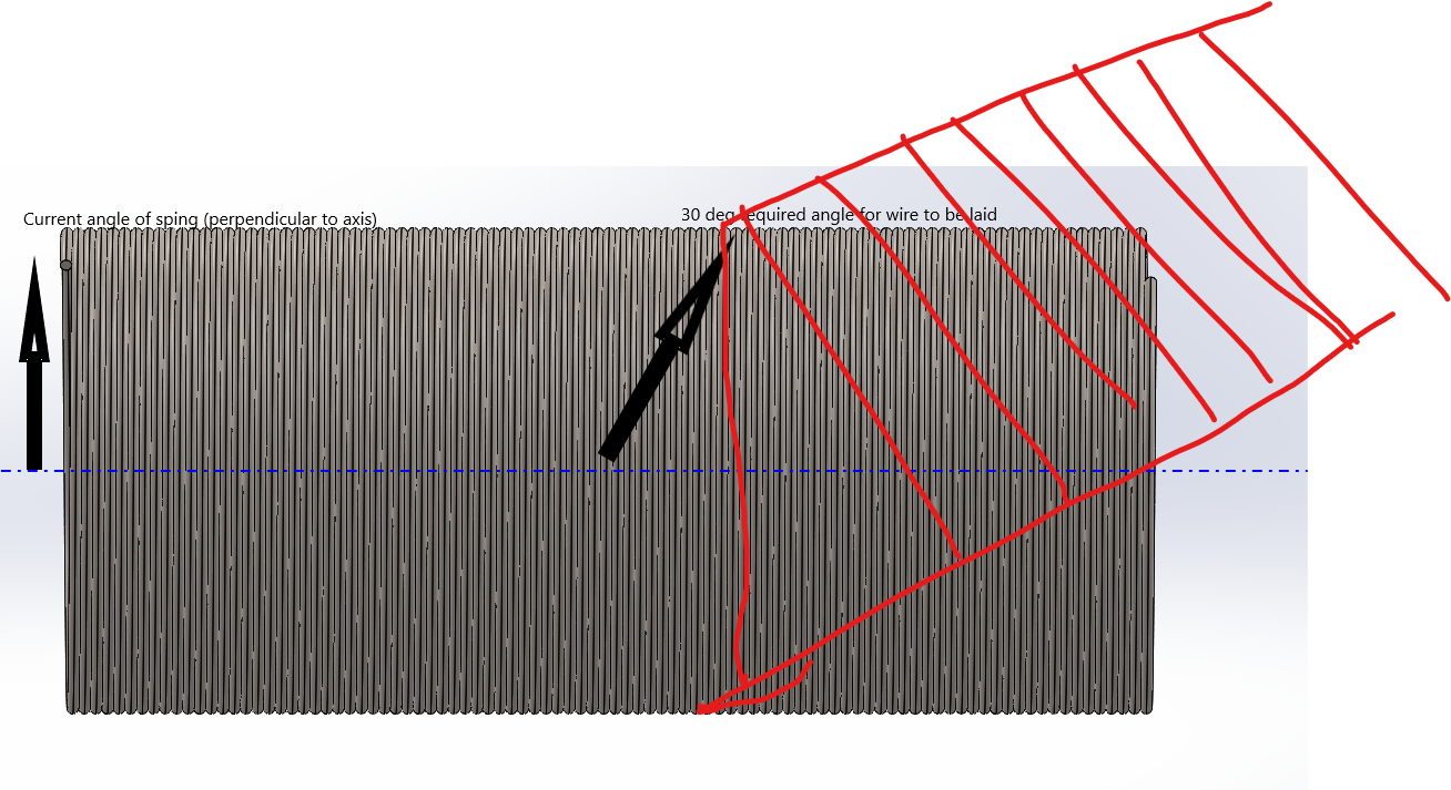

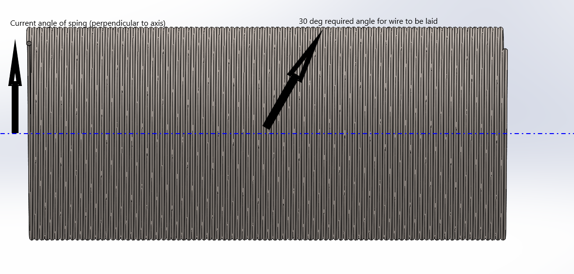

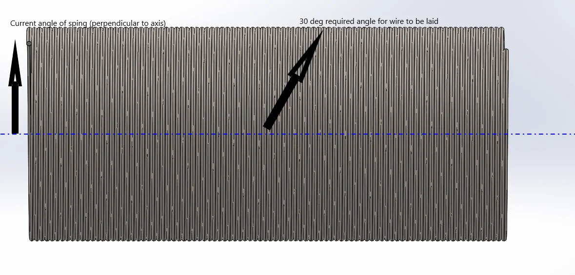

I have my own query for anyone else who uses it? Specifically, is anyone familiar with helix spirals? I need to lay out a spring like pattern that revolves 360 deg with the first wire offset from perpendicular at 30deg.
Use them occasionally for knurling etc. I end up having to google them every time though. Seems to end up being luck if I get one created lol
Any chance you’ve got a sketch or photo of what you want I’m having a hard time trying to imagine it.

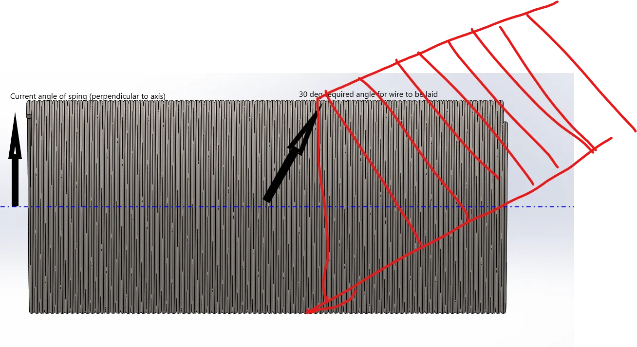

Excuse my crap drawing on my phone do you mean this?
If so sweep it along a path?

I’ve only experience of NX, but it’s very similar to SW.
You need to create a curve for the helix to follow. So essentially a straight line, then your connect perpendicular line at 30 degrees.
Helix command and there should be something along the lines of ‘follow guide’
