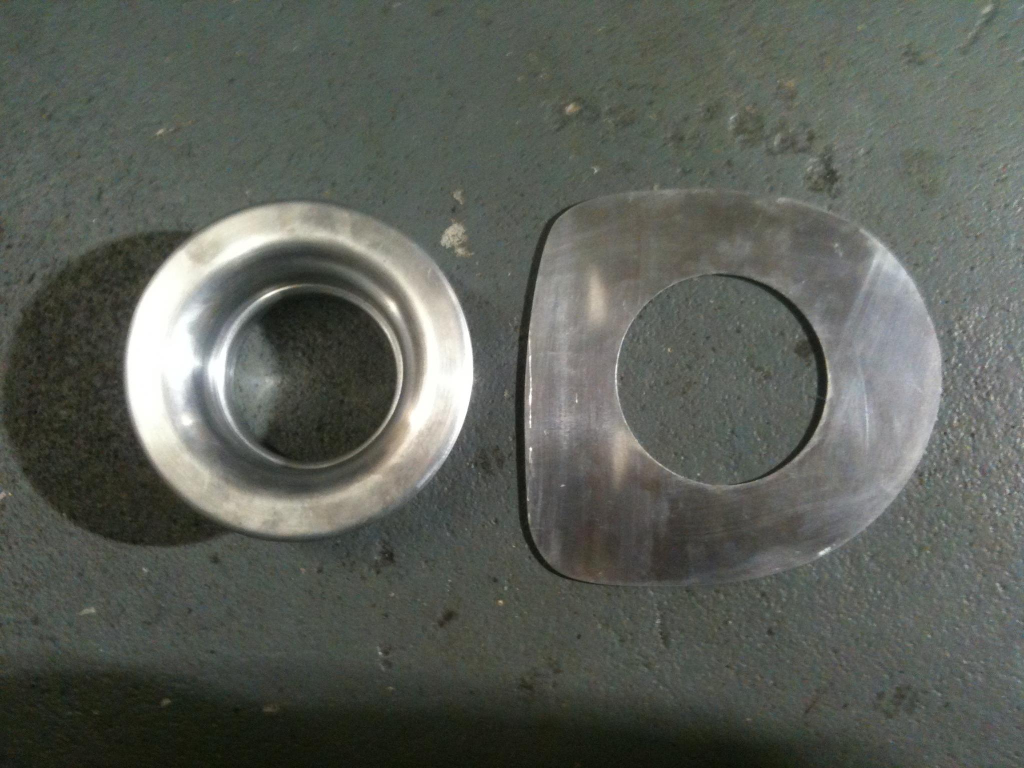

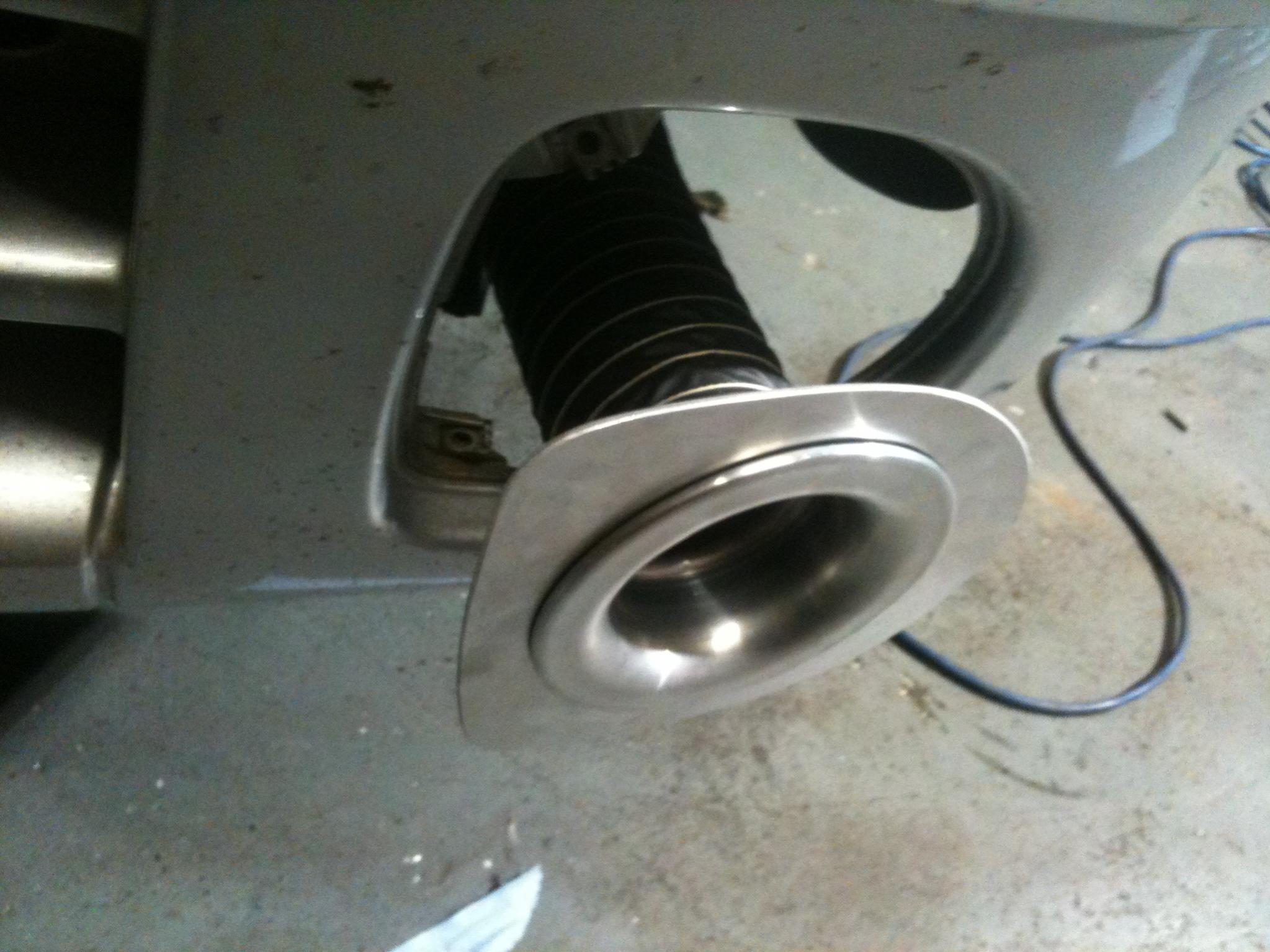

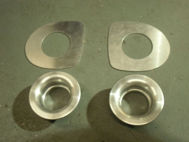

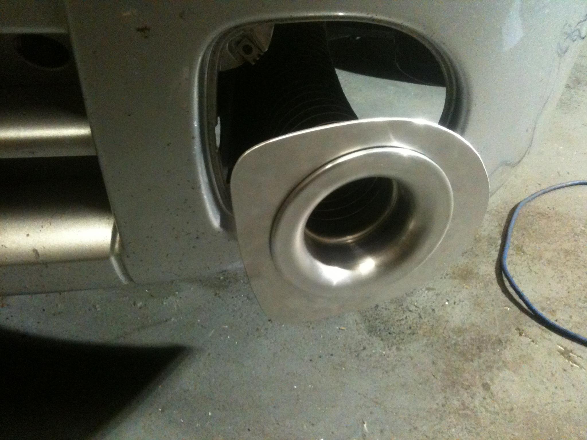

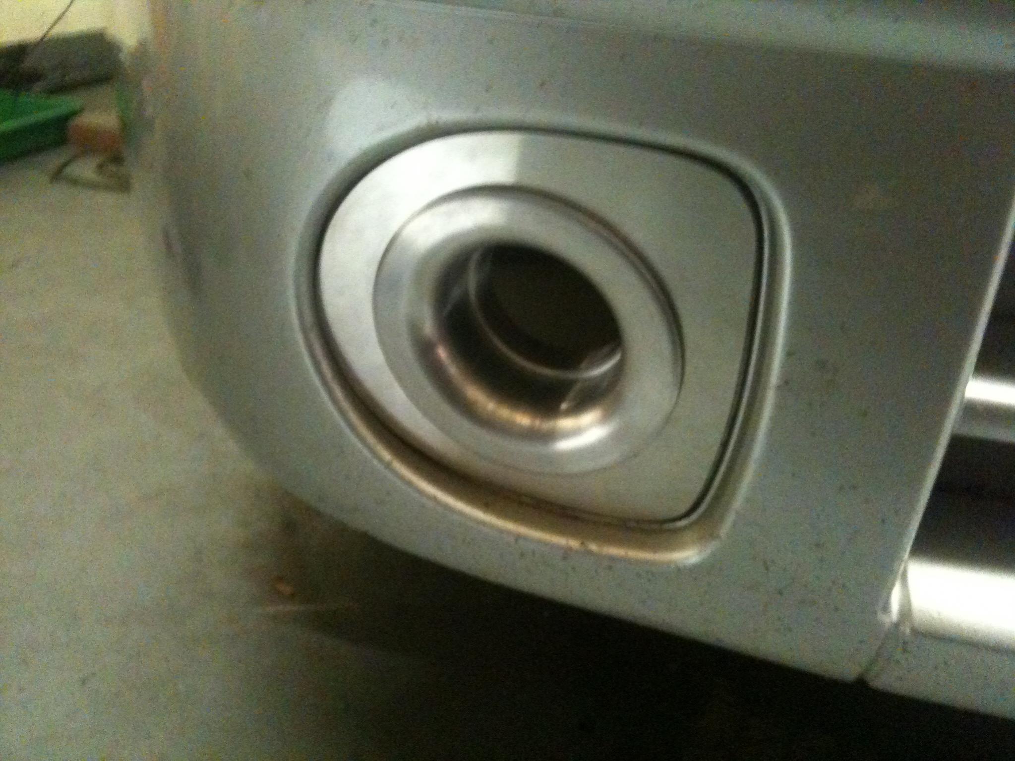

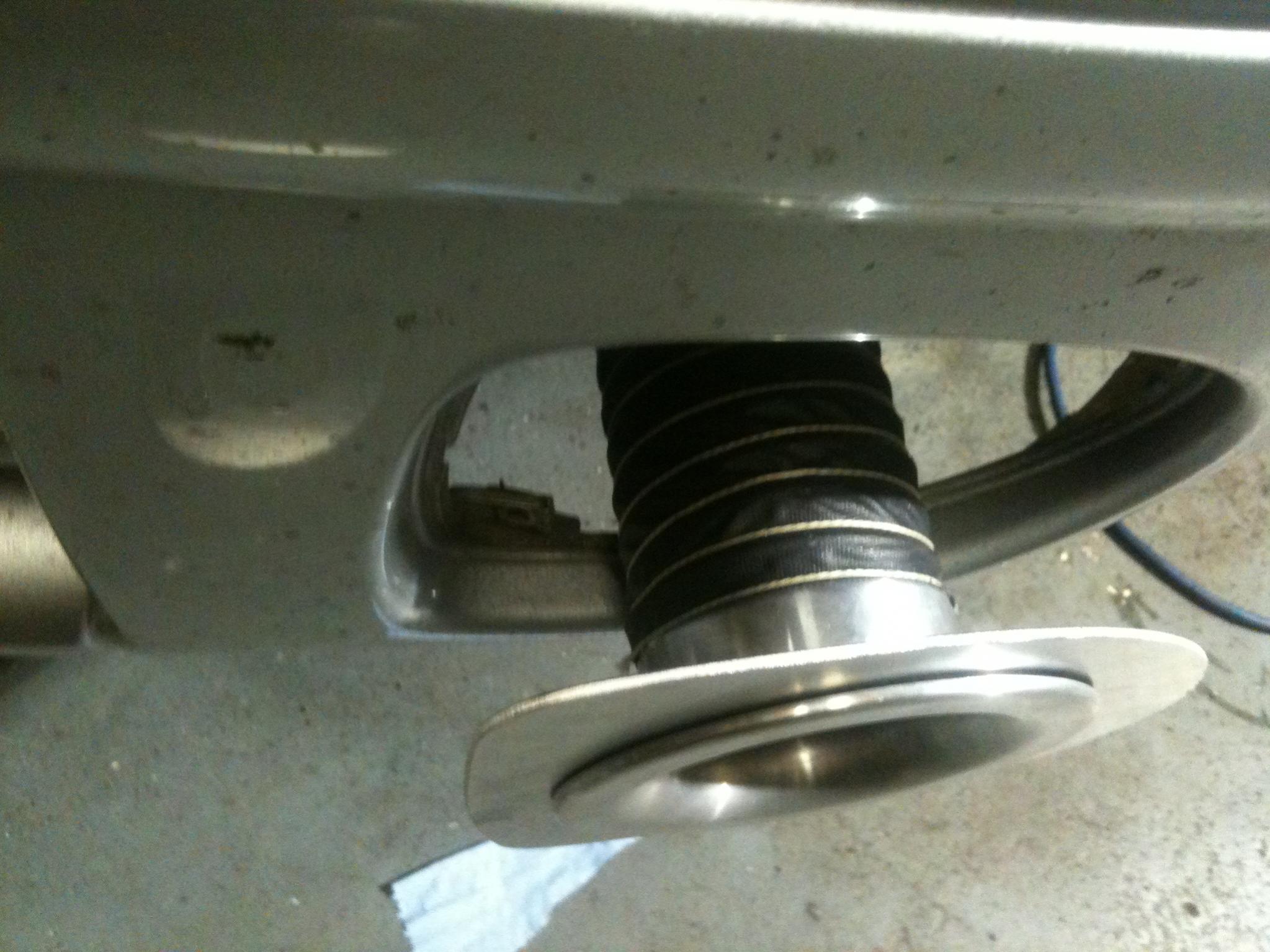

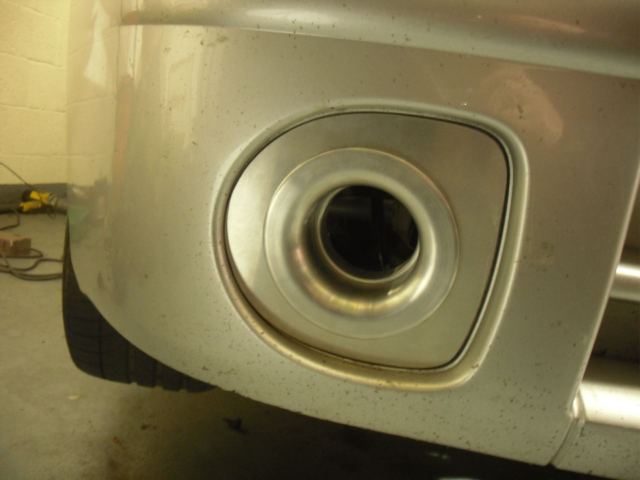

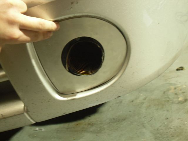

So i got to doing the CAF and i thought right ive seen some nice CAFs made from some guys on here using the existing fog light plastic but i don't really like messing around with cutting out plastic and what not, im not very coordinated with a hacksaw, so here's what i came up with....I sketched out around the existing plastic part of the fog light that holds the light into the bumper, then got myself a sheet of 2mm aluminium ...then used a CNC plasma cutter...
[video=facebook;10150655608971714]http://www.facebook.com/photo.php?v=10150655608971714[/video]
Which leads to this..
Thoughts and opinions welcome, just thought i'd share it with you :)
Cheers Scott.

Good work that. How are the trumpets held in the plates, and how are the plates attached to the car?
Using Clear Silicone Adhesive, from the rear of the plate to the bumper and inbetween the trumpets and the plates. It is extremely strong, waterproof and also can give a little once fully cured. Horrible smell though.
