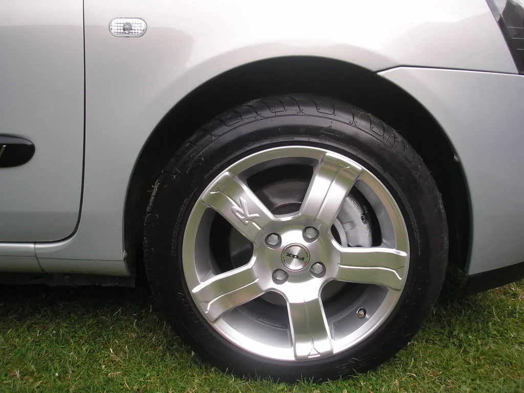

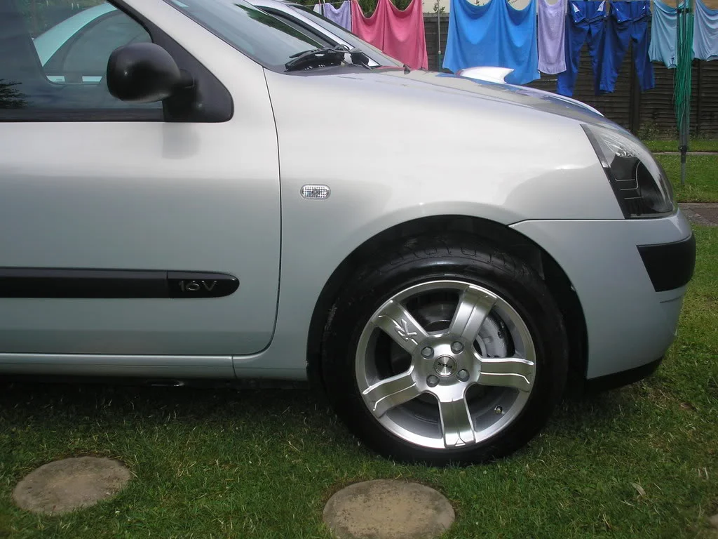

i did my calipers silver 2 weeks ago. used hammerite smooth silver and gave it two coats, looks brill imo. also done the rear drums black, some pics mate...
  PH2 172
Is that silver to me that looks abit plane might be just cuz ur car is silver anyone got any pics of sports with anthracite wheels and silver calipers otha pics of otha colours would be good to
