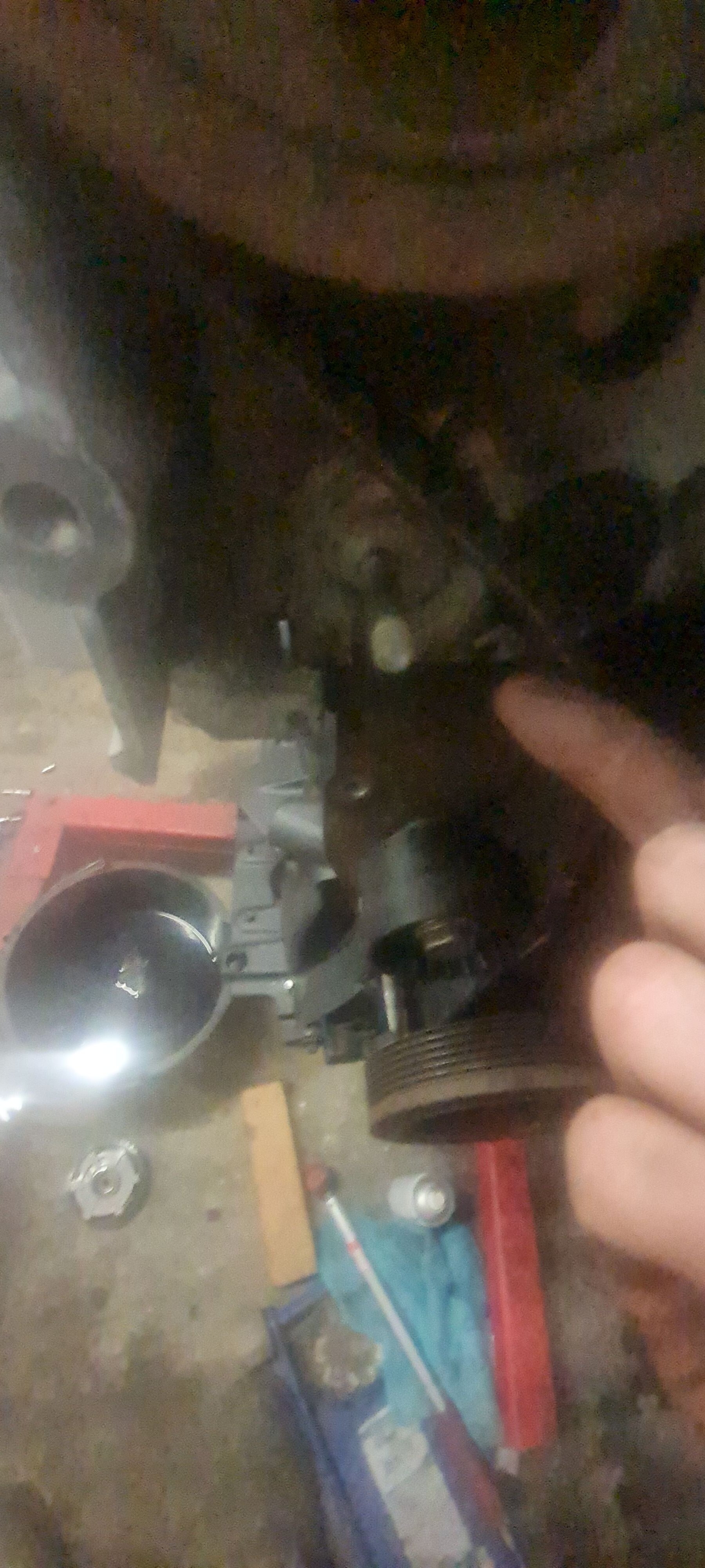

The stud that holds the tensioner on has now snapped, was torquing up to 28nm and the stud just went ping, I imagine the torque wrench I've borrowed is to blame as it certainly felt more than what 28nm should. Here's me thinking borrowing a digital one would make life easier...
Apologies for the awful picture, the stud snapped, I threw all my tools down, locked up and went home in a strop.
Stud extractor and wind it out, then fit a new one.

Get some heat on that first if you can. I would use two nuts back to back then unscrew it.
Any clue on what size the stud is, thread and length - lots of cars use exhaust studs which look about that size

No idea on the stud size, all I could tell you is it's a 13mm bolt that goes on it, didn't even look at the stud, just chucked my toys out the pram and stomped off home 🤭

Would there be any harm in re-tapping the hole once the stud is out and using a long bolt instead?
Not sure I like the idea of that really. It'll be a stud for a reason.
