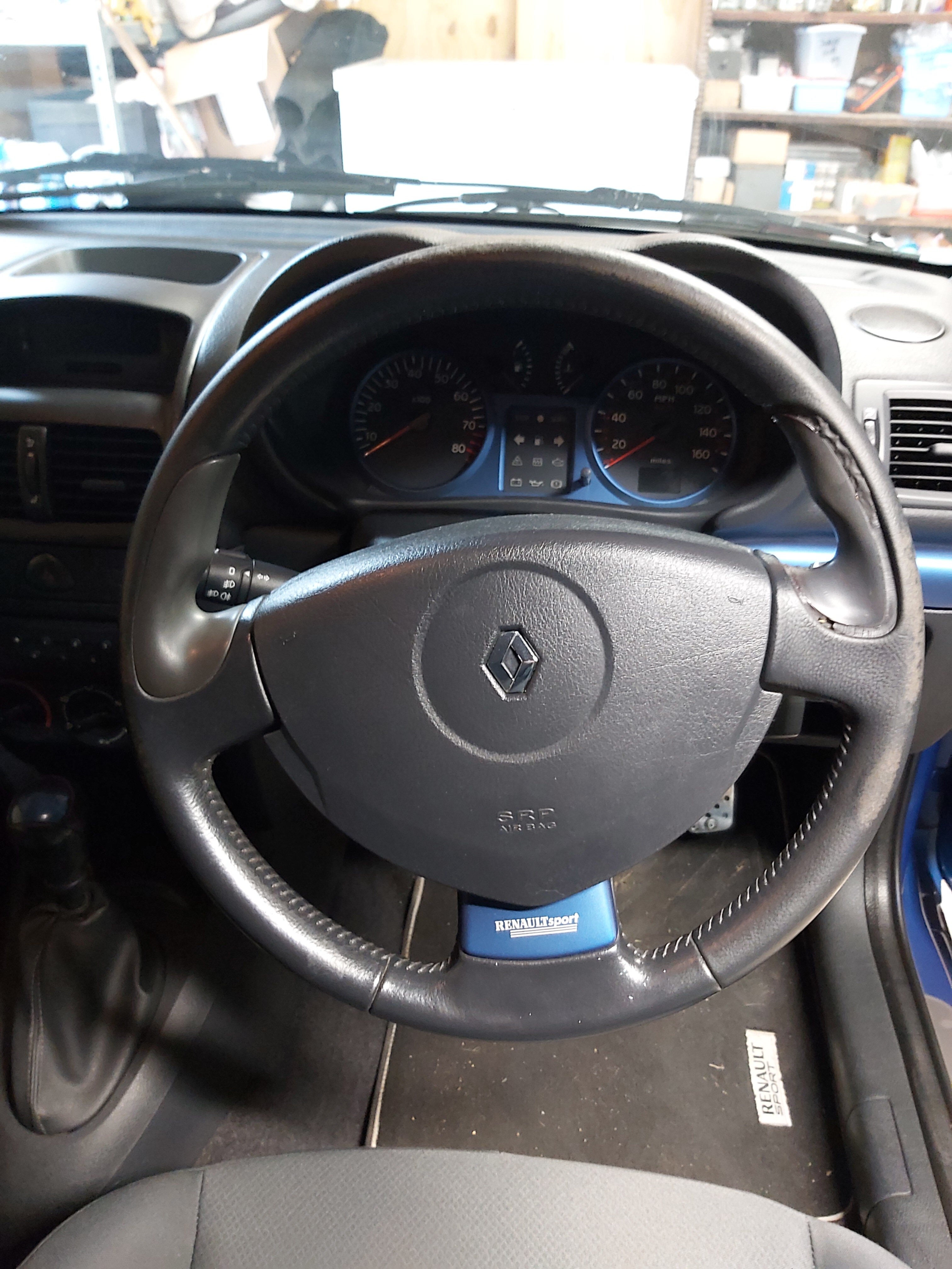

This is the current wheel, and as you can see it's well past its sell by date 😀

It's a very simple removal. Just remember to disconnect the battery for 20 minutes. It's a Torx T50 from memory.
Renault's recommendation is to replace the bolt whenever the steering wheel is removed and the part number is 8200697105 Less than a Fiver.

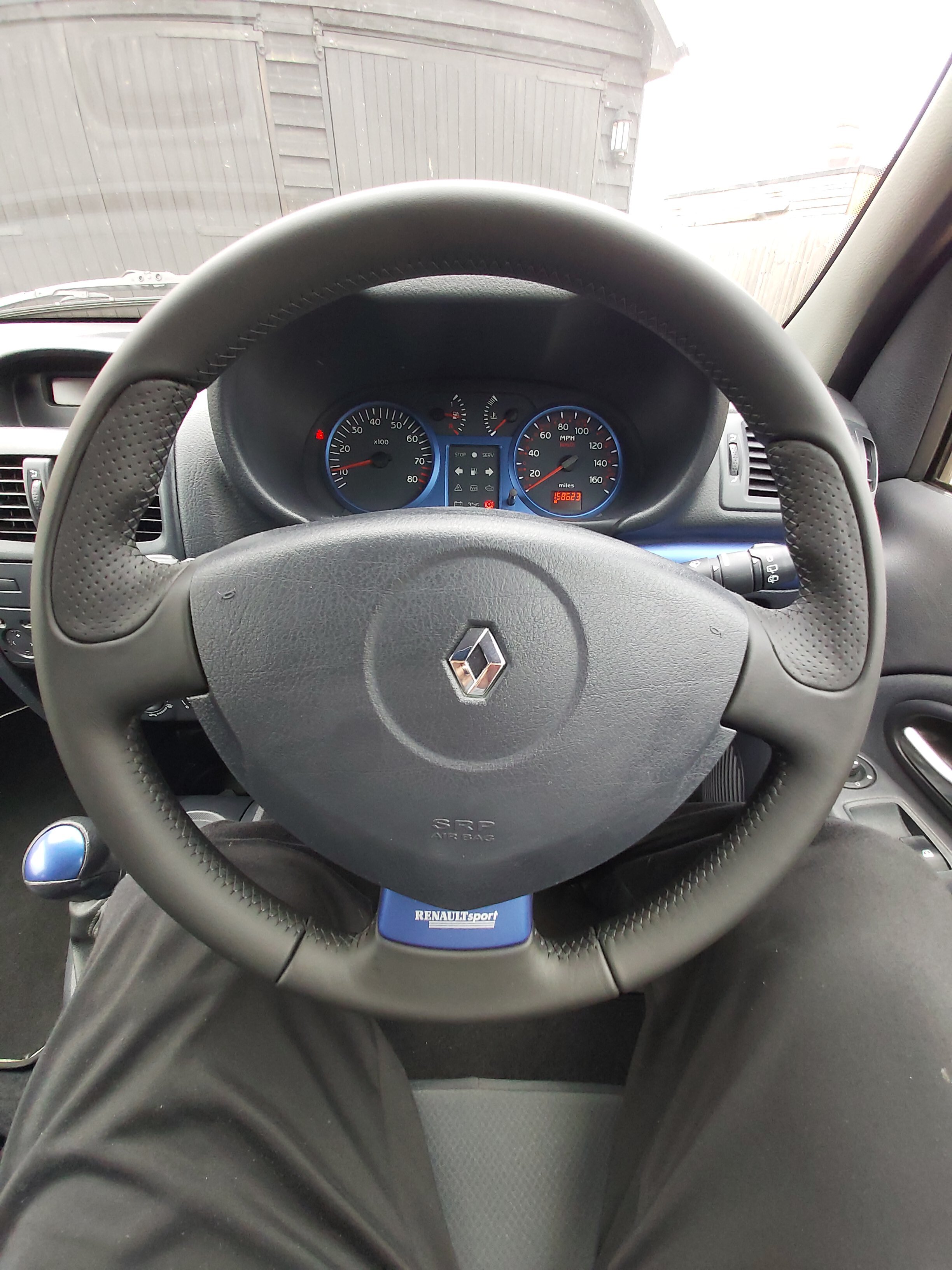

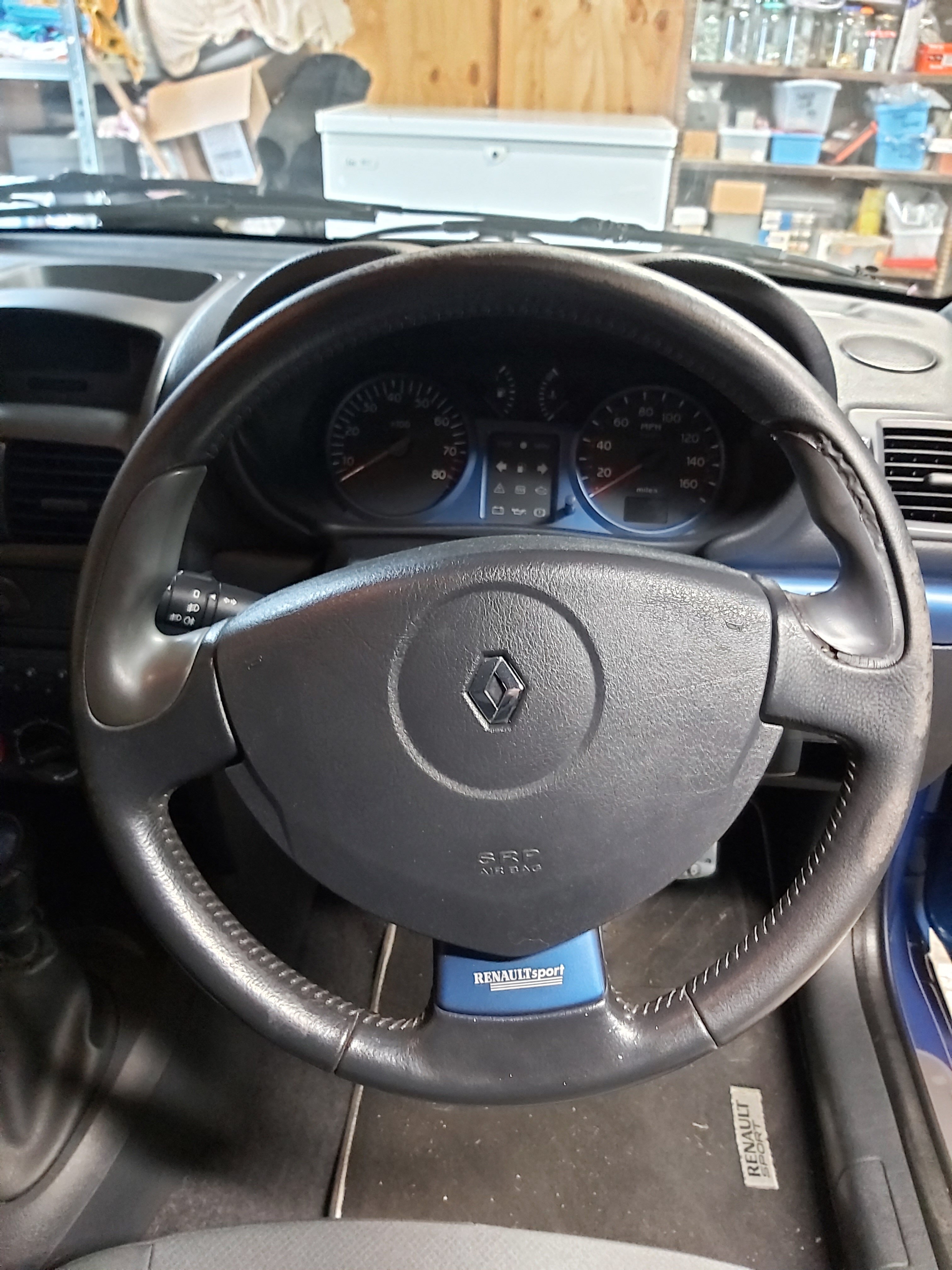

Fitted the new snappy trimmed wheel today and didn't break anything which was a result!
Heres the before and after snaps...
To say I'm pleased is an understatement, the interior is looking so much better. Just need to find some mint front seats and it'll be perfect!

That is stunning. I need one of these - how much is it if you don’t mind me asking ?

It's £150 for a retrim of your existing wheel, I think that includes postage. I paid a little bit more to have one retrimmed that he had in stock so I could keep my original wheel. Worth every penny in my opinion 👍

Does look very good that - the standard wheels in OEM trim look crap in comparison!
