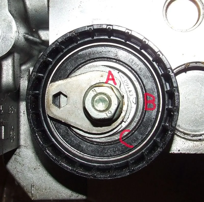

I'm aligning marks A and B:
should it be A & C?
I tried it on A&C and the belt is a lot tighter and the idle has smoothed out a lot! but obviously don't want to run it like this if its too tight
align the small arrow with the small cut out behind the main adjuster, have you got the back of the tensioner aligned with the cut out on the head.
By the way turn adjuster clockwise to adjust, all should align up ok.
i have the notch in the cutout, yeh
but the 'middle' plate seems to be stuck on the lower plate, meaning I can't align B&C
I can align A (using the hex hole) to B (the raised triangle) -or- to C which is the little cut out on the 'middle' plate

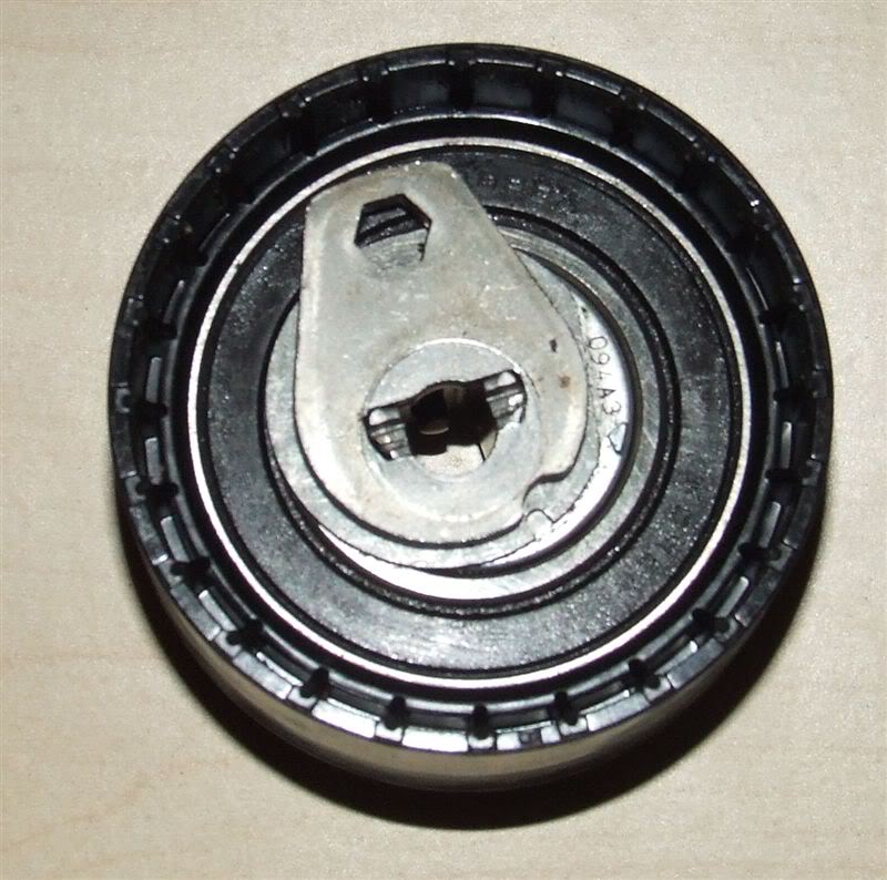

A-B aligned:

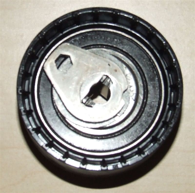

A-C aligned:
initialy the arrrow doesnt move but when the belt gets some tension on it, it mooves all of a sudden
do you move it by rotating the hex hole clockwise a few times?
how can a tensioner be causing this much pain!!
I have the manual - but I'm just getting confused cause those 2 marks arent lining up!
cambelt must need to be tensioned some more i guess
is the nut loose when u are trying to tension it?
do you have the little leg located properly on the back?
if so then must have a dicky tensioner
nut is loose, yeh and the leg is in the slot
i'll swap the tensioner over for a spare i've got
how much play is meant to be in the cambelt eventually? I've got a couple mm play between the 2 cam pulleys
shouldnt have any as the pulleys will turn.
wish you were closer, id come over and have a look some time
maybe i'm just 95% of the way to tensioning it properly... hence the notches have not aligned
means i've been running the cambelt super-lose all these miles :o
maybe you re just not trying hard enough.
you will feel some resistance as you move the tensioner, then all of a suddent it will move and you will see the notches move.
if that makes sense, not easy to explain
i know what you're talking about... but as i've been tensioning it wrong and was just trying the new method, i didn't want to over do anything
luckily i've left the car in bits so i can hopefully just tighten it up some more! :D
