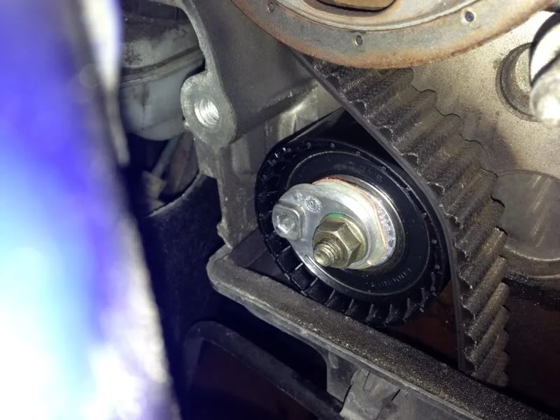

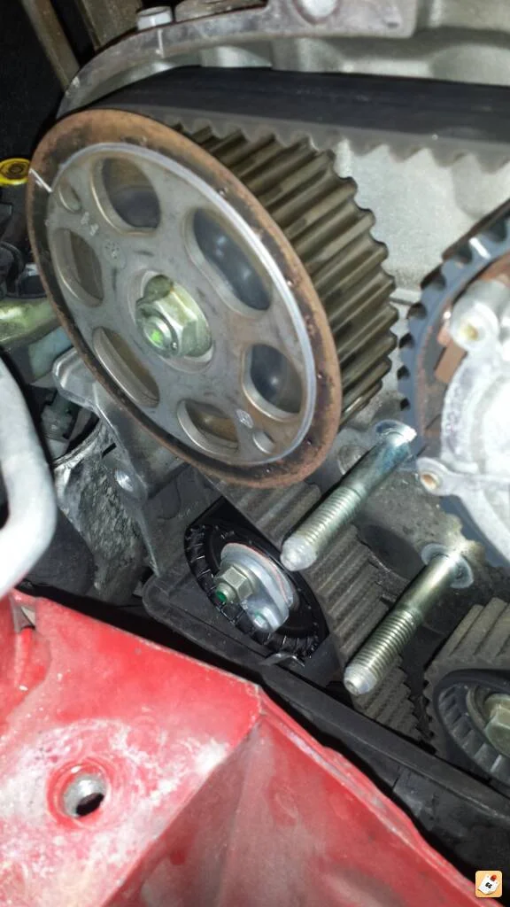

Question about setting the tensioner guys,
How do you know if you have it right?
I ashume that when you set it so that the marks line up and then rotate the pulleys you shouldn't get any movement and the marks should stay aligned?
When you torque the pulleys onto the cam and turn the engine over you will see the tensioner moving as it adjusts the belt tension depending on the action of the valve train?
  Cup In bits
Yes essentially mate, it will change when turning over the engine by hand but it should settle back to the marks or very close to it. The Allen key hole on the tensioner should point at circa 12 o'clock and not be past the centre stud between the inlet and exhaust cam pulleys iirc.
Fred had bother with tensioners running out of travel and it causes a potential clicking/knocking. Anything more than stated and the heads probably been skimmed and your needing a larger tensioner to take the slack.
This is wrong, was on one of my Clio's when I got it.
