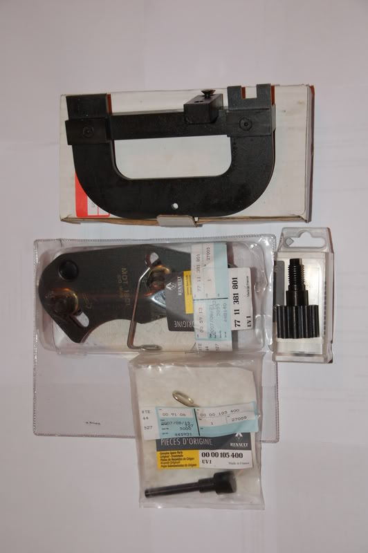

Well my boyfriend is a mechanic and checked the book time seems the same - he didn't say anything about special renault tools tho - what exactly are the special renault tools needed Fred?

Need the cam locking tools
There is some for sale atm actually. I guess your BF has never done a 2.0 clio before?

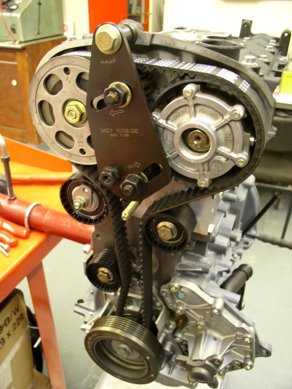

Its nothing special, its fiddly as hell but nothing out of the ordinary. You can't go wrong as long as you've got the locking tools tbh. Took me about 7.5hours to do mine (first one i've done) that was for a full cambelt and auxbelt change along with all the idlers and tensioners.
The biggest problem is the lack of space, ratchet and cranked spanners are a must have as they're all you'll get in.
done my belts this morning 182 with aircon did both belt kits inc all tensioners etc it took me 5 hrs on the floor in my garage, as said a bit tricky getting your hands into places etc but easy job to do, you just need cam lockin tools and crank lock tool,
