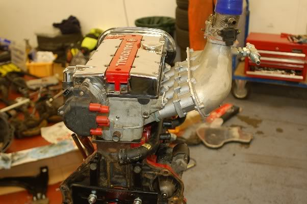

With the supercharger providing such a consistant amount of boost at any given RPM, its actually far simple to map multithrottle on an ITB setup with a charger than it is with a turbo.
Wont really effect your peak power by much, as you say it will just allow you to hit the same thing at a psi or two less (efficiency is good :) ), but can help with throttle response slightly.
If you want the efficiency gains with the complexity then just remove the throttle plates and fit a shared plenum with a single throttle, this is how I have done similar in the past:
you wont get the gains in throttle response, but like I said they will be tiny anyway so not really losing much.

Sell itbs, buy a supercharger or turbo set up. I have had my 438s removed from my supercharged engine due to the engine being at its very limits for standard internals. Will be going back in when the engine is forged.
  182/RS2/ Turbo/Mk1
Would an rs2 inlet not be better suited to this? As its simpler.
Excuse me if im wrong.
RS2 inlet would be ideal for a boost application, but you would need to alter the fittings in it potentially as they are push fit for sensors.
