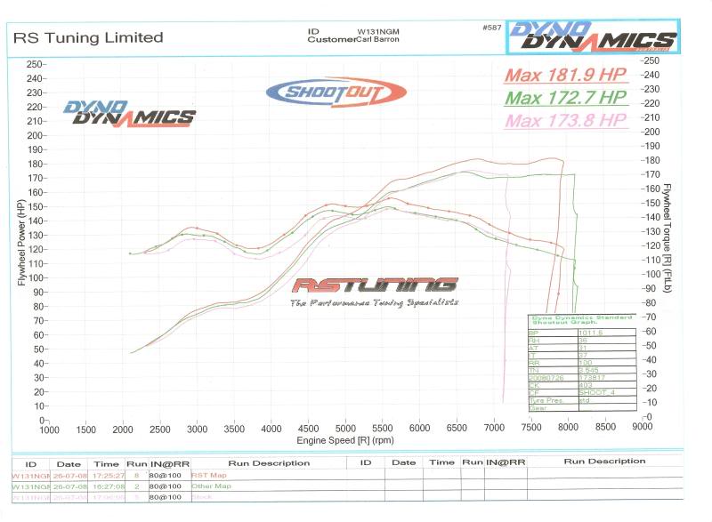

just looking over my figures from before i had any work done to my car to now, i have lost a little torque low down. however
peak bhp before 156.0 after 176.2
@ 5500rpm 145 plays 162
@ 6500rpm 156 plays 173
@ 7250rpm (old limiter) 150 plays 172
the cams maintain over 170 bhp to the higher limit of 7800rpm, so from 5500 rpm the car makes near enough 20bhp more over a 2300 rpm range
the 5k "kick" doesn't exist anymore, just smooth
also @ 7000 rpm the car is making 19lb/ft more
torque peak before is 140lb/ft after 155lb/ft
i would like to state for the rolling road police that different rollers cannot be compared, only the same set came be used for "before and after" results
to clarify my car has ITG panel filter, schricks, decat, matched inlets and remap

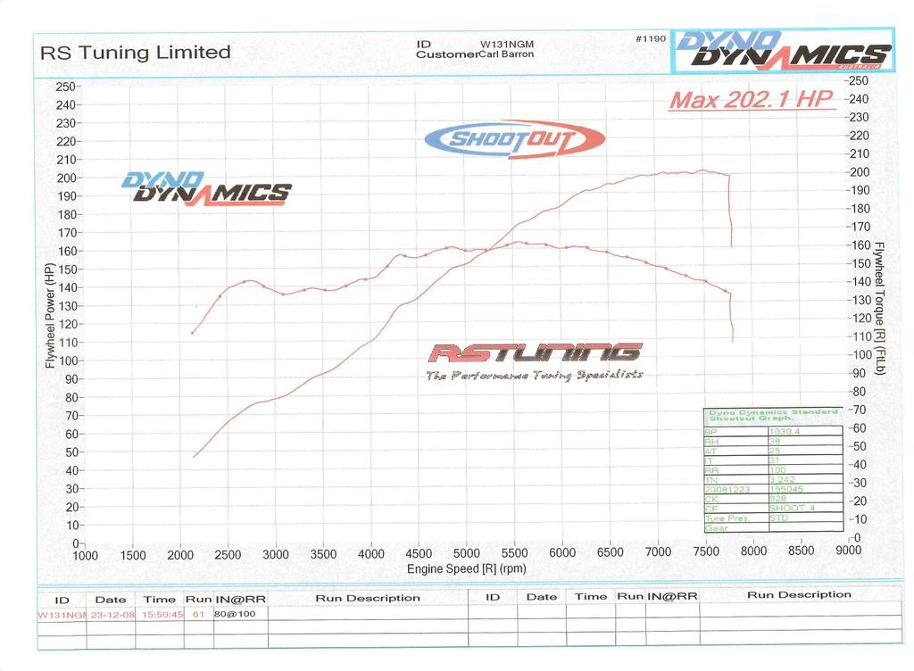

  B/G 182 + PH1 Track
Catcams 420s
matched inlets
Powerflow SS exhaust + decat
Produced this graph at RStuning on our PH1 (PH1s are quicker :p) check the temp as well. :D
And our ITBs produced
