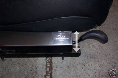

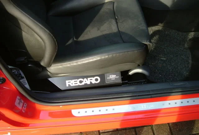

Can a Trophy or Recaro 182 owner please measure...
Red Cup
Car  Focus RS
The distance as shown by the arrow in this photo?
Basically the height of the subframe - i.e. the distance between the seat slide runner and the plastic seat base.
Once I have the measurement I'll explain why I need it. ;)
Thanks! :D
Erm... I'm not sure how that helps? I've obviously seen those as the photo comes from that auction.
If it's a roundabout way of suggesting I ask the seller to get the tape measure out, I've already asked but I thought I'd get a better response on here. :)
Distance between top of runner to base of seat = 90mm +/-0.2

Its 10mm lower than std from memory.
Pain in the arse running all rnd the house for a ruler...lol:approve:
Cheers for that Dan, much appreciated! :)

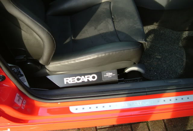

After fitting they seemed noticeably lower, more so than the 10mm in the option 182 and Trophy.

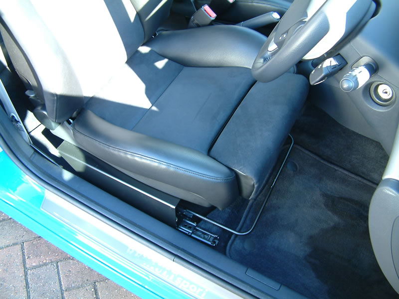

I noticed the subframes Renault use are different to the Recaro ones I have. Mine measure 80mm which explains not only why they feel so much lower but also why the OEM adjuster doesn't fit. You can see the difference in shape in the pic below:
I'm pretty chuffed after finding that out. 20mm might not sound much but it makes the world of difference over the standard items. Doing it aftermarket means I get to keep the leather in the rear too.

Identical to the ones Renault use. It's rare for a manufacturer not to spec any changes to the trim, but Renault didn't.
I got them from http://www.capitalseating.co.uk/ I was fortunate to pay a fair whack less than retail as I was able to offer them advertisting on my site, but they are less than Recaro's RRP from there anyway.

So the Recaro ones are 10mm lower than the OEM recaros??
Assuming myself and TrophyDan are measuring the same place, yes. I wouldn't advise anyone to go out and replace their Renault subframes with Recaro ones just yet! (They are £114 a side)

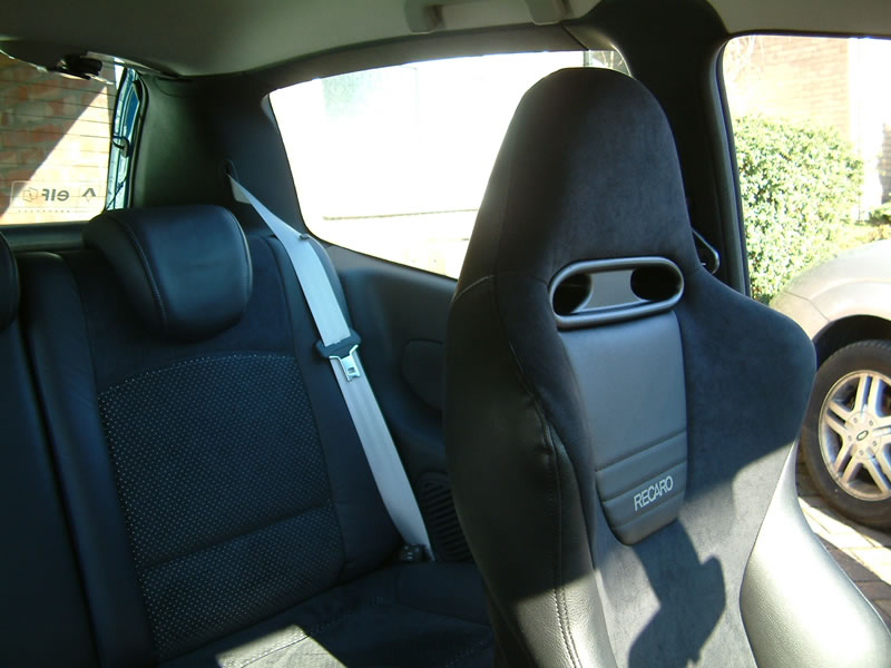

I've not got any pics that show the rears sorry, but they are a pretty good match.

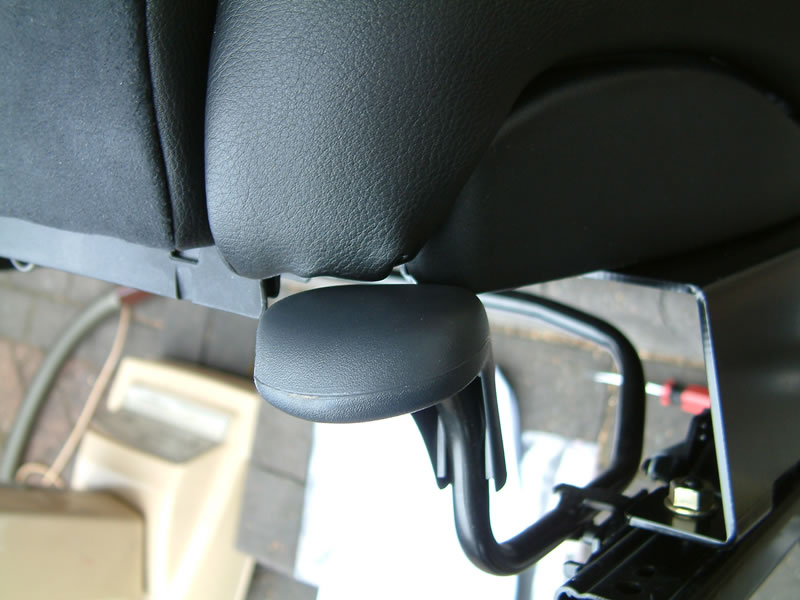

Recaro don't do any other subframes no. I used the Recaro adjuster. It doesn't look factory but I'd rather have the lower positioning. People will twig they are not factory fit when they see the rears anyhow.

Any pictures of them fitted with the recaro adjuster?

Yeah, the subframes Renault use look to be unique to them.
I'll get a load of pics as soon as I can.
I have the standard Renault Recaro Subframes and am looking to adjust the height of them at the moment as i still find them too high if you want to sit normally in them. Im only 6'2", but i dont like sitting with my hair too near the roof! So would be very interested in knowing how much lower these ones are, but £114 a side sounds a bit steep, anyone got any cheaper options?
I wondered if anyone would ever measure the gap and notice they are 20mm lower. There is a reason for it.;)
