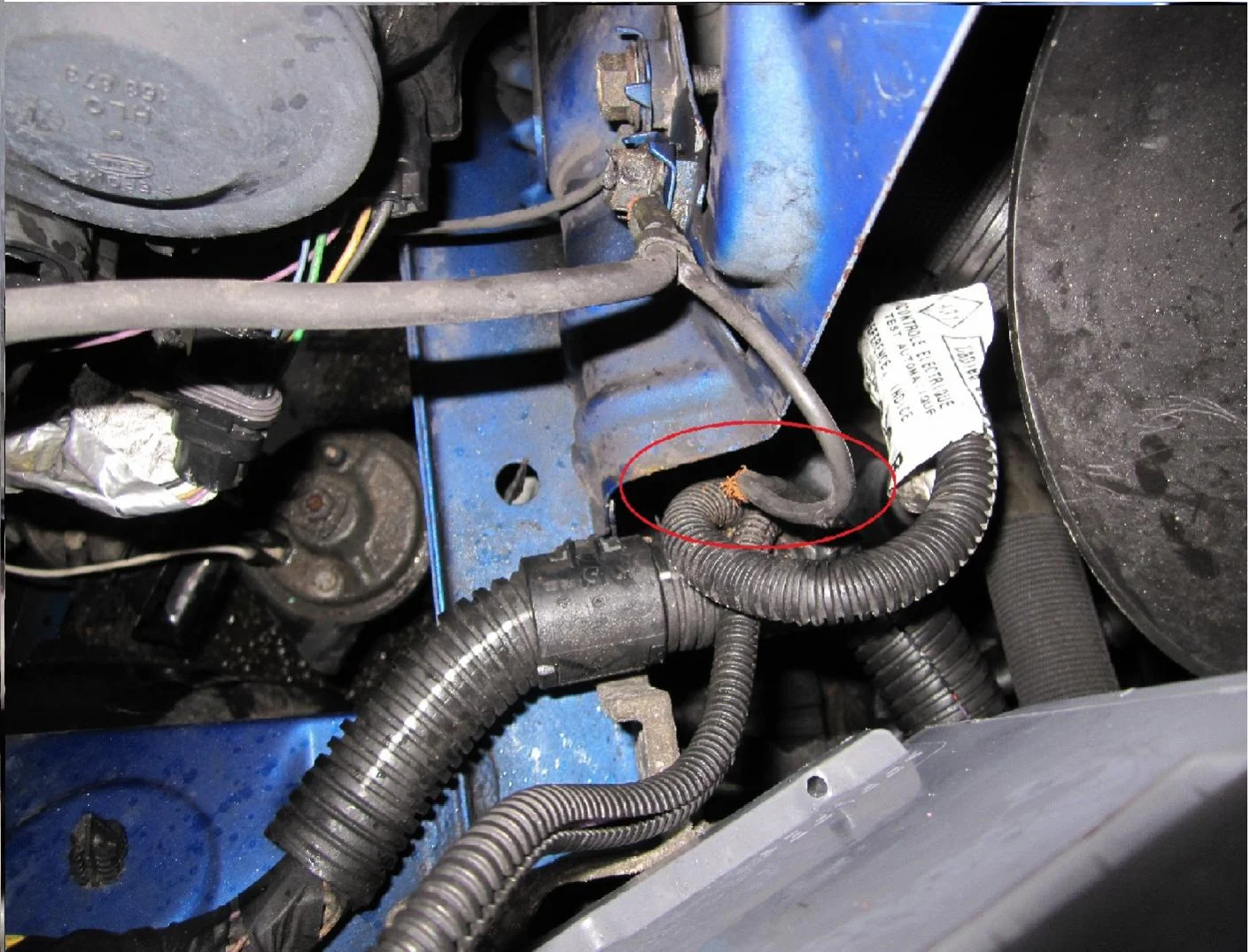

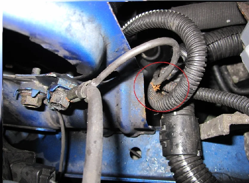

Think I may have found the problem -
As you can see above the cable coming from the earth has frayed, looks as though it has been rubbing on the metal. Does anyone know what this cable does? and how easy it is to repair?
  ph2 Clio 172
Just follow the cable to see where it leads, it must be your problem though, a repair would involve a new earth wire of the same gauge, if theres enough cable there to play with you could cut the cable and strech it to fit to the orginal position.
I have got what I need to repair it mate just finding the time to sort it out now, Hopefully will have chance tomorrow afternoon. I will report back and let you know
