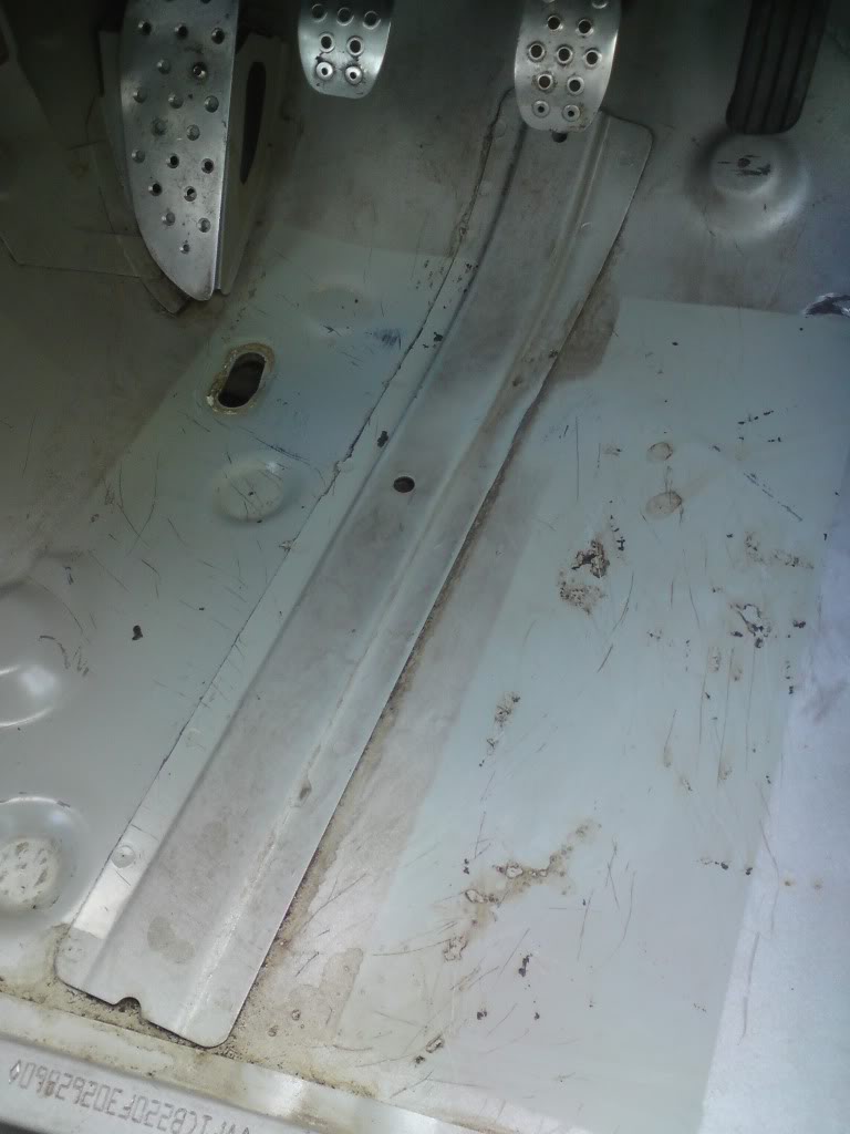

This little strip of metal is quite annoying and i want to know if i can get rid of it as i'm having a full weld in cage. How can i get it off? Do you sort of drill the spot welds a little bit with a big drill piece?
Drill the spot welds out yeah..
I am not sure what is underneath it though / it's purpose?!
Well i'm assuming its for strength but the cage does have 9-11 points that weld to the car and 4 gussets so i'm adding quite a bit of extra support :)
And it doesnt have one on the passengers side!
i think its just add a bit more stiffness in case of an accident, just to stop the floor coming up and forcing ur knees into the dash. I doubt that it would be seriously strong to do that, but, every little helps.
THIS, You'l want a spot weld drill bit to remove it unless you want loads of holes in your floor!
and its most probrably bonded on too, I'd be surprised if it is'nt.
yea a 6mm drill bit, hammer and chisel, and ur good to go.
also, if u get a piece of sand paper and rub it down a wee bit up the edges, it'll help show more of the spotwelds, incase u miss one and feck the floor.
