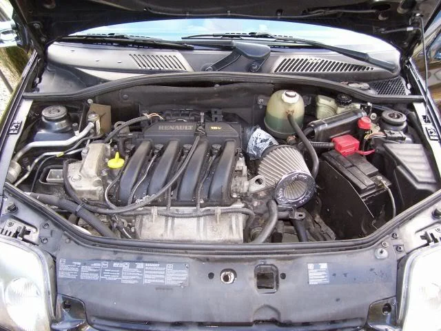

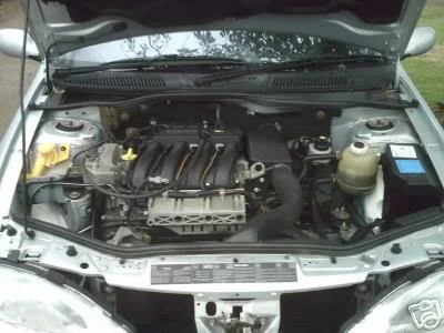

They are the same engine assuming they are both the 16v version, the look very alike. Do you know what year the megane was, They did the megane with the 1.4 8v before 2000 which is a completly different engine, although in theory should still fit.
megane:
Clio
