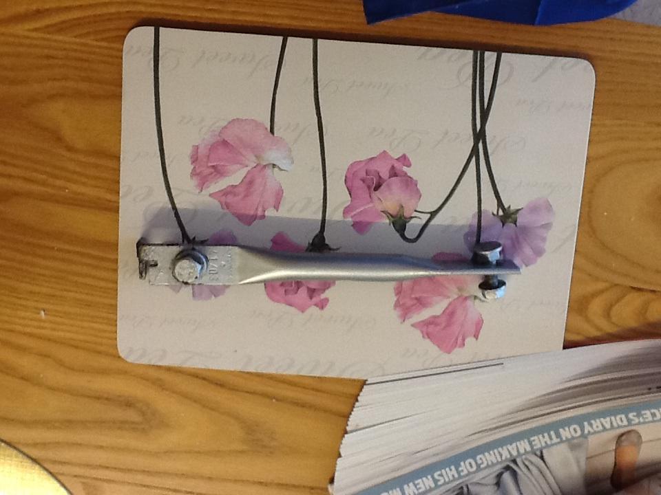

Can someone help me identify and fitment of this ? Part of gear linkage ?
Car  clio 172
I'm just in the middle of finishing off my engine install
can someone guide me ?
think this is part of the gear linkage underneath ?

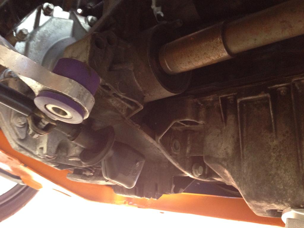

Cheers fred , found a pic after ! Just trying to fit now .
need ramps ! Engine and box need o move to line it up
see the 2 bolts on the right of the pic on the box, 1 is missing? there's a bracket that is held on by those 2 bolts, the bar bolts to that and the the dogbone, its no really needed anyway, so don't worry about it
Ahh cool , I thought there must have been a bracket missing or summit as when I bolted it up it wasn't sitting rite.
will leave it off then Fred if it's not doing a lot .
