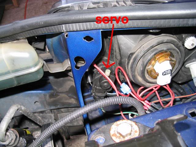

My car has just failed its MOT because one of the lights is set too high even though the servos are as low down as they will go and the adjustment screw is as low as it will go. However I think when I put the double optic lights into my car i have the wrong adjustment servos for the optic lights (I used the old ones from my single style lights). So can someone please have a quick look at the servo on there mk1 172 or mk2ph1 with the double optic lights and tell me if the servo is made by Valeo or Hella.
Its the only thing I can think of as to why it is set too high.

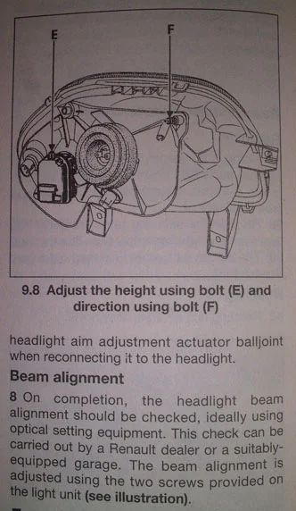

if its too high.....at night put ur lights on a wall ...with your car on level. and adjust them your self....6mm hex key clock wise for up ant clock for down.....my lights are auto matic and always go too low after i have it serviced so i adjusted mine up....not too far though....
